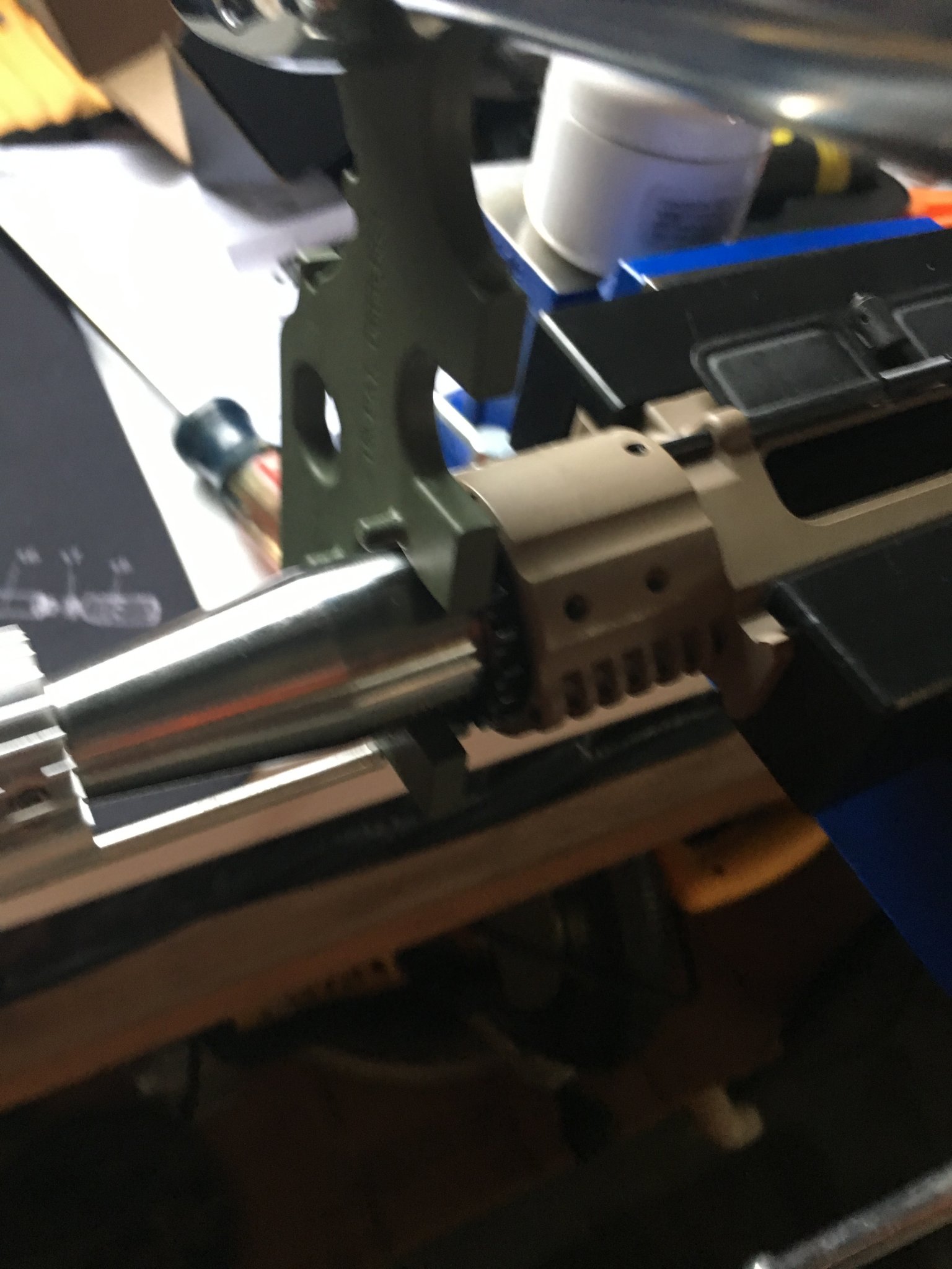

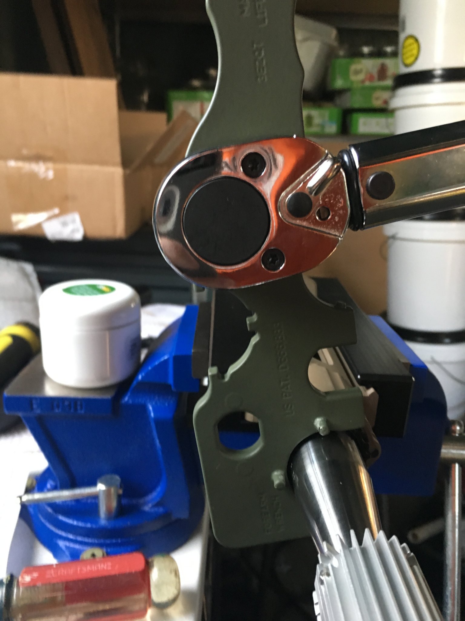

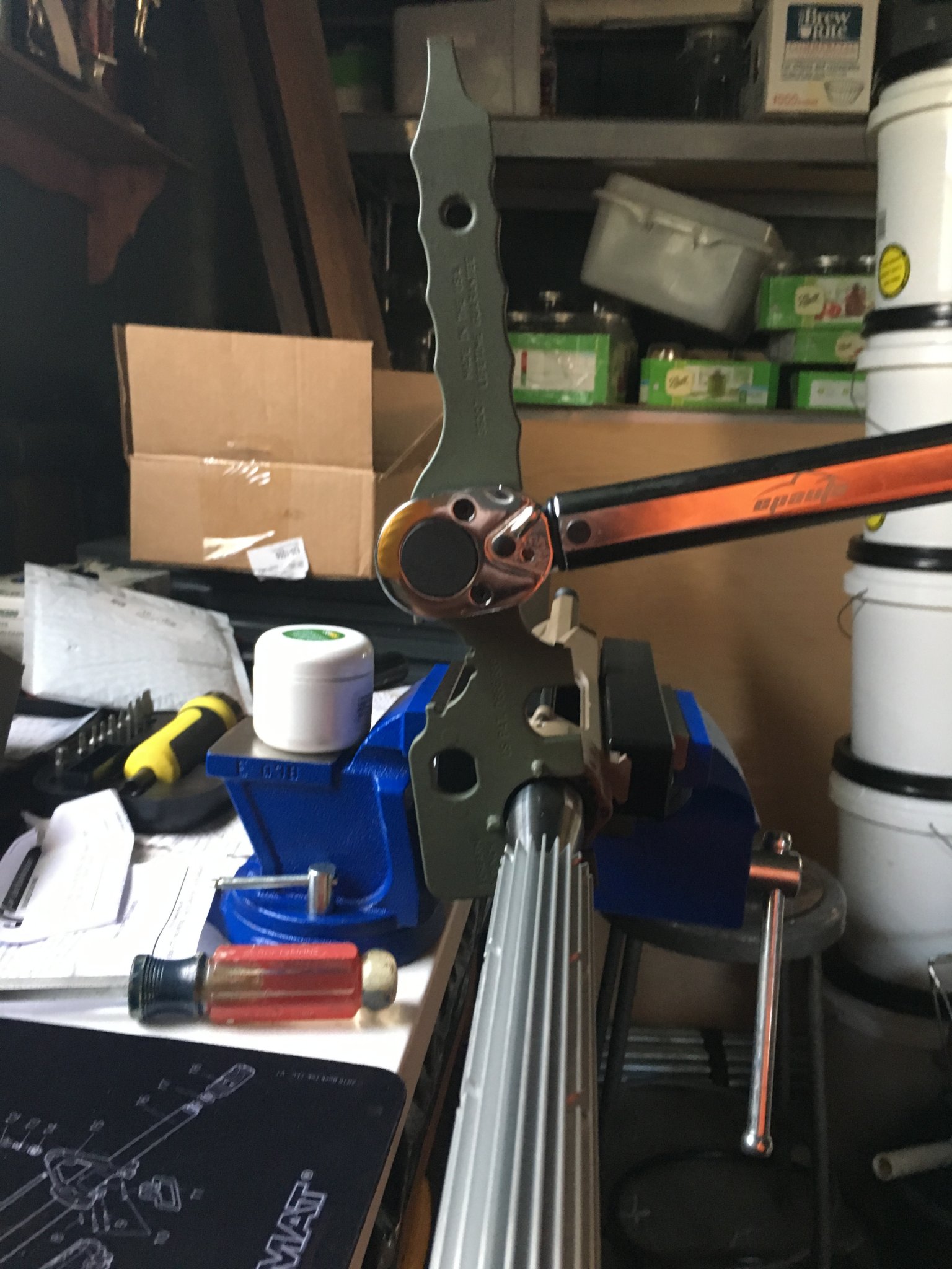

Hi All,
I'm doing my first 308 build. I am building an Aero Precision m5e1 with a JP 18 inch light contour 1:11.25 twist barrel and JP BCG.
The issue I am having is that when I install the barrel hand tight the BCG will go into battery. However, When I torque the barrel nut to 40 ft lbs the BCG will no longer go into battery. I think when I torque it the barrel is rotating just enough to prevent the bolt from going into battery. Has anyone had this problem? If so, do you have a solution. I've never had this with an AR 15.
Thanks

Either way it sounds like the upper is out of spec. I would send the upper back.

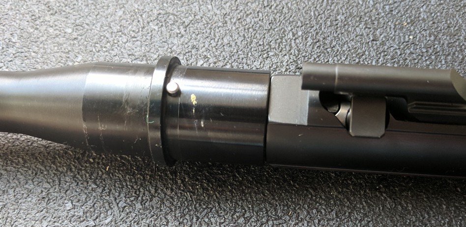

I think the key is probably the barrel extension pin and the slot in the upper.
The clamp you are using seems a bit weird to me. I've used one that clamps the rail but not one that relies on squeezing the receiver top to bottom to resist the torque. I would try just using the rail side and grip it high in the vice with the receiver upside down instead of sideways.
Another thing you can do is get the barrel nut hand tight and the BCG locking up, then create a witness mark between the barrel extension and upper inside the receiver. If torquing the barrel nut moves the extension relative to the receiver, you have to figure out what is letting it do that, that could be the upper or the barrel.
If the barrel extension is not moving, I can't think of what is going wrong without seeing it myself.
That’s a good idea. I’m going to try the witness marks to make sure it is the Barrel turning. Has anyone used Brownells barrel extension torquing tool? Good, bad?
Those are some times called reaction rods, I've never seen it happen but I hear the friction from barrel nut to receiver can cause the barrel extension pin to shear or mess up the receiver, caution is advised with those.
I heard that too. That’s why I haven’t tried one. I’m going to send a picture hand tight and torqued. It almost seems like the barrel extension is just the slightest bit to deep. Like the indexing groove is too deep.
After dialing down I was able to get to get to battery at 37 ft LBs of torque. I think beyond that I’m stressing the receiver. Any thoughts on that?

Your upper is probably fine.
Torque values on that wrench are linear, so when you add an extension and angle (90 degrees and about 3” extension).....37 ft/lb becomes 45 ft/lb.
