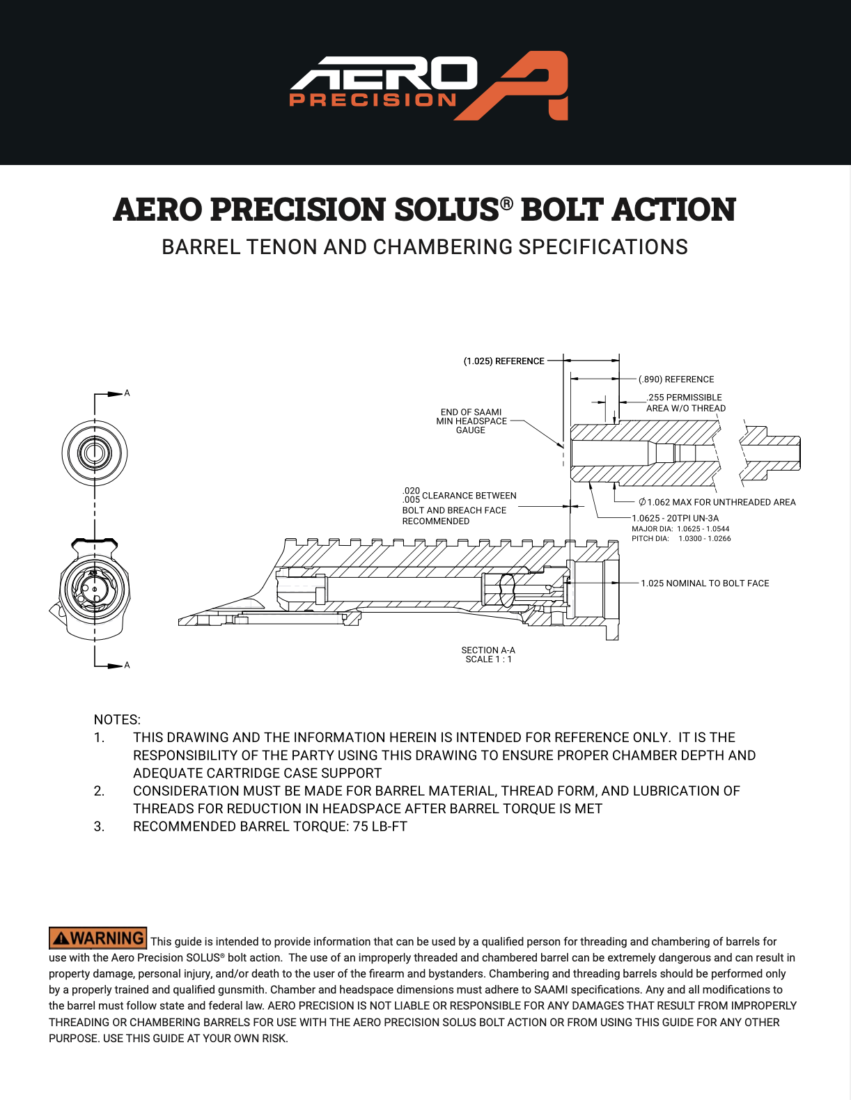

Does this mean that Zermat Origin barrels are a direct “bolt on” to Aero Solus actions?

I keep getting the question ‘what is the shank diameter?’ Anyone know?
I won’t be using a barrel nut.
I’m going to be using a WTO switch lug system.

Just to specify, most companies are now offering Aero Solus prefits, and not just Zermatt Origin. Not sure if there is any difference, but I'd tell the person building the barrel that it's an Aero Solus, and not a Zermatt Origin.
Here is what you need to give them, if you're having a smith custom build you a Solus prefit barrel, and they are not sure the dimensions... This is straight from Aero Precision...

But i am running an orgin proof prefit on my solus and checked headspace and was good to go
Reactions: FuhQ
I was told they did it just to simplify it because people arnt always the brightest
Yep, I know they're the same, because Aero said they were the same, but sometimes it's best to just verify the specs with the barrel builder just incase they have some weird specs that aren't 100% accurate.
