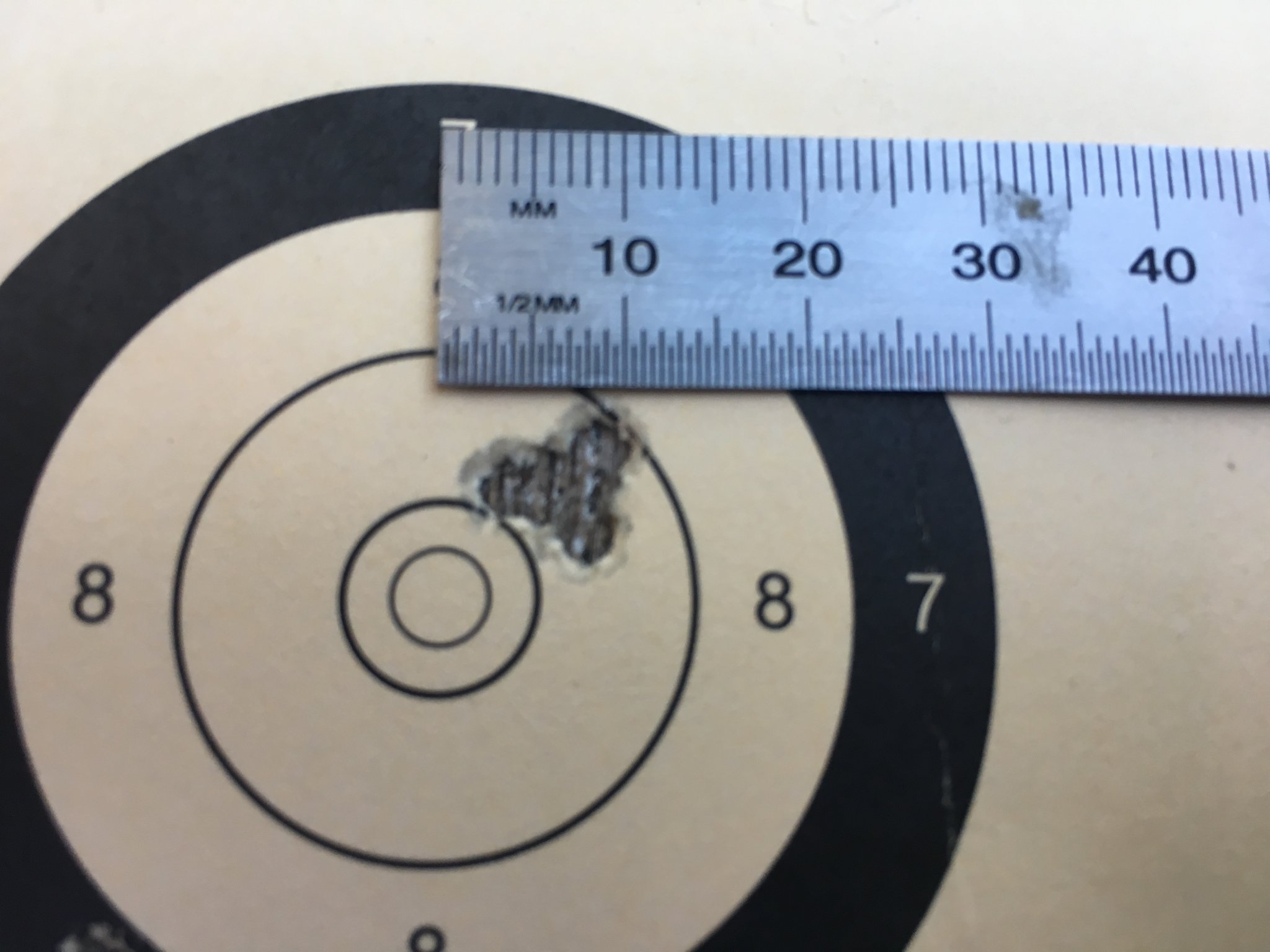

Well i love my CZ455 Tacticool Now but man did it stick when i got it
My biggest thing is if i had to pay for all the work i done myself (trigger job , Pillars , Bedding , floating , Mloc rail . QD cups , ) would i wish i just got a better rifle ,,, yes i would
But for me half the fun was taking a dog and making it shoot 5 shooters at 50 like this

So, that is the factory barrel? Great shooting...
Sure is ,, took me along time and alot of work to get it to there
Like 5lbs per inch difference in the action screws makes a hell of a difference
the barrel retaining screws need to be the same i go up to 45 inch pounds in , 15,25,35,45 alternating to keep it square
but yes its shoots amazing now with cheap ammo thats a federal hunter match group at 50
