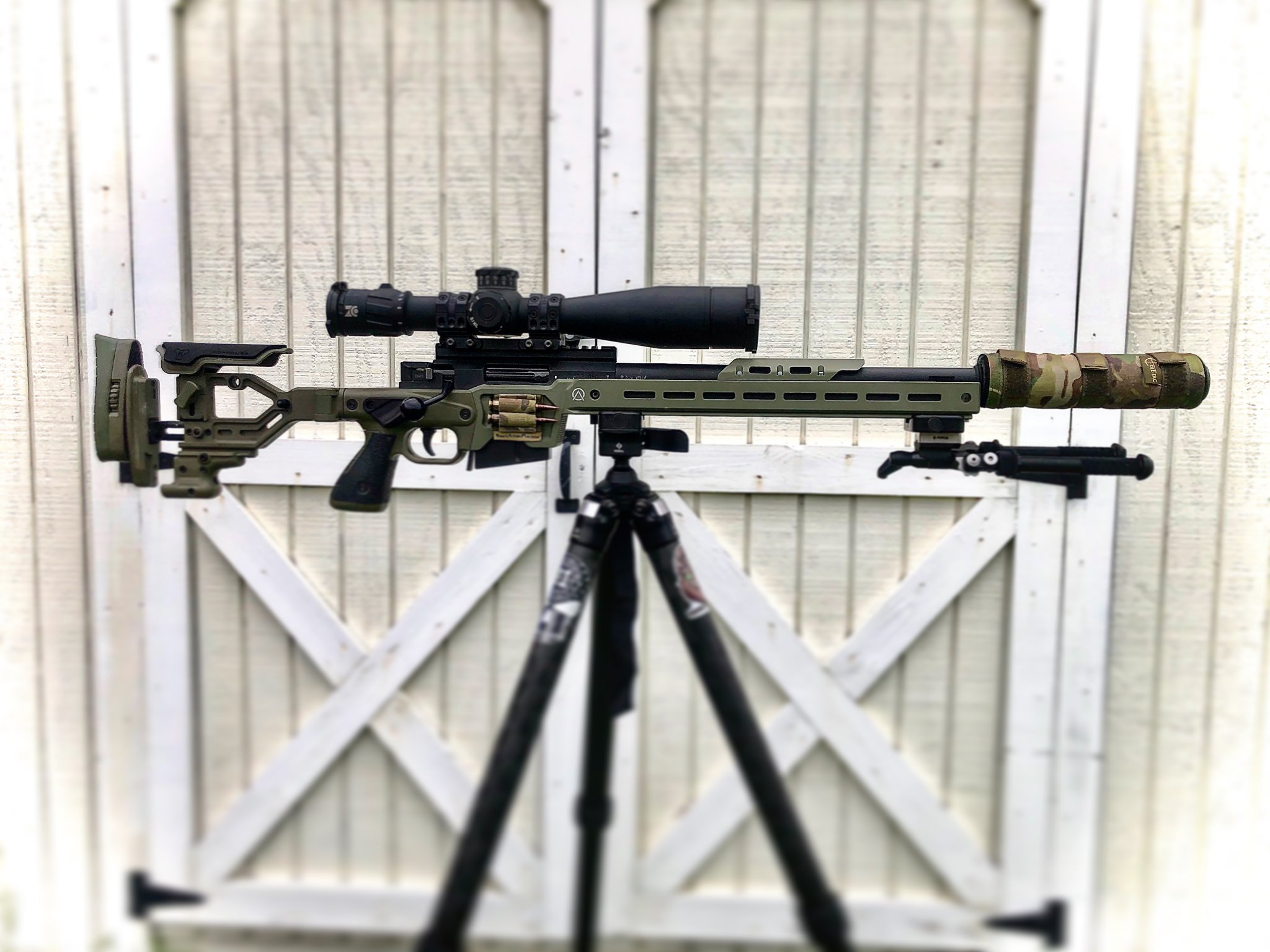

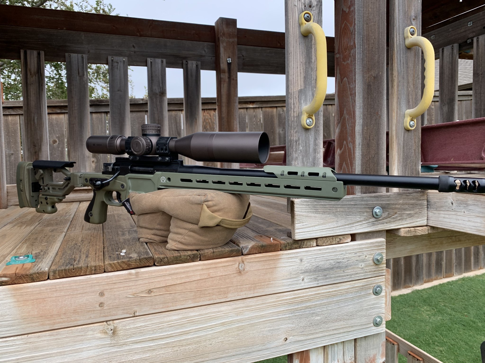

I have my balance point about 3” in front of the magazine well, which is about perfect for using Game Changer type bags. That’s with the prototype chassis with the 1.5# internal weight and one MDT external weight up front. I think with the production chassis and 2# internal weight it’ll be just about perfect.
This has been my experience with most rifles as well. When it’s balanced within an inch or so from mag well, once you put it in a bag is rear heavy.
3” in front seems like a lot without a bag. Once a bag is in play it’s just about perfect.

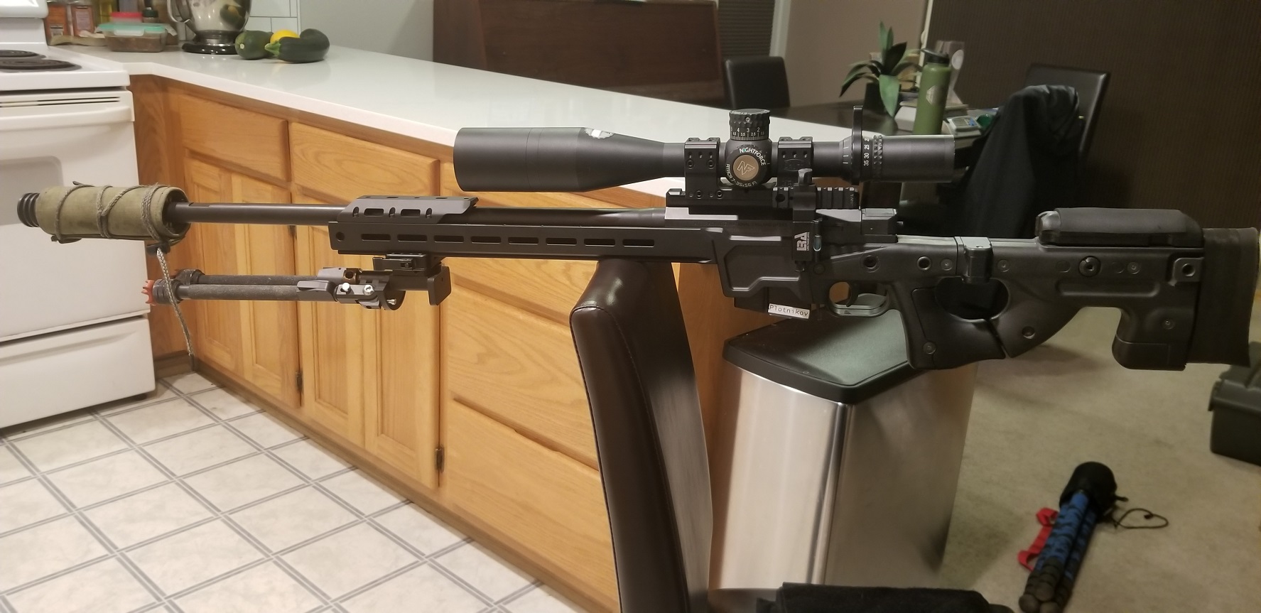

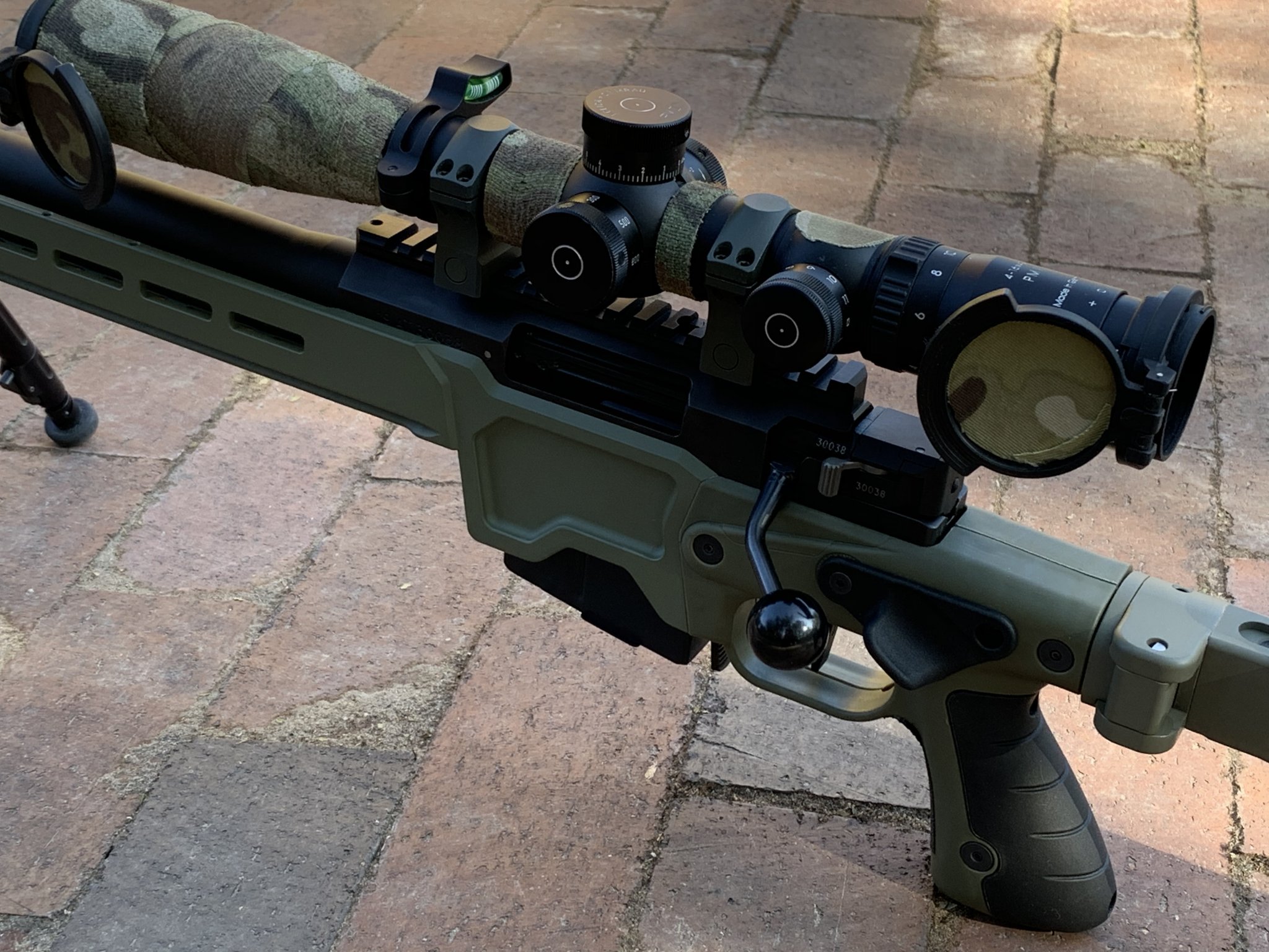

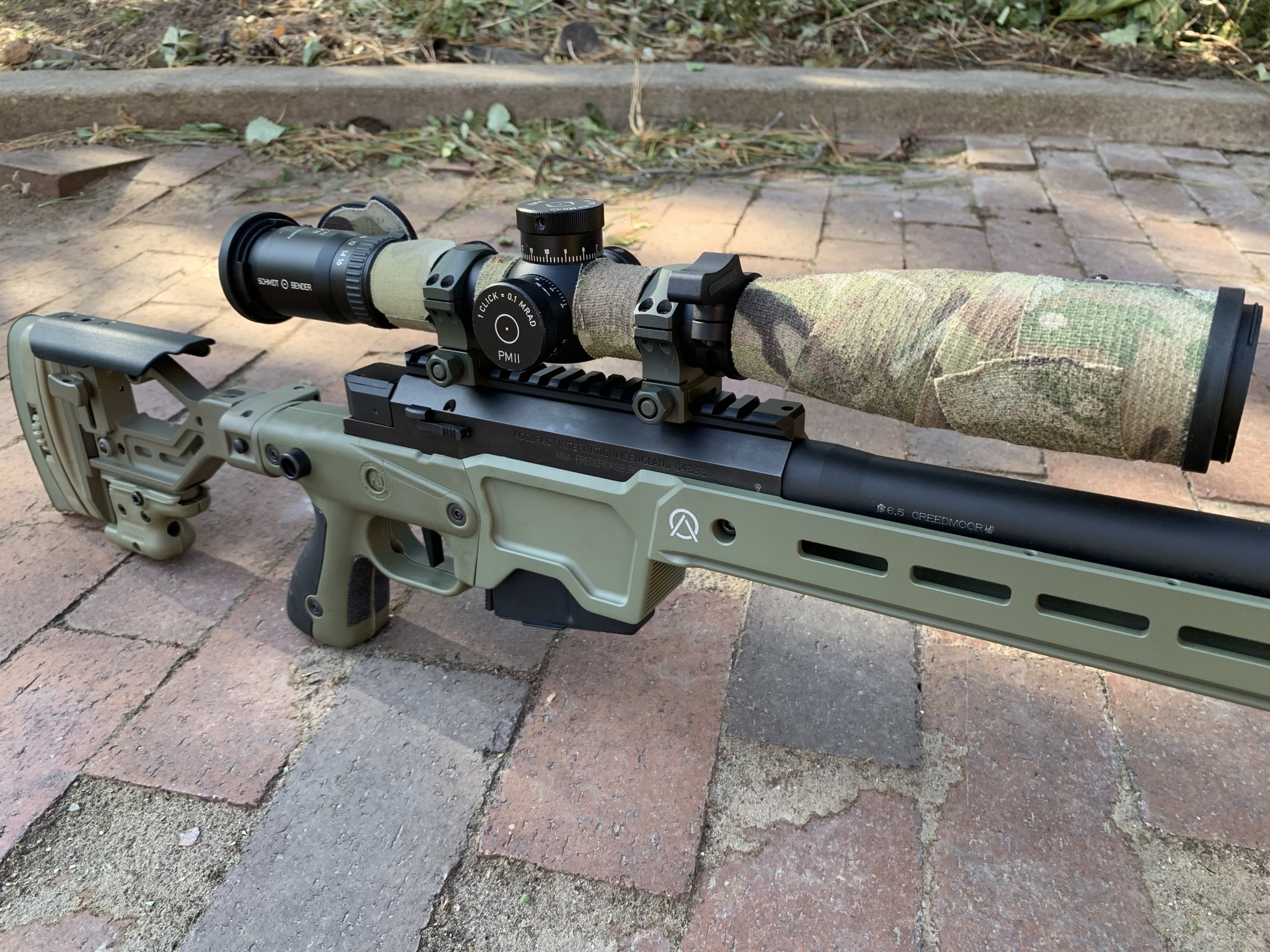

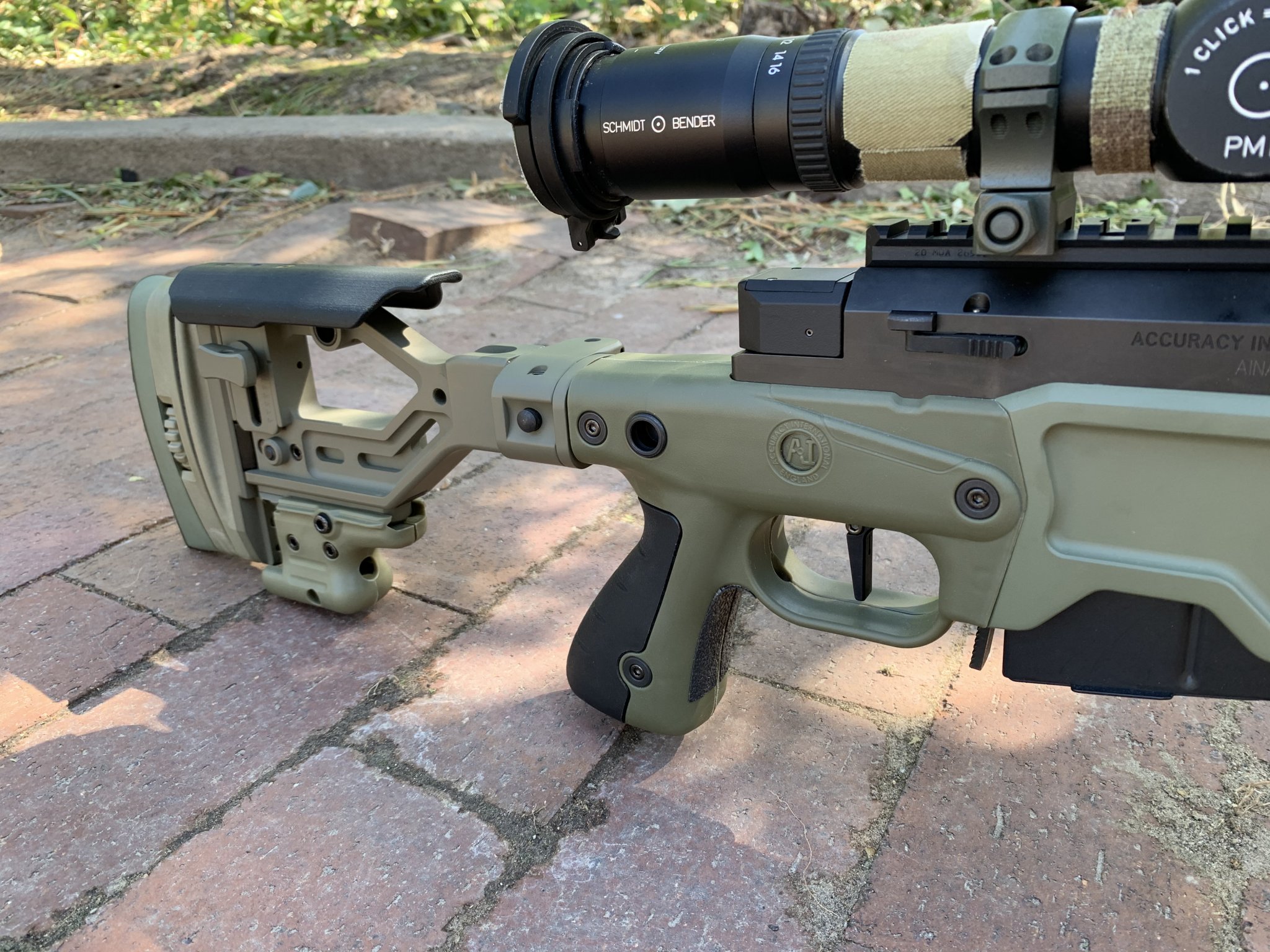

Got mine done! Very pleased with how it turned out. Took my time to get a good bead on the epoxy job and nearly waited too long on the butt stock but it all worked out nicely.
Looks like a perfect epoxy job! I’m always racing against time when I get to the buttstock as well.
The final build looks great! How is the balance? Do you have either of the internal weights installed?
I didn’t have any weight installed for this picture but was playing around with them today. It seemed most stable with the 2lb. weight so I will probably try that first. I still need to get an m-lok pic rail for the bipod since I don’t have an arca rail mount for it yet and I wanted to install that before bolting in the weight.
Wow Sam, you really did all the work on this one and I'm super happy you did. This is what an AI should have always been. You really went the whole nine on every aspect of this thing, thank you! Now we don't have to put up with an old shitty chassis anymore.
19 lbs 7.0 oz as it sits, no weights installed.

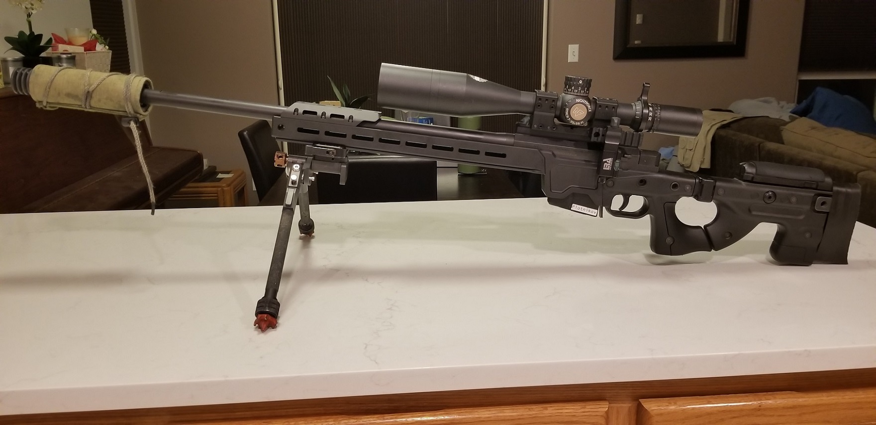

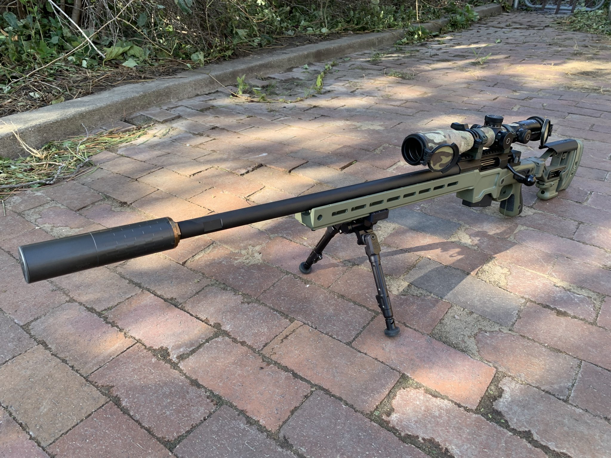

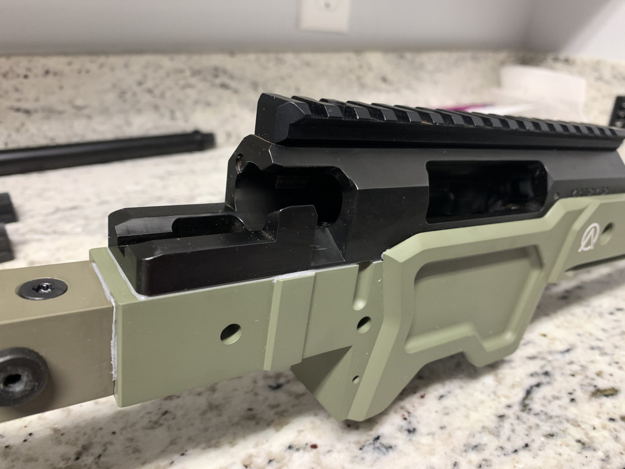

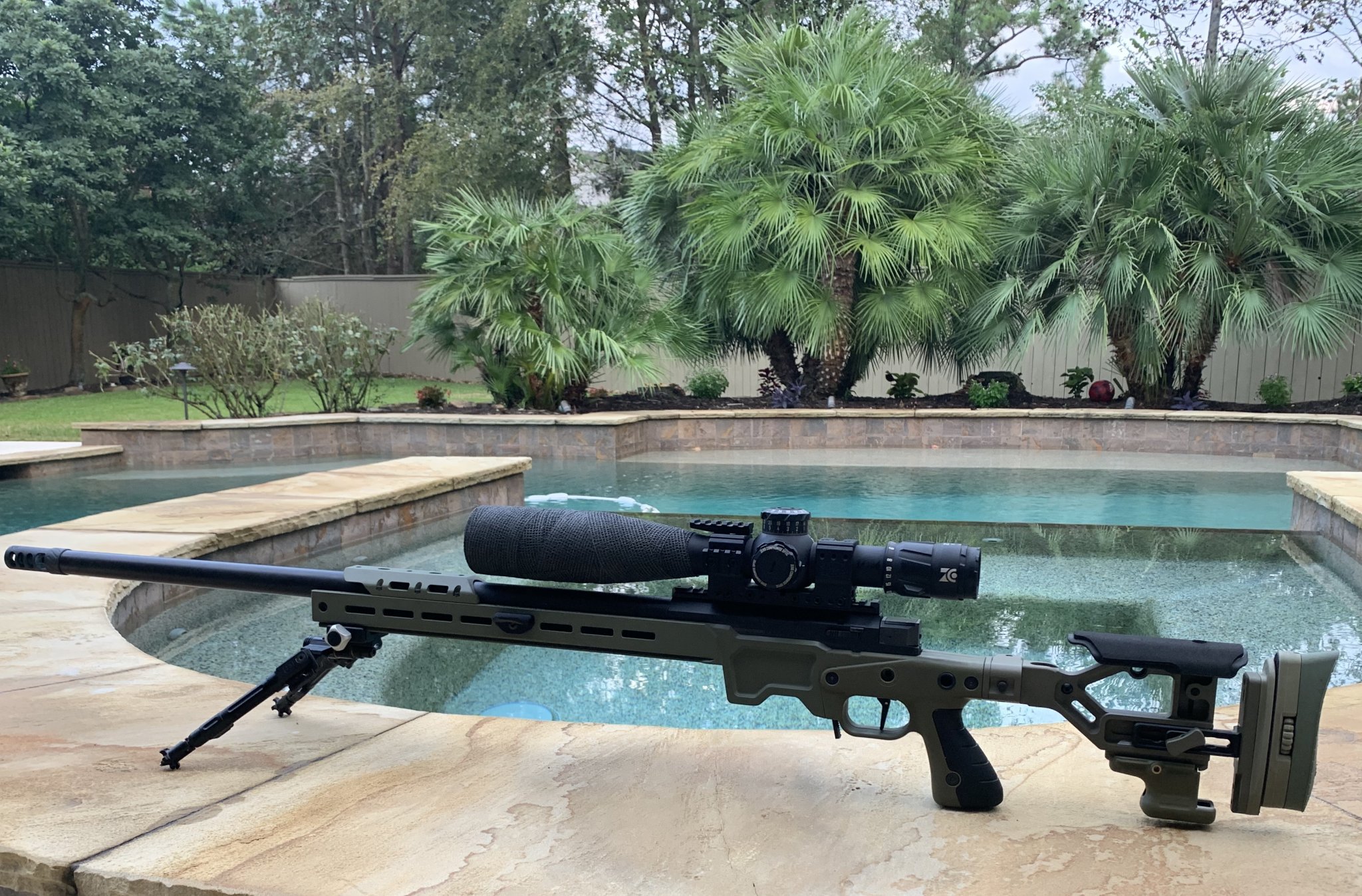

Epoxy has finally cured. That magazine catch spring was probably the most difficult part and yes I did use the assembly pin. Your videos on the assembly were very valuable. Rifle is exactly 17 pounds with no weights. Thanks again Sam for putting this project together. When are you going to build your version of the AR-15 grip conversion? That is the only thing this rifle needs. This has turned out great! Thanks
Looks great, thanks for sharing pictures of the completed build!

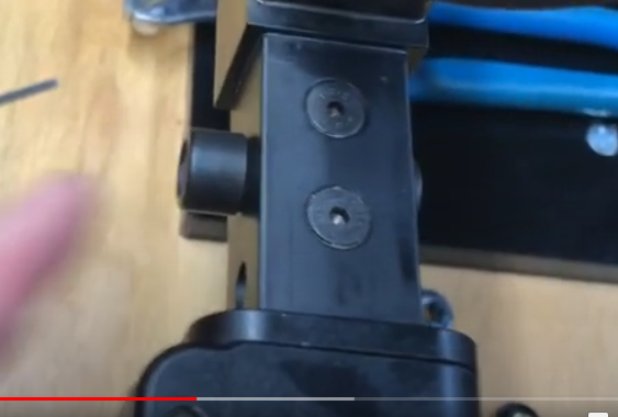

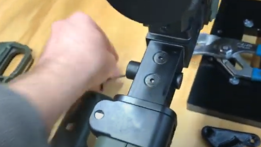

Hey, why does your weak-side QD mount (above the grip) stick out so far? Is it not screwed in all the way, or are you maybe using the incorrect QD cup?
I believe the OBi grip uses MDT's vertical grip core and just adds a slightly different 3d printed outer shell (little shorter and fatter)
Couldn't see any any reason to remove them because the pins are not screwed out so they don't interfere with a non locking ARCA rail. Did I miss something?
I believe if the pins are left in, the clamp will not work properly on non-Arca-Lock rails. I removed the pins on mine, but kept the screws in place.
Yeah, the pins on the arcalock clamp are designed to interface with notches cut into the edge of an arcalock rail. If left in and used with a non arcalock rail, when tightened down enough, they start to create their own notches. I've seen a MPA rail marked up pretty badly by one (though MPA rails aren't exactly RRS spec and seem to be more easily damaged). Either way I'd hate to see that gorgeous AO chassis marked up prematurely!
I had the inside part that has threads on both ends reversed, I was so excited to get this thing together I didn't even notice. Thanks.
Got it! Thanks

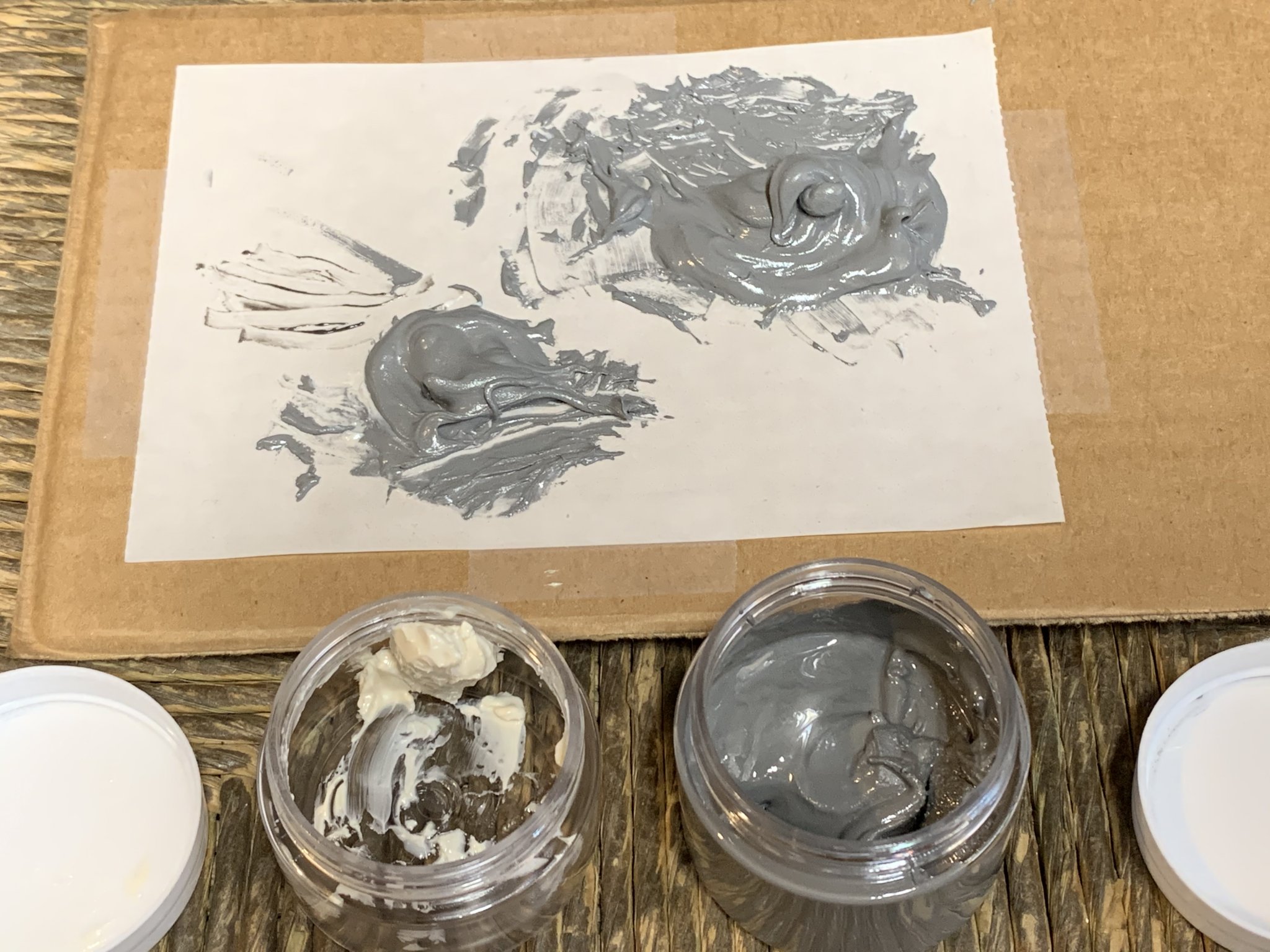

Hi Guys, I just wanted to pass this along. I decided before hand that I would split the epoxy in half. In watching Sam's videos when he gets to the butt stock it's obvious that the epoxy is starting to set up. Yes you can still use it but it's harder to spread around and rather then having to rush along I wanted all the time I could use. When I finished the receiver I still had lots of epoxy left over as seen in the photo of the larger pile on the right side. When I got to the butt stock I cut the half that was left in the jars in half again and still had some left over as seen in the pile on the left side. You can see I still have approximately 1/4 of the epoxy in the jars and two large piles of hardened epoxy. Take your time and make it nice because you're probably going the have this beautiful rifle for a long time. Thanks

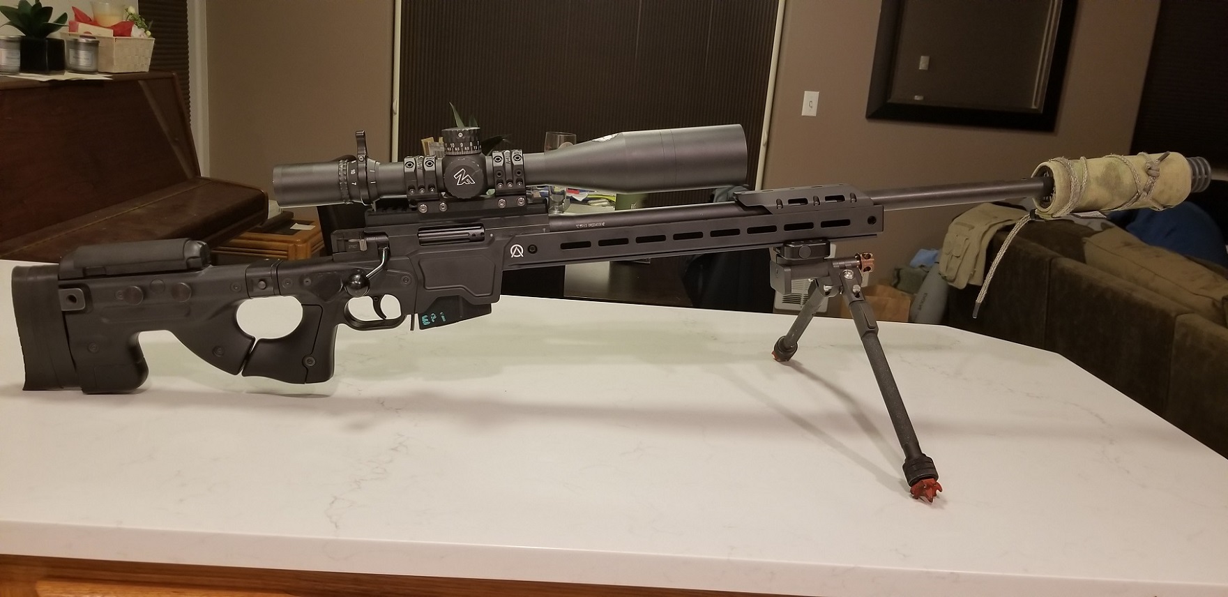

Built this from an AT in an MPA and Adam at Mile High set me up with the shims, rear bolts, mag catch, spring and pin And he even had to machine the rear bolts since they were not available. Great support from Mile High!
Your instructions were great. Came out fantastic. Set-up as pictured is 20.2 lbs with no front weights installed. Barrel is a 28” 6BR Benchmark from TS Customs in their MTU+ contour (Similar in profile to a Proof comp contour). I know I kicked the tires a few times with you on the purchase, but now have the perfect rifle!
I will say, I don’t recommend doing this unless you measure it out with a very accurate scale. The ratio of the aluminum putty is exactly 9:1, and I measured both out to 0.1g, so if you just wing it it’s highly likely that your ratio is off and the epoxy won’t cure as well as it should.
Yes, if you take your time during the action install the epoxy will be starting to harden when you get to the buttstock, but I haven’t found that to be an issue over many installs. If you’re worried you can always buy the Devcon plastic-steel epoxy that comes with the AX buttstock kit (or use that if you bought a new buttstock). Or I can send you another pre-measured portion of the aluminum putty.
Sorry to rain on your parade @FMJ, I just want to make sure everyone’s epoxy job is cured per the Devcon ratio.
Sam
No Problem. If the ratio is correct to begin with, and I'm sure that it is ... it's not that hard to split it in half.

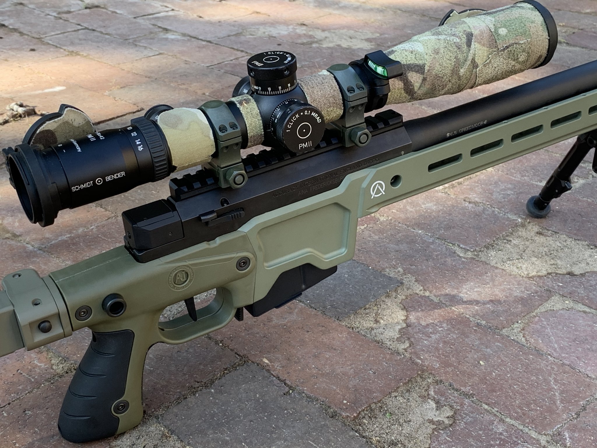

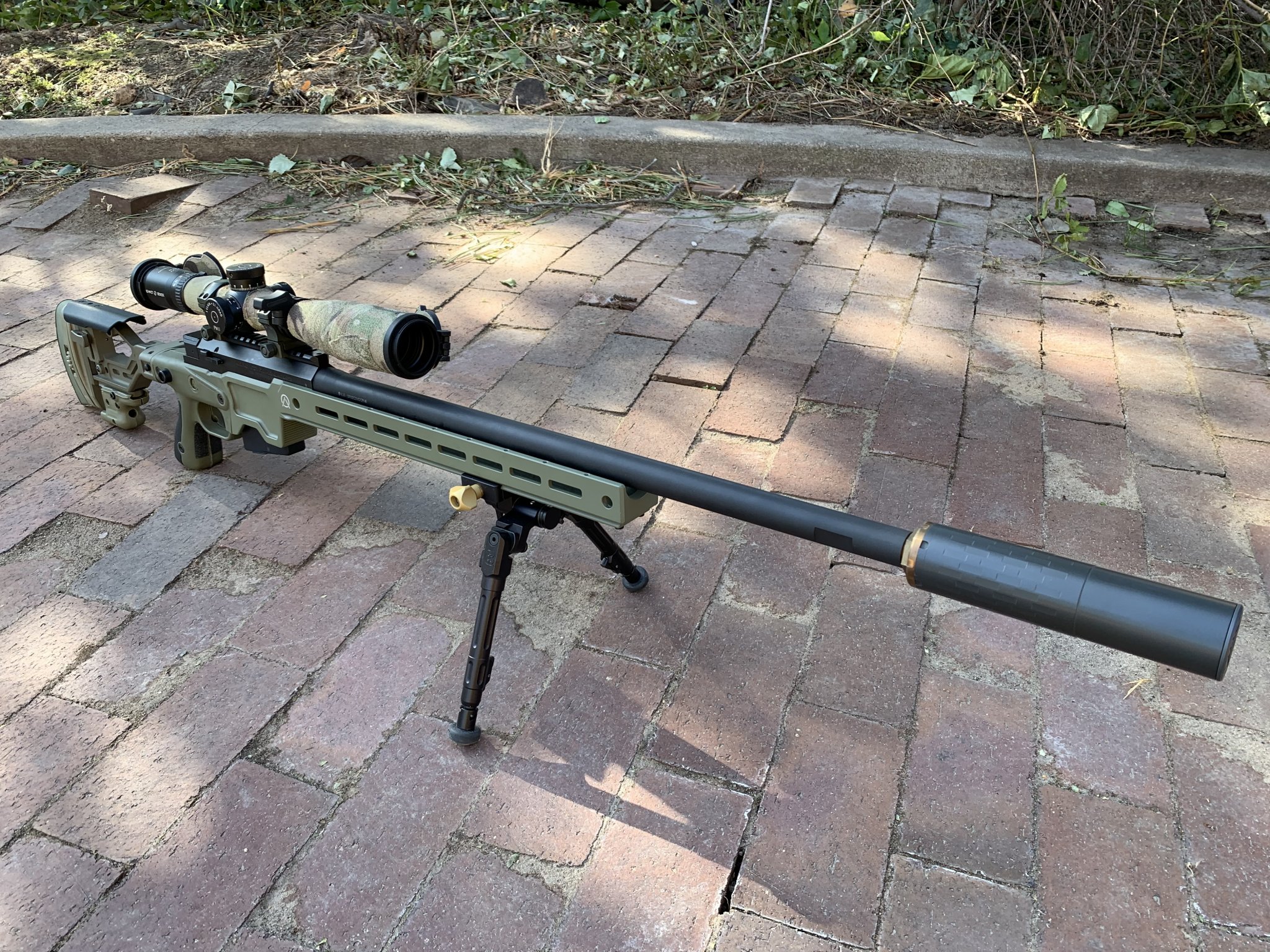

To get ready for a match today, I shot the Obsession chassis yesterday for the first time. After having it all torn apart and putting it back together, windage was dead on and elevation was only .2 mils high, but that’s likely more from switching from a can to a brake. Was really amazed at the repeatability after reassembling it.
The match today went great and I couldn’t have been happier with how the chassis felt and performed. The stability on a bag was far and away better than the original AT chassis and the balance with the 2 lb. weight felt great as well. I didn’t win the match but at my current level I didn’t expect to, but I did have a personal best which is awesome in my book! I’m going to love shooting this thing for a long time!
Damn dude, that’s awesome, congrats on the personal best at your match! Thanks for supporting this project, and thanks for sharing your initial experiences from your first couple sessions with the new chassis.
My experience has been similar with re-assembling; my zero barely moved, even with the barrel and scope being removed along with the re-bonding the chassis. I think more than anything it’s a testament to the repeatability and consistency of the AI platform, especially since my chassis simply replicates the action/chassis interface. Over the past 5 years of shooting an AI exclusively I have enjoyed not having to re-torque action screws or chase wandering zeroes, or worrying about barrel swaps.
