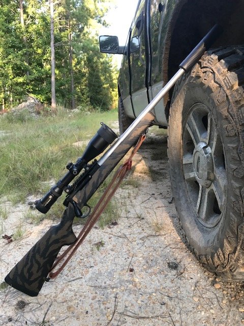

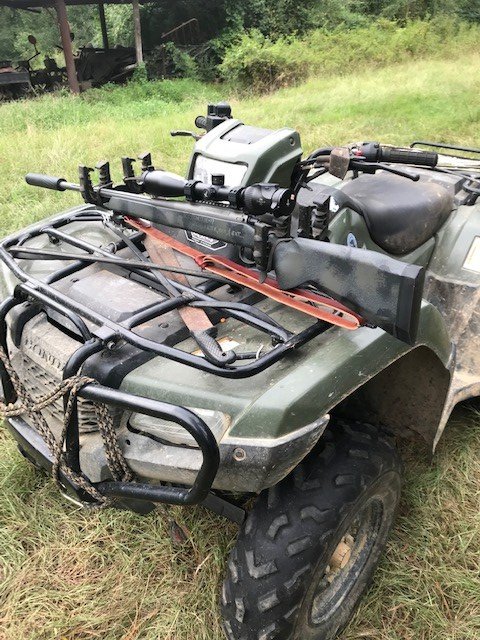

I've got two of them. One bedded and one not. Both rifles shoot great, can't really tell a difference between them. In fact, I've taken the un-bedded rifle out of the stock many times and it always returned right to zero, so the fit must be really good. Hence, why it remains un-bedded. My CS experience was great, quoted 10 week lead time and they delivered on time.
I've owned multiple Manners and McMillan's and the fit and finish on the AG is on the same level, with my samples. Mine both met the published specs and weights as well, GTG in my book.
Carbon All Terrain (6.5 creed un-bedded)
Stocky's M50 (previously made by AG several years back) in .280 Ackley
