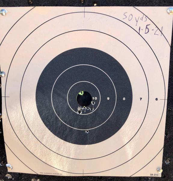

About 15 years ago I took the "new" Ruger target tactical and in an attempt to match the accuracy of a 25 year old RSI I had built, I did the trigger work and removed the Ruger 16" hammer forged barrel and installed, what was advertised as a 16" stainless 1:11 optimised for the SSS from a company that was only around for a few years, I can't remember or find them now. It ended up being pretty accurate with the SSS, but never as much as my ole RSI. I lost both of those in a tragic pawn incident for 1 bill a piece ;,((

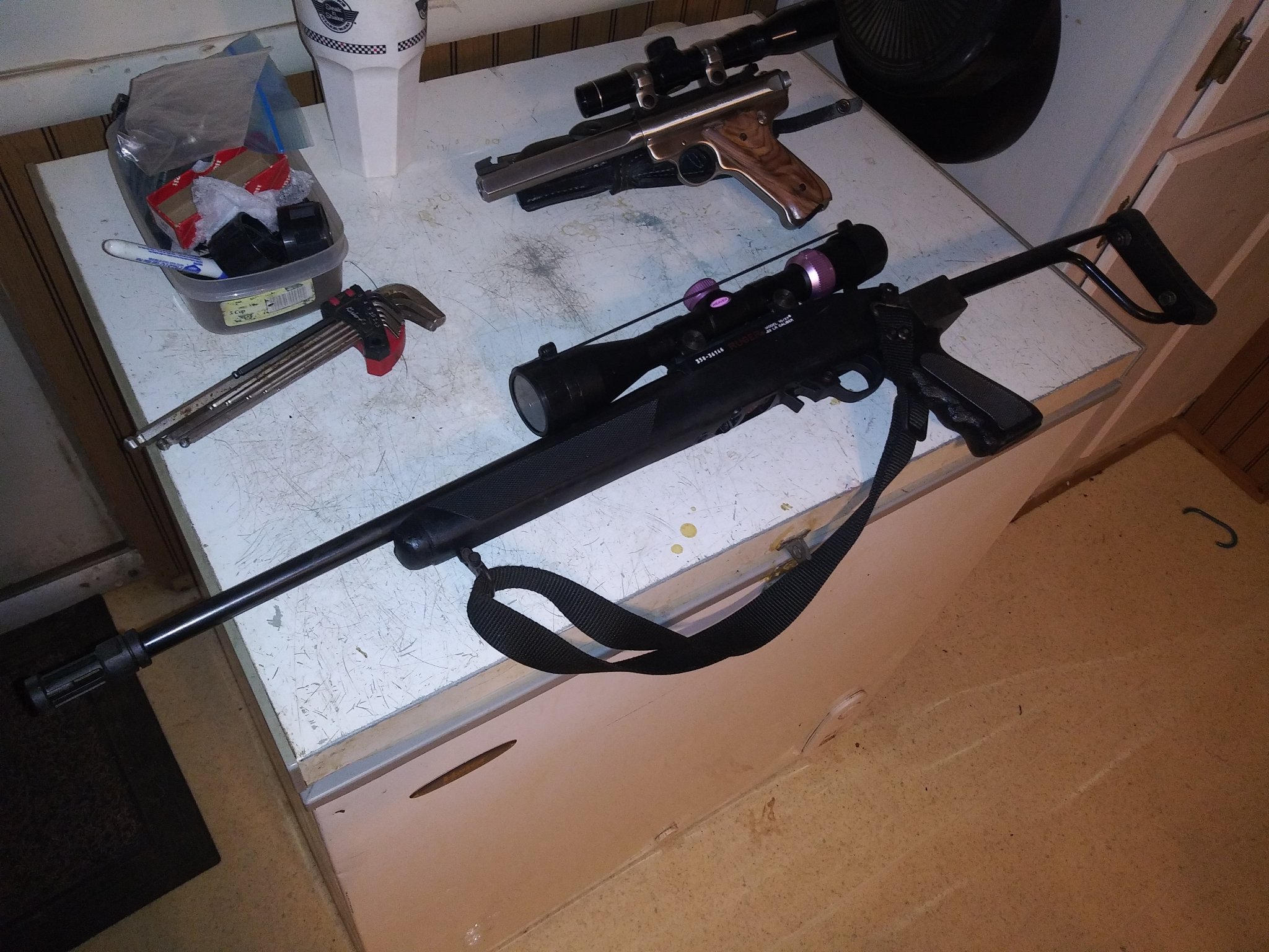

I got quite a starch of SSS , as well as other ammo. I just finished putting together a nothing special 10/22 plinker and I'm working on a new to me charger (incedently with that original ruger hammer forged bull barrel cut to 10". I've yet to fire either, so no idea what they're gonna like or do. I'm feeling the hankering to build another precision, just wish I could find one of those 16" 1:11 SS bull barrels to start with.
Pic of the 10/22 and what I started with for my charger (it's completely disassembled at the moment, binary trigger just arrived today!)
