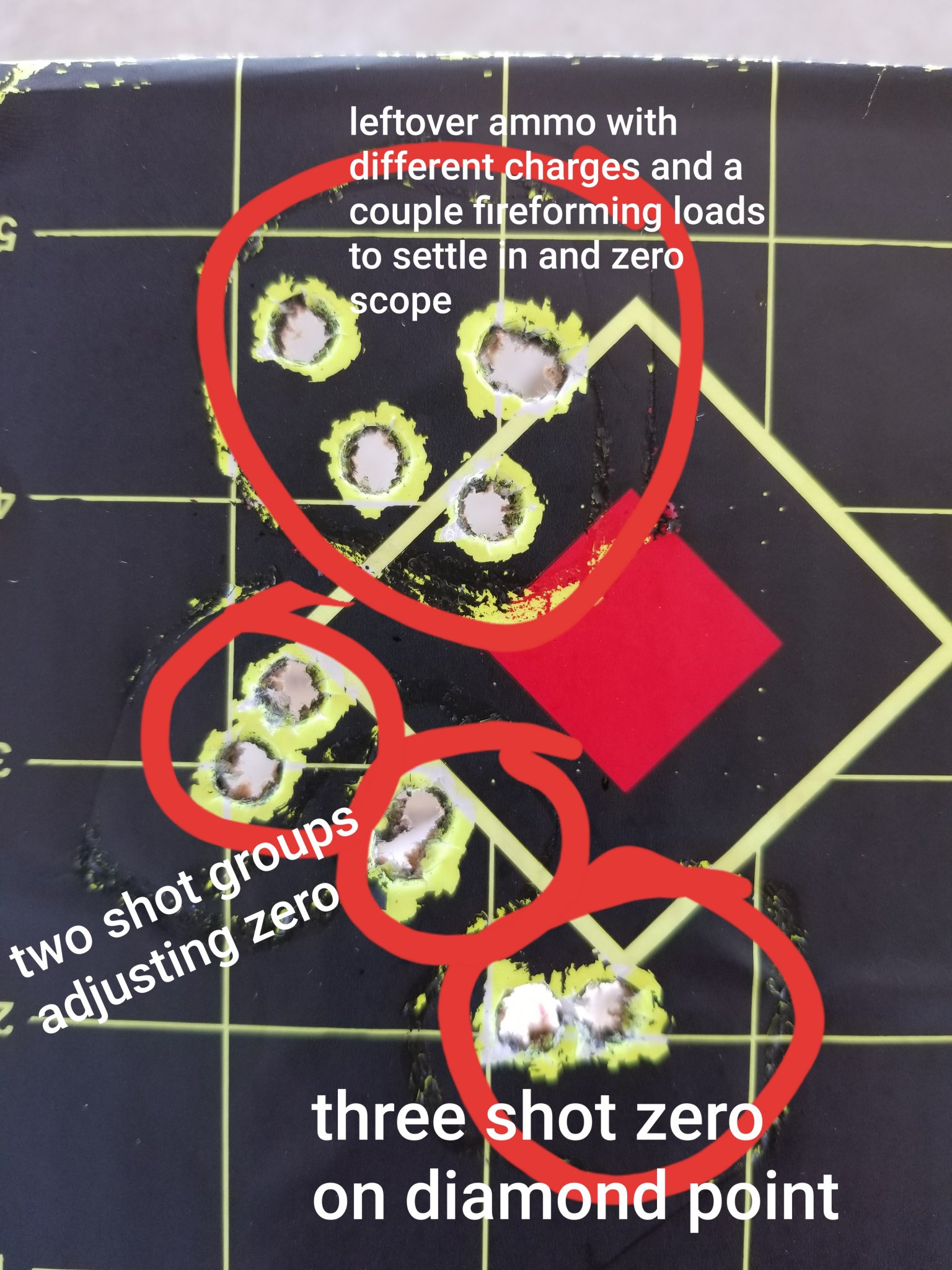

    The 7 Rem Mag, 7mm SAUM, 7mm Sherman Short mag, 7mm WSM will push a 180 Berger VLD at or just over 3000 fps. It gets you to 900 yards for hunting and further depending on DA.
    The 7 SS is the most efficient of them all and can be run in a true short action. This is the published load in ADG brass with RL26 at 3000 fps. I just loaded it up and took it to the range. Far easier than my 7mm rem mag to shoot like this.
    If recoil is a concern, then run a 7mm in the 175 and 180 grain. Its plenty for elk in the boiler room.
    If bullet size is the thing, then 300 all the way. You need to get into the 230s to beat the ballistics of the 7mm 180 vld unless you send the 300 hot.
    If you want factory ammo, 300 prc all the way.
    I shoot a 7 saum which is ballistically similar to 280ai
    180’s at 2800-2950 is plenty potent and it’s quite good at smacking steel past a mile and 1000 and in shots are silly easy.
    Recoil is really mild.
