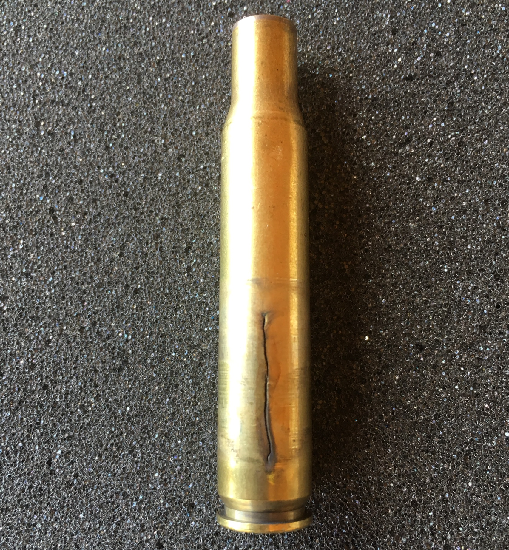

I have a couple hundred pieces of brass with partial case-head-separations. None of them is like that. All of my partials are around the circumference in the normal spot. I had one full head separation - fracture is in the normal place. I think I have two pieces with a longitudinal crack in the neck. What are those circumferential scratches around the fracture? If the case was rotated in the chamber I would expect to see scratches in or around the extractor groove. What weapon was that fired in? Does the weapon have a SAAMI chamber?Hornady factory 30-06 ammo first firing......![]()
