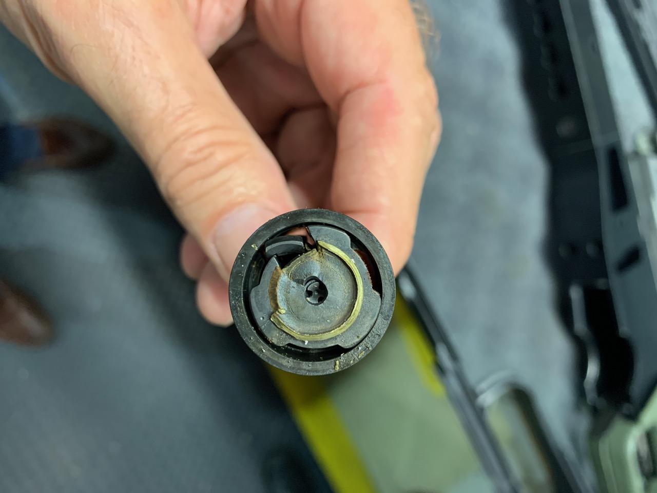

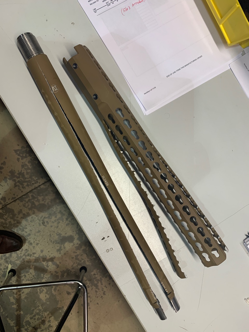

Here's an image of one of my recent souvenirs. A massive over pressure event with an AX338 Lapua Magnum due to an "owner provided" bore obstruction. The bolt opened without undue resistance, the action easily passed headspace. If the split did not run back to the chamber you could have cut the damage off and shot it again safely. The images I posted are from legitimate over pressure events. Parts have yielded, but otherwise performed as designed (i.e. did not completely let go). Gas leakage due to expanded primer pockets doesn't come close to these pressure levels. Just run 70,000 or so PSI loads with brass not made by Lapua, ADG, Peterson, and a couple of others and you will get there pretty fast. How many times have you read on the interwebs some guy getting 2900 fps with a 6.5 Creedmoor and 140 grain bullet? It isn't possible at safe, reasonable pressure levels, and yet guns tolerate it until the GD fool decides to add another .5 grains of powder . . . Wasn't seeing any pressure signs!
Not all over pressure events turn out this way. The second image is an AI bolt head and what is left of the case head. The extractor is FUBAR as is the bolt and lock ring. This is from a "high pressure" hand load. The primer is not pierced. Brass, in a plasma state, has been "plated" to the parts. The barrel and chamber were completely OK and reusable. The brass is the weakest link in the chain. The gas leakage shown in the OP clearly does not rise to a level that will cause the metal to yield. The damage done to the bolt face is not pressure induced and it does not affect the chamber. The metal removed by gas cutting from leaking primer pockets is like cutting metal with an acetylene torch. It is the result of extremely high temperature gas, not massive over pressure as demonstrated in the images below.
As I said earlier, this is like getting a hard knuckle rap to the forehead before cashing in your life insurance policy. If this doesn't make sense to you and you want to say the manufacturer of the firearm was somehow at fault, you should consider taking up golf or badminton. People f__k up guns all the time and lie about it. The rate of truth to lies is about 33% to 66%. The OP was lied to and now there is a long thread dragging a stinking, rotting lie to AI's doorstep.

Here's some recent souvenirs I've added to my collection. Only one owner was truthful about the failure mode. That's 66% lairs.
Don't be that guy.
What was the owner induced obstruction that caused that ?
If you are referring to the barrel that is split nearly end to end, yes.
That 338 barrel and handguard split is nasty. Those parts would be a great addition to the "wall of shame" for sure. I have a "wall of shame" for parts from engine failures, but so far luckily no such wall for catastrophically failed gun parts...
Was the rifle able to be returned to service? I'm assuming the breech ring, bolt, and barrel were replaced, even if the headspace checked out ok after that, but I'm curious if the front of the action or the threads in the action were flared out or otherwise damaged from the split barrel.
Also, am I seeing things right where the barrel split and broke just behind the muzzle threads and shoulder? I'm guessing the muzzle threads remained in the brake or suppressor?

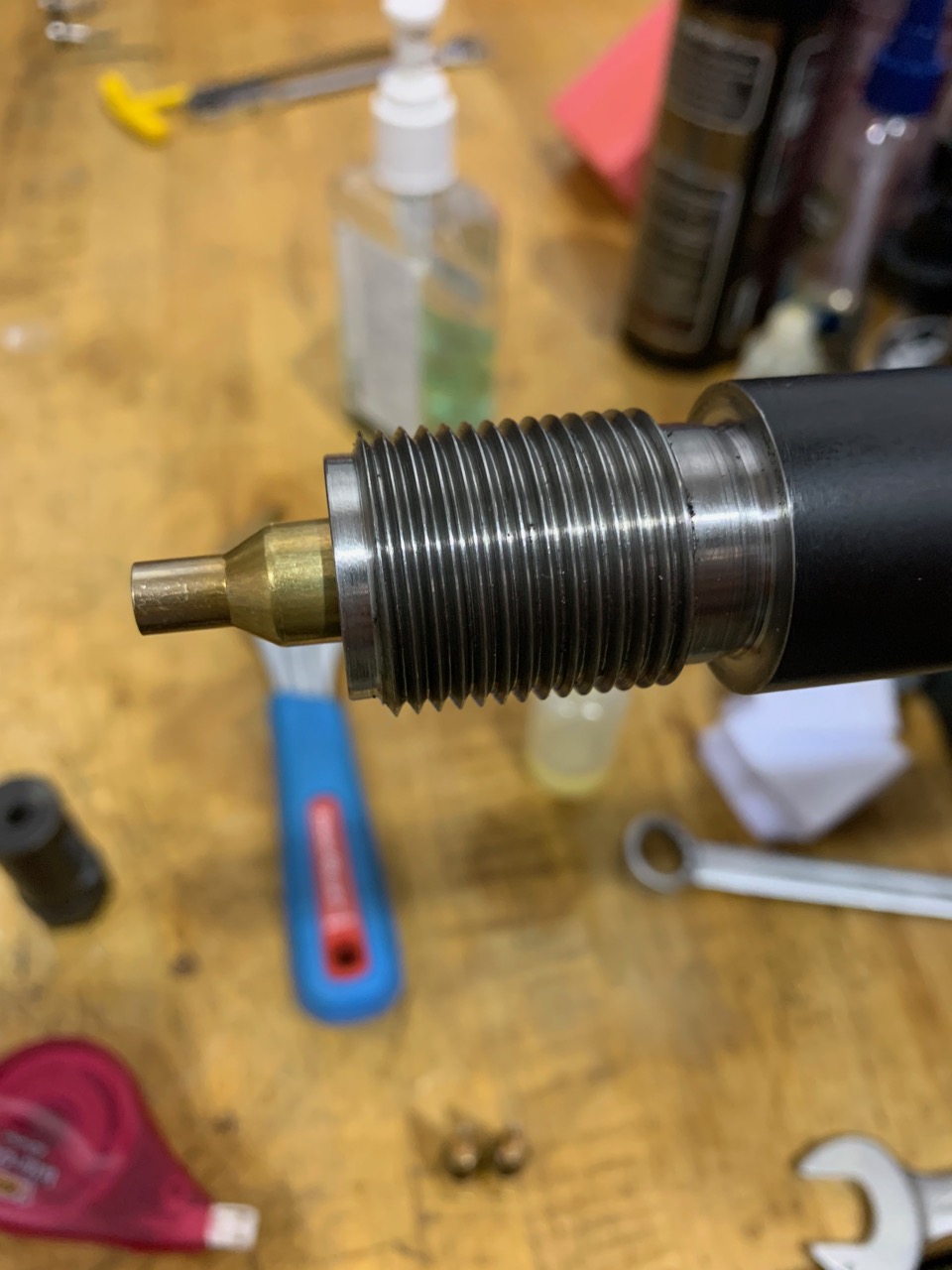

Looks like that large pin (0.080") .308 bolt was used in a .260 rifle instead of the small pin (0.062"). Peak pressure duration - pierced primers.
ETA: I have seen someone attempt to run a small diameter pin in the large diameter bolt without being bushed (not AI).

You assess the pitting to see how deep it actually is before conducting any rectification work
If the pitting is so bad it may affect the relationship pf the extractor to the bolt nose then why on earth would you continue ?
The Ejector plunger is always proud of the bolt face Scott (unless the weapon is loaded with a cartridge in the chamber and bolt closed) - it wouldn’t work otherwise
Firing pin depth is easily altered on most of not all Accuracy International actions (you should know this I hope ?)
Chamber headspace - again easily altered by machining the tenon shoulder and rear face
But (and I stress this point) as it’s clear that everything needs to be spelled out in simple terms
If the pitting is so bad - that the rectification work would unduly affect the extractor then you wouldn’t even start the work
Purchasing a new bolt is the answer
(A new bolt head would be the most cost effective part to replace if it were available in your country )
