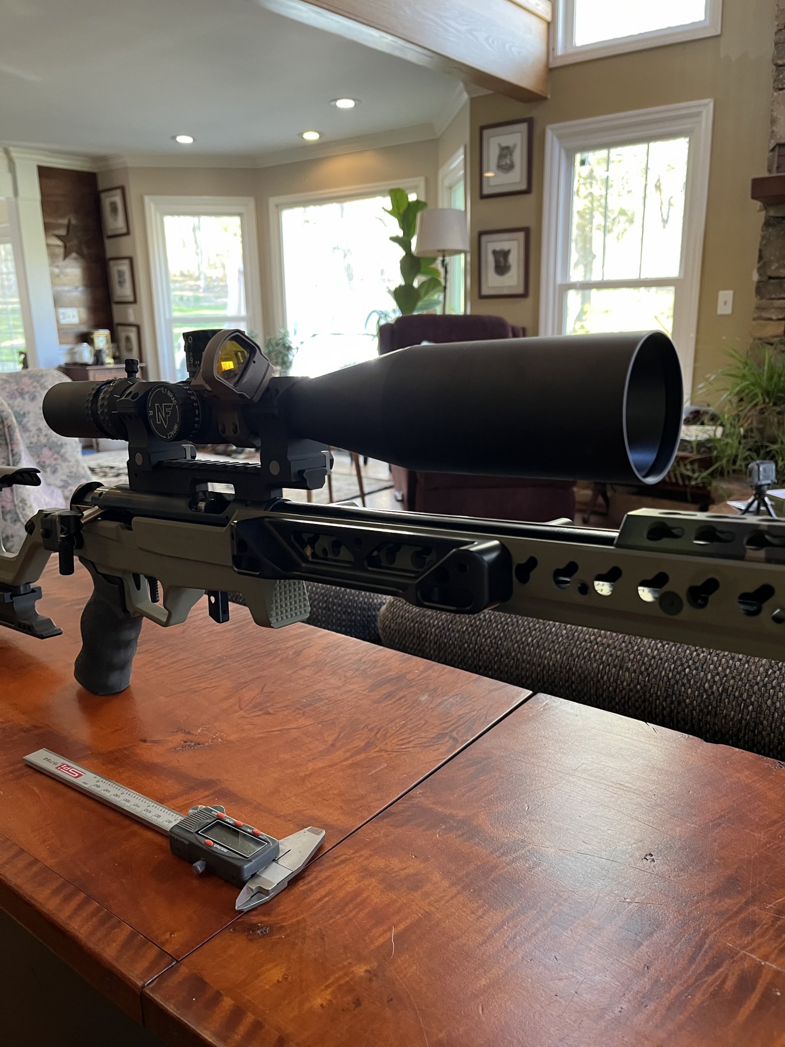

Actually, it really would not be that hard, you would create a CAD model with the KeySlot attachment and forend geometry. You could start with a 3D scan of the Anschutz piece to provide 80% of the model and then send it to the printer format (oops the inner engineer came out).
Reactions: gamewarden

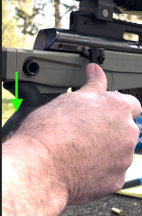

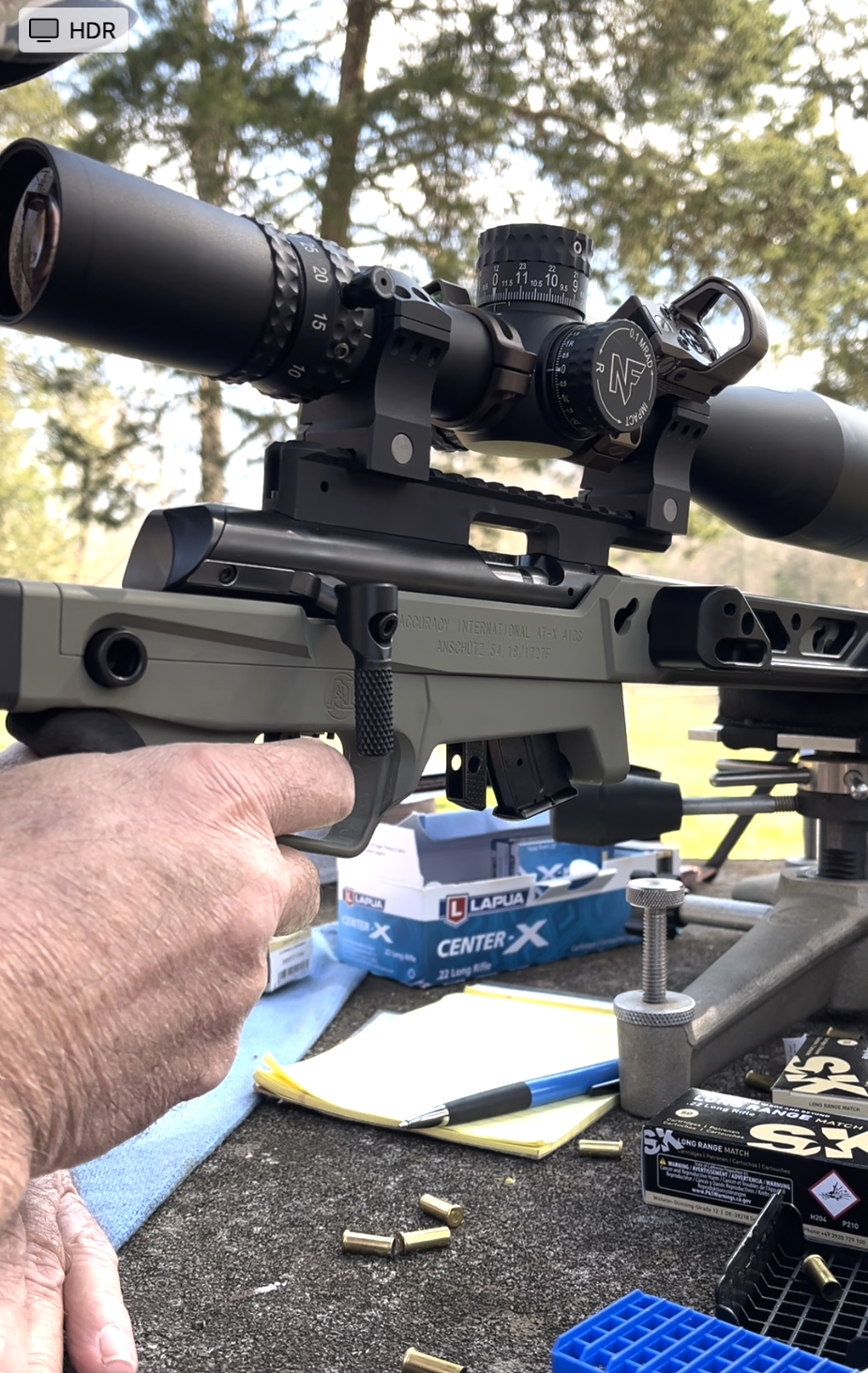

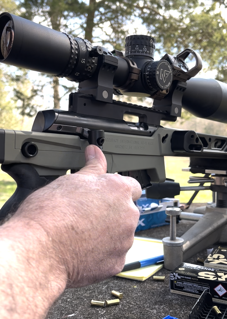

Some of you that have the 1727 in the AI chassis should take pics of where your hand and thumb sits naturally compared to the back of the bolt because I feel like you might have to lift your hand to reach it compared to how my thumb sits in my 1827F's stock recess which is why I like my gun so much being this motion is effortless.
I mention this because a thumb tab attached to the back of the bolt might need to be created to reach "down lower" to be accessed naturally.
I never actually touch the back of the bolt with my thumb. My arthritis prevents that, I have found however that I can move the toggle using my thumb and forefinger pretty quickly. I will not be bothering with the thumb tab.
Unfortunately, mine doesn't get here until Wednesday, and then I have the Cali 10 day cooldown/jail period (rolleyes)....
That's unfortunate but you'd be the exception to the norm.
It cracks me up trying to get my friends, or someone that hasn't shot my Fortner, used to pushing the bolt forward with their thumb. First thing they do is lift their head up, grab the toggle with both fingers after the shot, and some of them have tried to lift the toggle up like as if it was a bolt action. Then I have to say, nope, keep your eye in the scope, don't move your face, pull with your pointing finger all the way back fast, then push forward all the way with your thumb fast.
After a couple mags worth they get used to it and enjoy the Fortner experience much more.

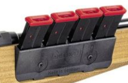

Thanks. More interested in the biathlon type if anyone is aware of anything.
I have that on my biathlon trainer. Is nice and secure, and makes for convenient storage of your mags, but it is awkward to get to for quick reloads. You have to break position and reach over the rifle to get to them. I’m quicker pulling them off a belt caddy. But coupled mags are even quicker & easier than that.

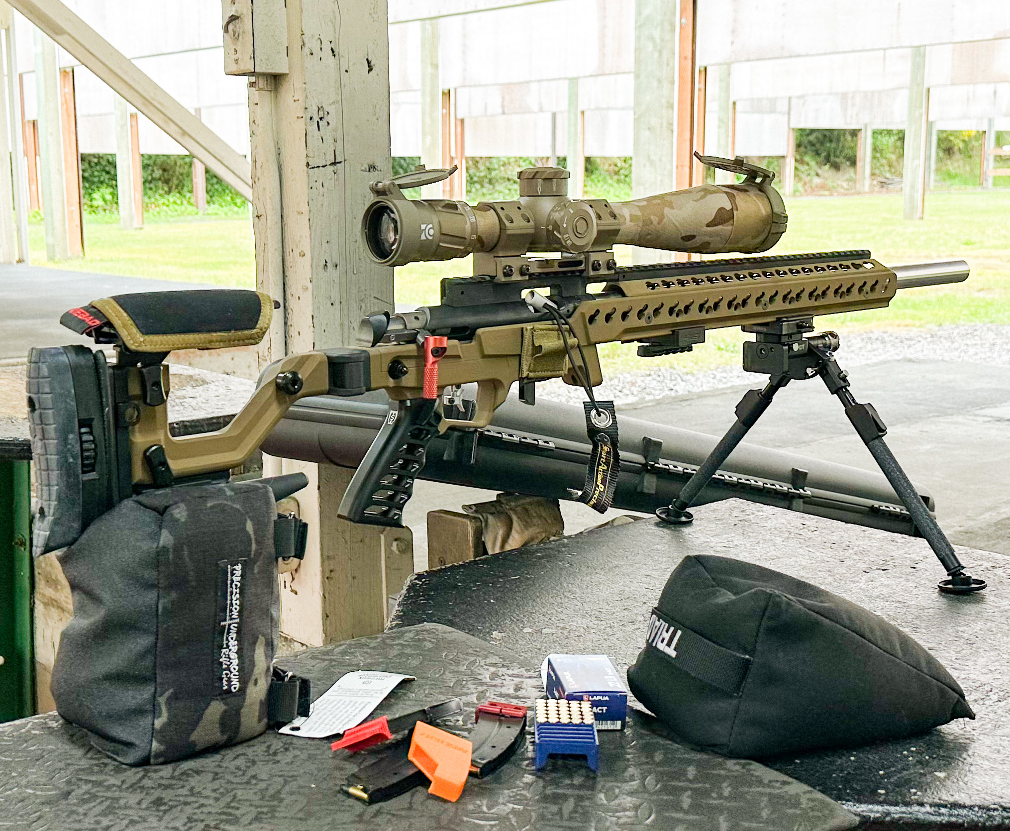

im not sure if this is the place to ask, but it seems there's anschutz knowledge here....
what anschutz actions have the same footprint of a Remington 700? such that they would fit into a Remington 700 inlet stock?
is this 54.18 action a 700 footprint or is AI making the chassis to fit this gun only?
AI is making the chassis match the two Anschutz footprints (it's not a Rem 700 footprint).
Couple screenshots off of a video of me running a magazine through the Annie.
I've always used the grip like this, and the Fortner is effortless to run
I guess I am lost about what benefit the lever provides. If my thumb is in the same basic position, bolt butt extension lever, vs toggle, what exactly am I gaining? My thumb is able to push the toggle forward fairly quickly and is touching the toggle already from the ejection motion.
Reactions: Criver600
On the 1827F... the palm is on the palm-swell, and the "graspers"
remain in place on the grip (on the lower shooting hand).
The arrow shows where you hand is supposed to be....
Go on YouTube and watch some Biathlon events while concentrating on how they cycle their Fortners.
Well, I guess I am different, I know I can never use my thumb on the bolt, that said on the stock my thumb stays right near or on the toggle while I fire, them my trigger finger comes up to push the toggle back(thumb on the toggle) and then the thumb slams the toggle forward locking it. To me that is as efficient as I could get.
Reactions: dawkind
sub 1 second cycle time, with zero break to position...
Yes that’s how the Fortner was designed to be run. Caveat is if you’re used to running a Fortner that way, it’s a new manual of operation. It’s really not much slower at all once you get used to it. I’ve got a video at work with the 1727 AI running it fast and the group forming on the video monitor.
Hey man I'm sympathetic about your arthritic thumb because I've got my own physical problems and thankfully the Fortner can be operated both ways which is a neat attribute. Who knows I might be in the same situation in a decade???

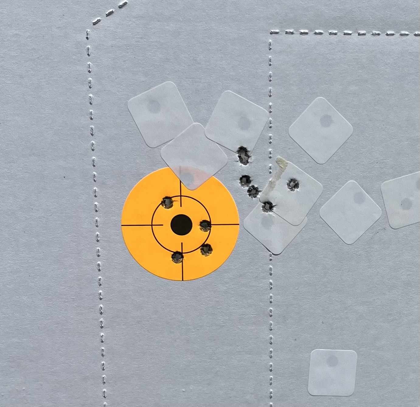

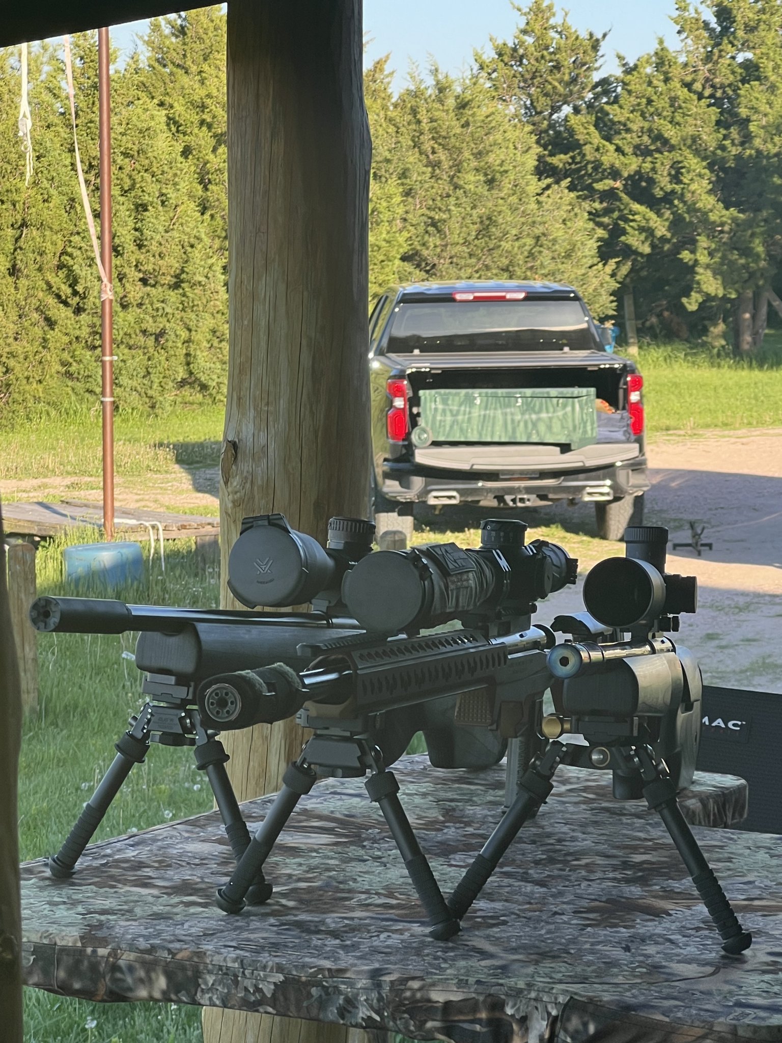

Finally got it out to my farm at 50yds….had a 17-32mph west wind and, of course, I’m shooting dead north….I did my best to wait on conditions but they just got worse.
90% of the time it’s from the south….shooting SK Rifle Match, saving the RWS R-50 for a little down the line.View attachment 8377345View attachment 8377347View attachment 8377348View attachment 8377359
Looks like once this barrel is seasoned it’ll really shoot…not too bad now. :)
It did have a phenomena of throwing the first shot low….the last group has 10rds but it was a fight. View attachment 8377362View attachment 8377363

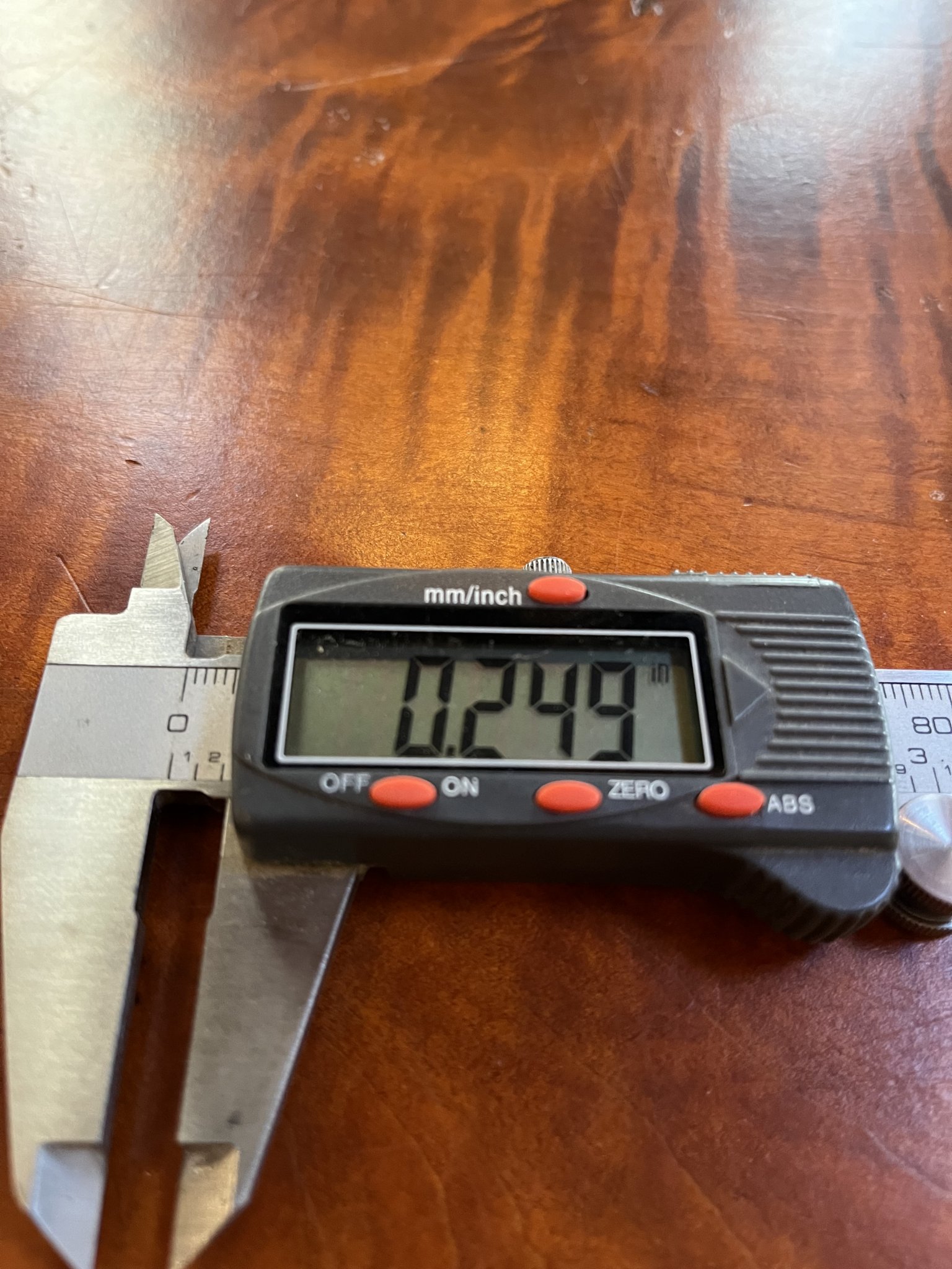

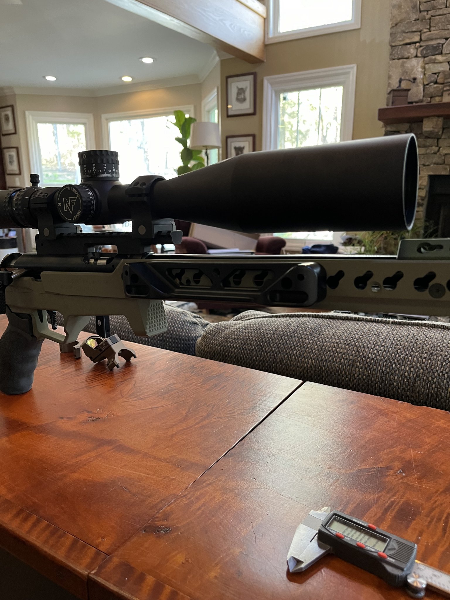

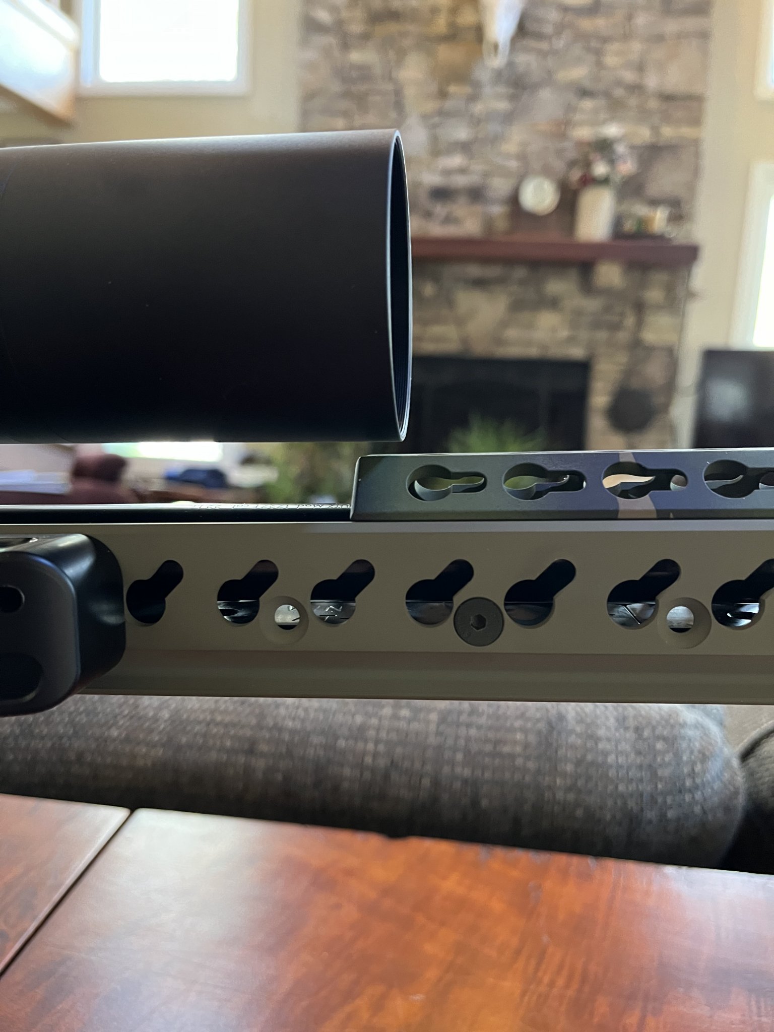

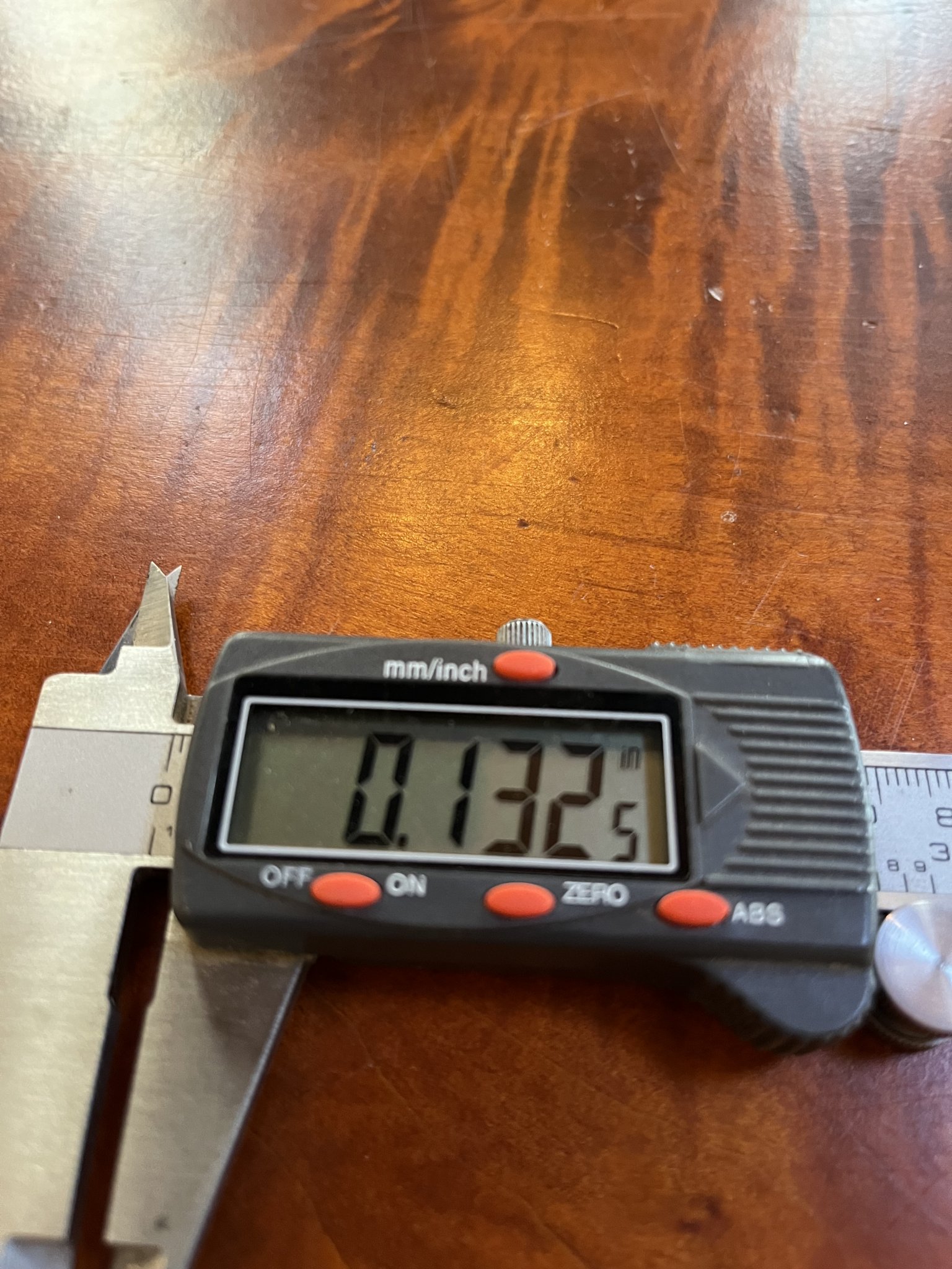

What height rings are you running, that clears the barrel shroud?
Well crap. I just ordered a 1.5" MBrace. Oh well, I can order a 1.25" later if it really bugs me. 🤷‍♂️

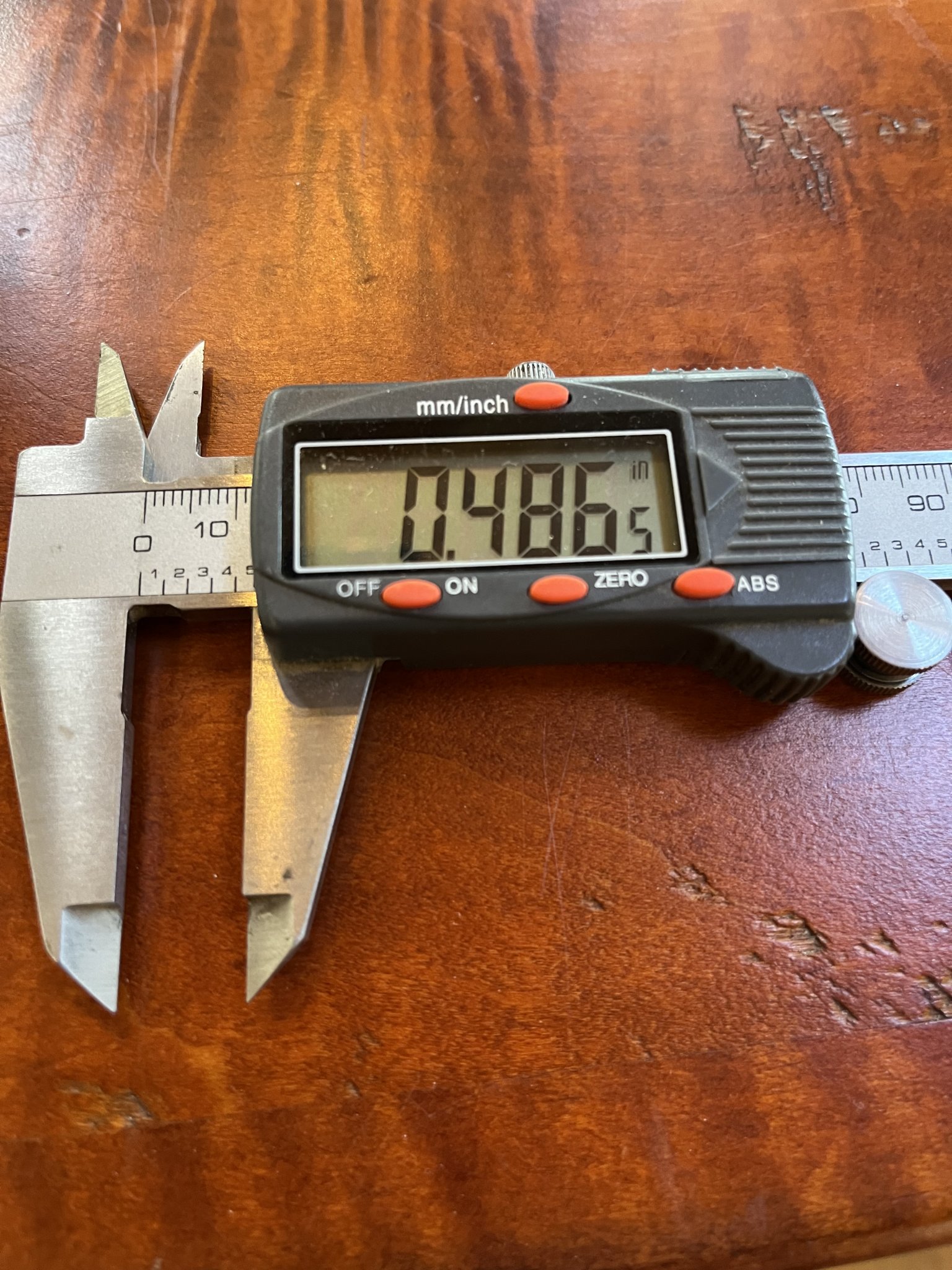

Up first is the NF 34mm 1.375" .486 over the bridge.
NF 34mm 1.125" .249 over bridge
NF 34mm 1" .132 over bridge. I used these for a couple of weeks. The April NRL 22 COF had a stage with shooting weak side and I struggled to find the reticle. Went back to the 1.125 and no problems with weak side shooting.
7X35 ATACR is a "big" scope, with the sunshade & a 30moa base you may prefer a little more clearance.

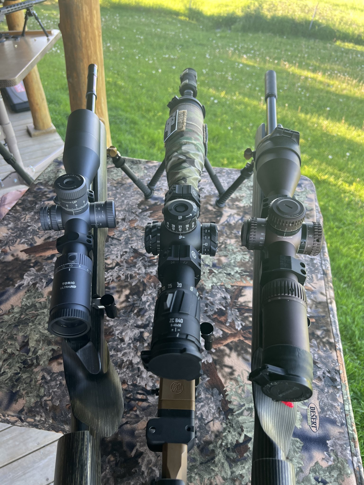

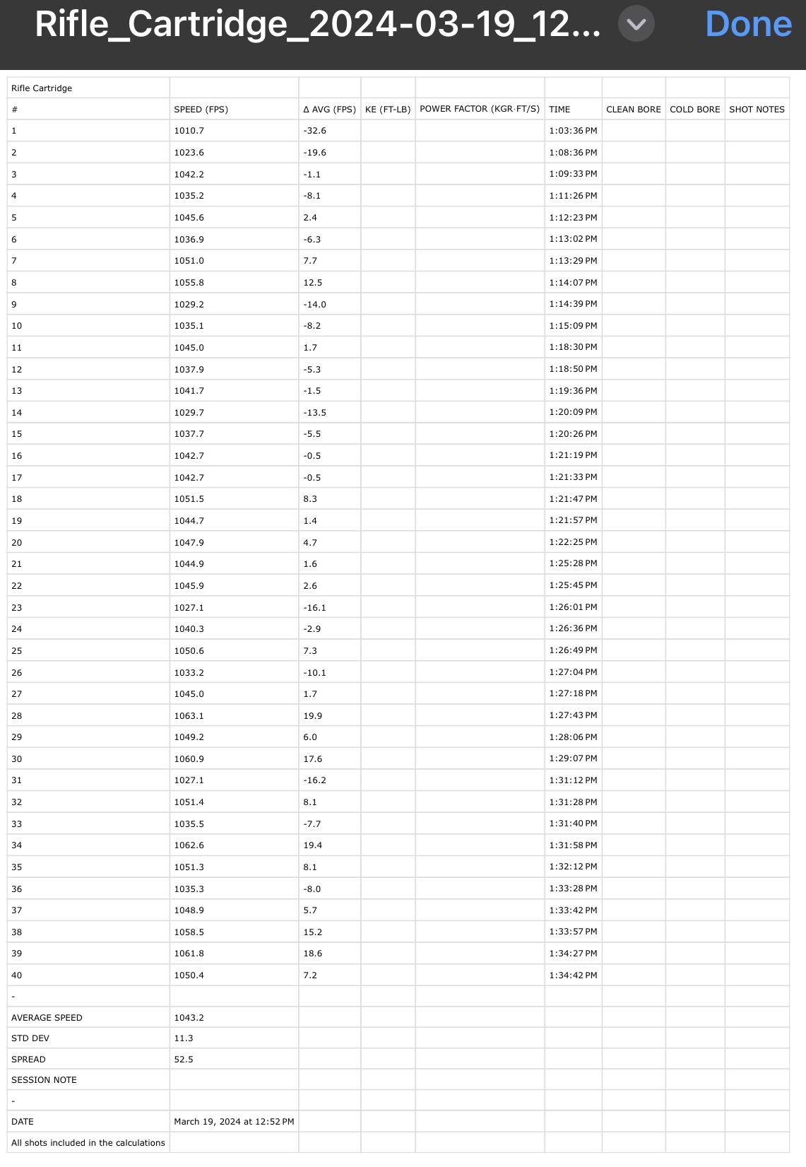

Only about 200 rounds through it. Scope is ZCO 8-40 MPCT 1X. It seems that it likes Lapua Super Long Range best, still some vertical so ordering a Harrels tuner for it. Should tighten up. Shooting at 100 yards for the first time, lots of fun!
Nice, Steve B and talked about getting one of the GRS guns, but I was impatient and the stock I wanted was not available yet. So I went in another direction (CISM). I like that you seem to get good results from the factory barrels, I have had exactly 1 factory barrel that I thought was excellent ( my fortner), 1 that is good based on purpose ( my 1712 for silhouette) and the rest have either been re-barreled or are sitting in the safe and may get re-barreled (original 54:18 msr, I have a bartlein on order). I suspect I just follow the illusion of something better. Yours seem exceptional (400 rd hit👍).
