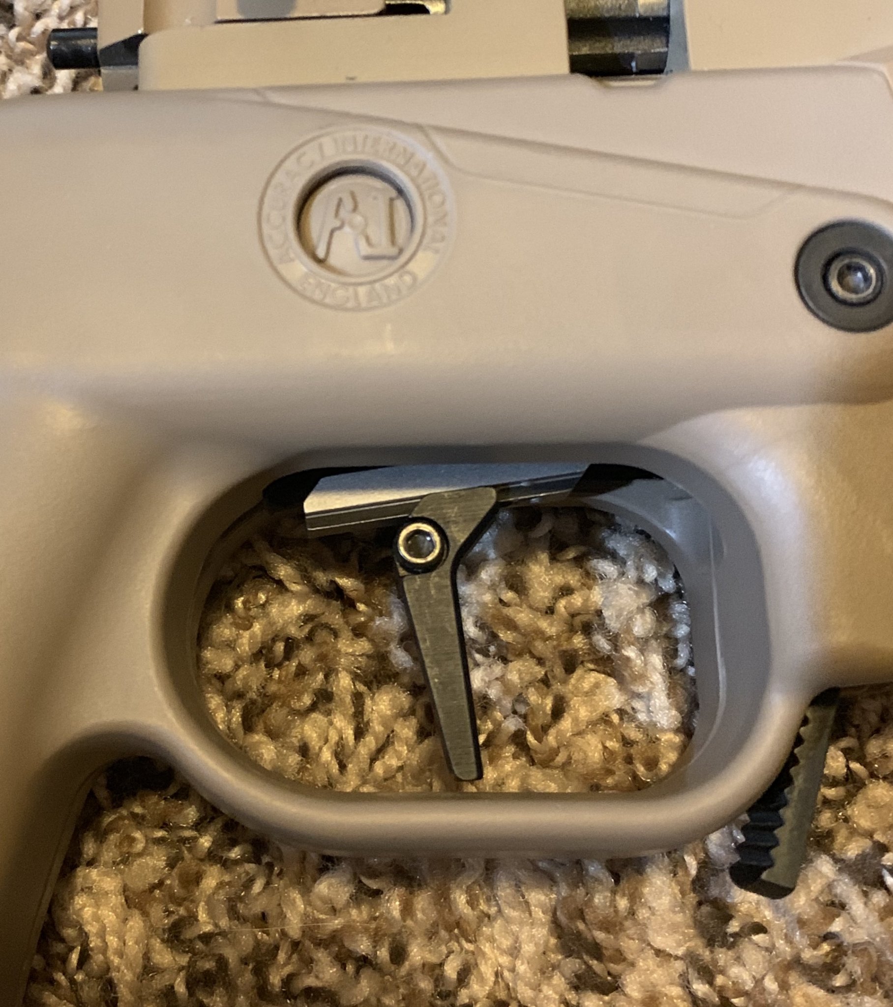

I have one. If you like flat triggers, grab it.
It’s wide like the factory trigger.....and well.....flat.
I prefer the smooth curved comp trigger shoe on a tuned factory trigger. But the flat is definitely very nice.

Advantages?
Finger isn’t relegated to the back of the curve.
If your finger is more comfortable at the top or the bottom of the trigger and you force yourself to use the curve since it’s rhe only option, this is for you.
7066563
I feel as though I get a good 90 degree trigger finger on them and have a nice, straight back pull. It’s all personal preference really.
I like 'em.

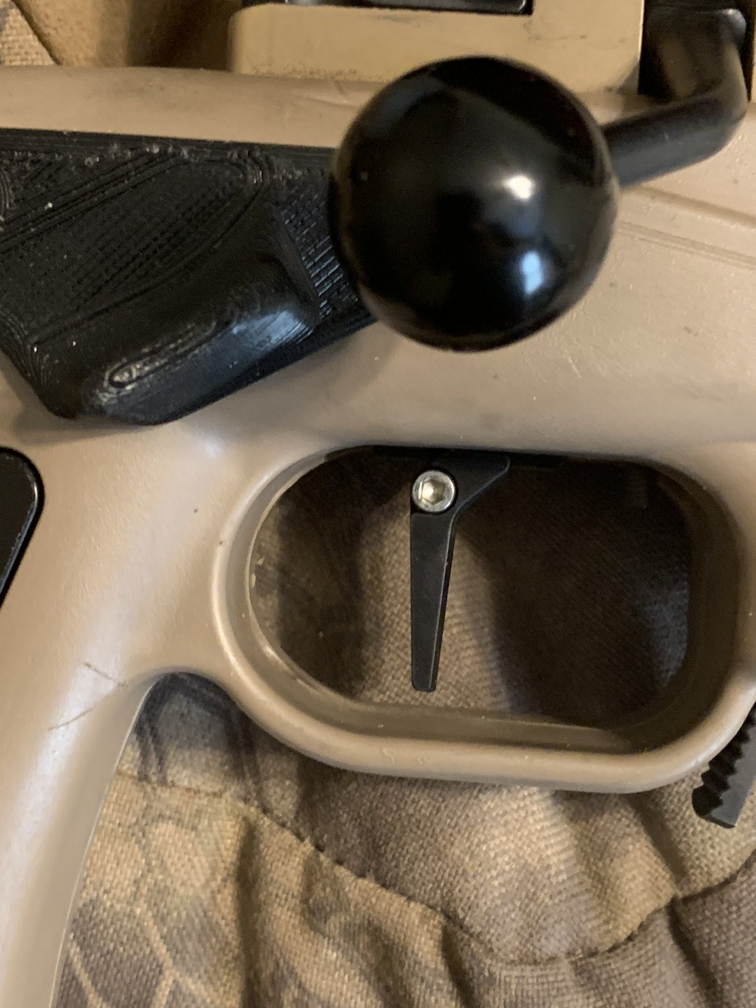

I ran a prototype since January and tried a few different positions on the trigger hanger, ended up here.
7066569
First stage ends at a perfect 90 degree sear break like this.
