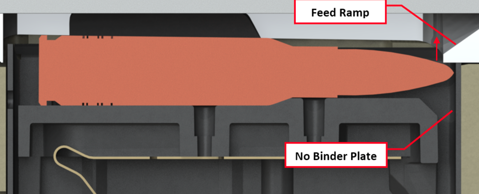

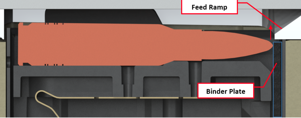

Someone school me on what exactly the binder plate is for? Is it for shorter rounds?
Its a spacer that keeps your round back in the mag so that they dont catch under the feed ramp of your action. MDT has some good images.
Binder plate keeping the rounds back
7046394
Binder plate removed and now the round can catch under the action.
7046395

Im sure there is some merit to that but in all the situations Ive seen the topic raised in its mainly for action and cartridge length compatibility.
If you want to run the rounds as long as possible you need that physical space available to you by deleting the binder plate. However if you do that then you need to make sure that they are able to rise up into your action by choosing an action with a mag well large enough to accommodate the length or to notch the action in order to make it so.
