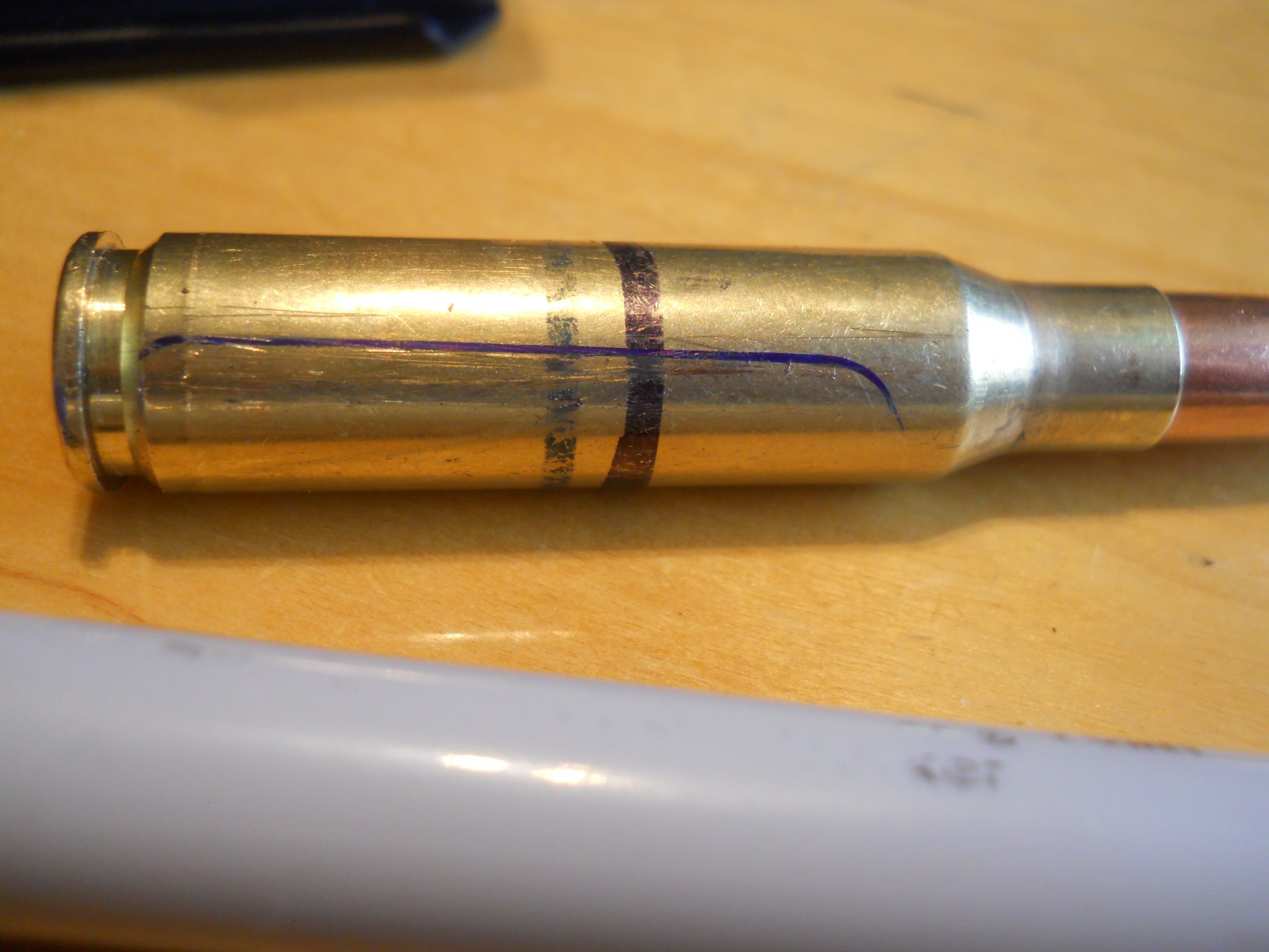

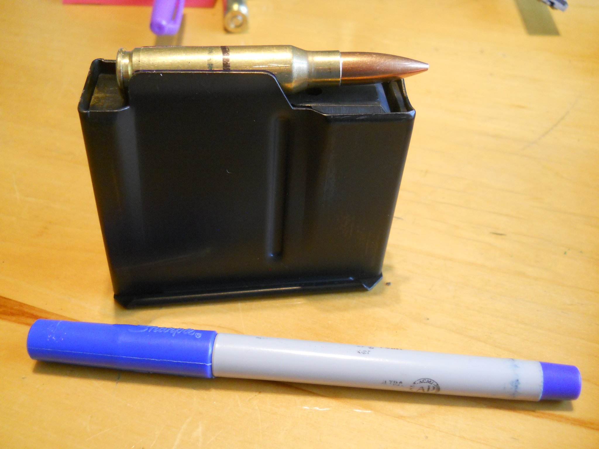

So I measured the feed lip opening on a new magazine. The measurments revealed the front opening a few thosuands wider than the rear to raise the tip of the cartridge.
It was easier to make a gauge from a cartridge:

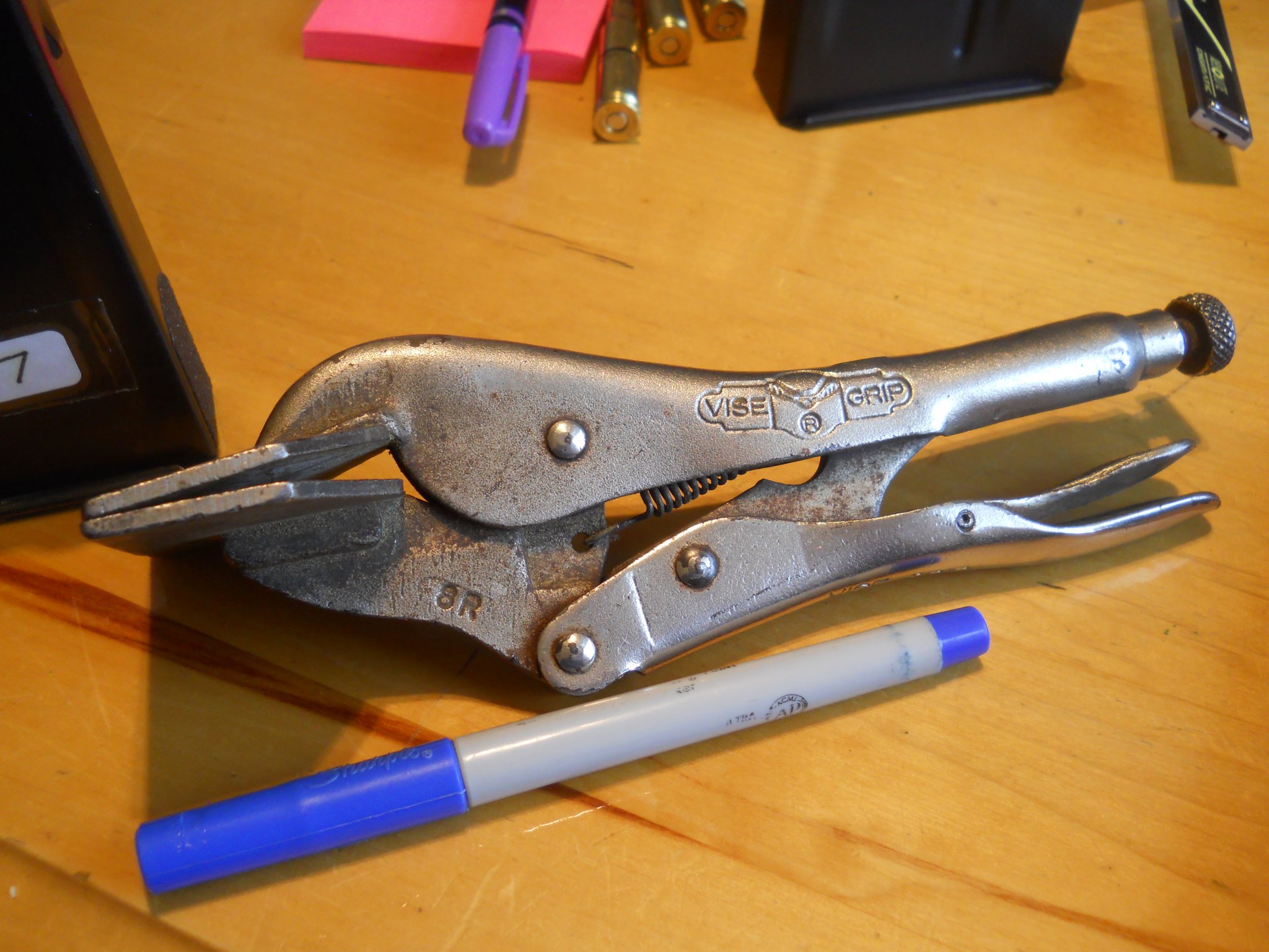

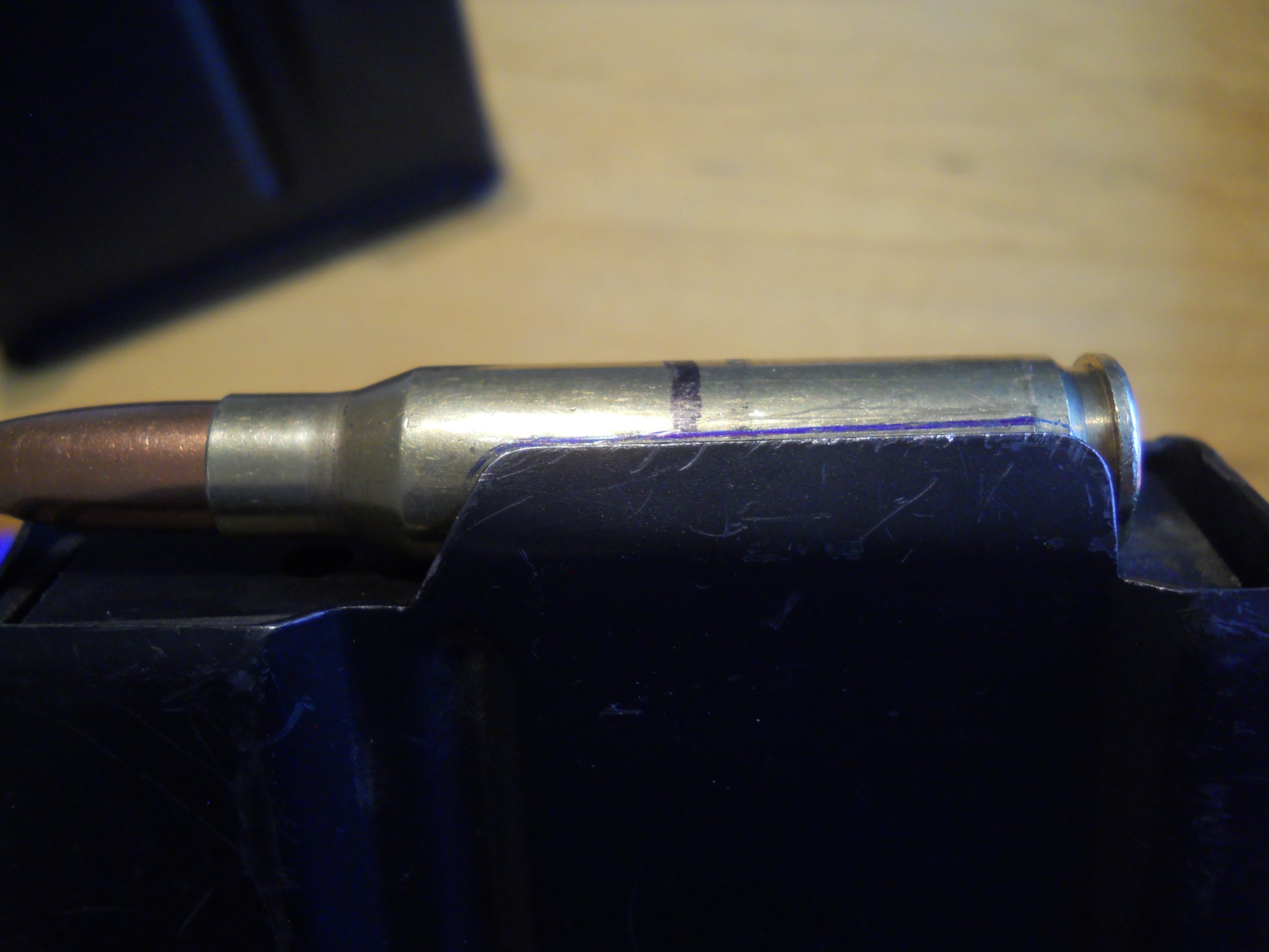

I placed the "gauge" in my other mags and tuned the opening as required:
Not the most elegant method.
