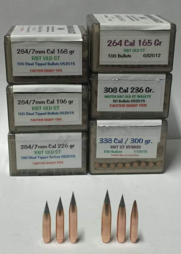

    Good morning,
    With the introduction of the Hornady A-Tip rounds, and there being no choices for 7mm....
    I had been eyeballing the Alco 7mm offerings for a few months and decided decided to order some 168 grain aluminum tip, rebated boat tail bullets. I was able to order them on 4/30 and received them on 5/3. Customer service was absolutely top notch and the folks at Alco are absolutely wonderful to work with. I will order more likely based solely on that experience.
    Here are the bullets:
    Info on the website says they are 1.5" long, I measured 10 out of the 100 I ordered, and the average was 1.533. Weights were 168 +/- 0.1gr. The bearing surface length was .7"
    I'm going to pair these with my Atlas Development Group brass for my 7mm RemMag.

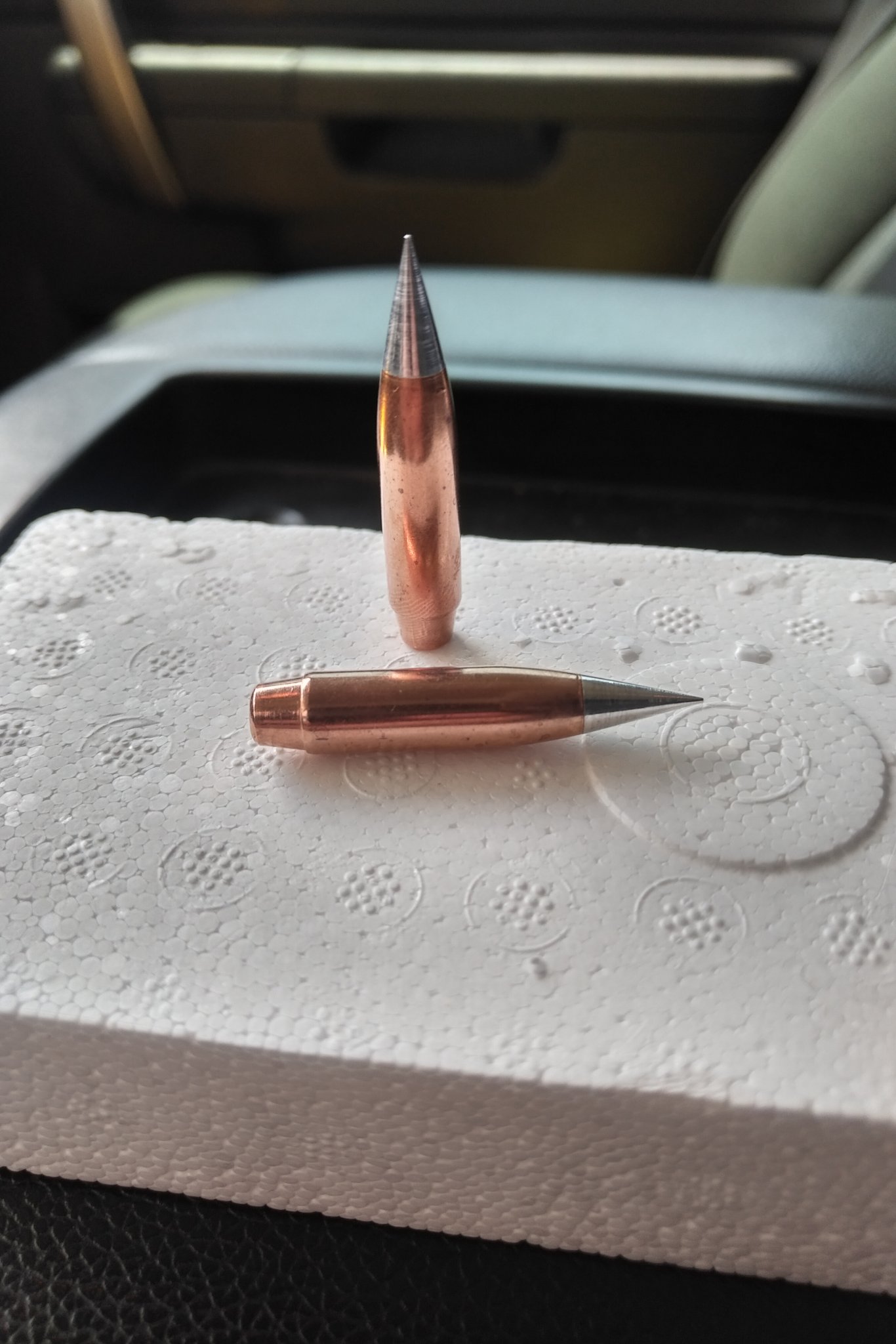

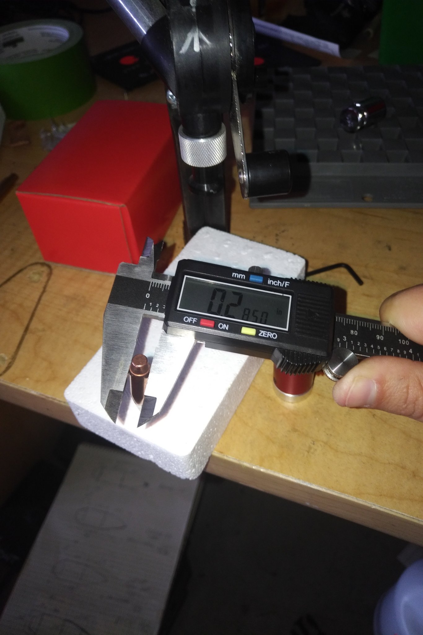

    Was doing some more measurements of these fancy things..
    Where the bearing surface meets the Ogive, the diameter is .2845. Where the bearing surface meets the rebated area the diameter is .285.
    It measured the same on 10 different randomly picked rounds.
