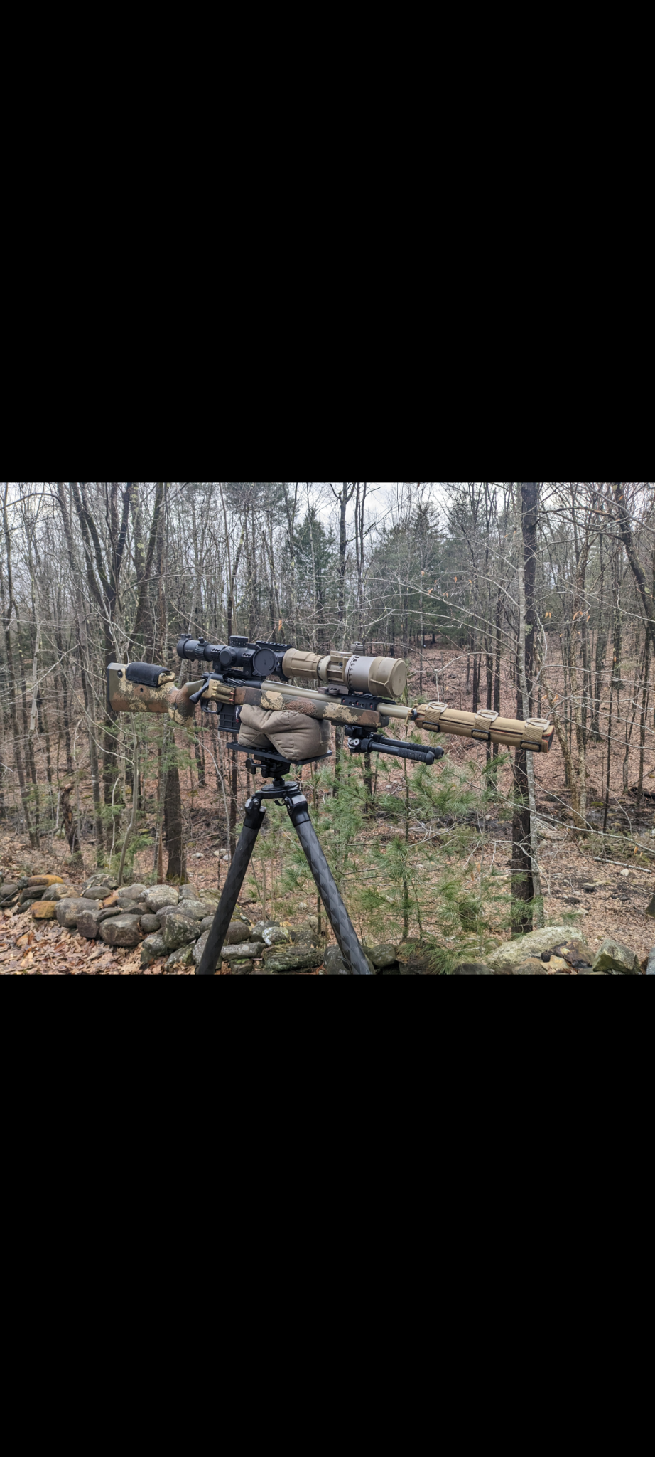

If you do reload, 223 Ackley Improved has not (IMH experience) been a "barrel burner".
I'm launching 80 GR VLD's at 2750 fps with fantastic results down range. Due to the weight of the rifle (heavy barrel, supressor, HS M24 adjustable stock), there is almost zero recoil. It's on par with my Bergara 22LR as far as felt recoil. Good to 850 yards verified and I am sure I can get the actual DOPE even farther but have not tried. There are guys here that do.
Otherwise, the WYLDE chambering would be my preference.
Lots of guys get great accuracy from factory loads and I am not trying to throw any shade there but I have been able to shrink the cone of precision (or is it accuracy) in every rifle by tuning the load to the rifle. There are also the various barrel tuners but I have exactly zero experience there.

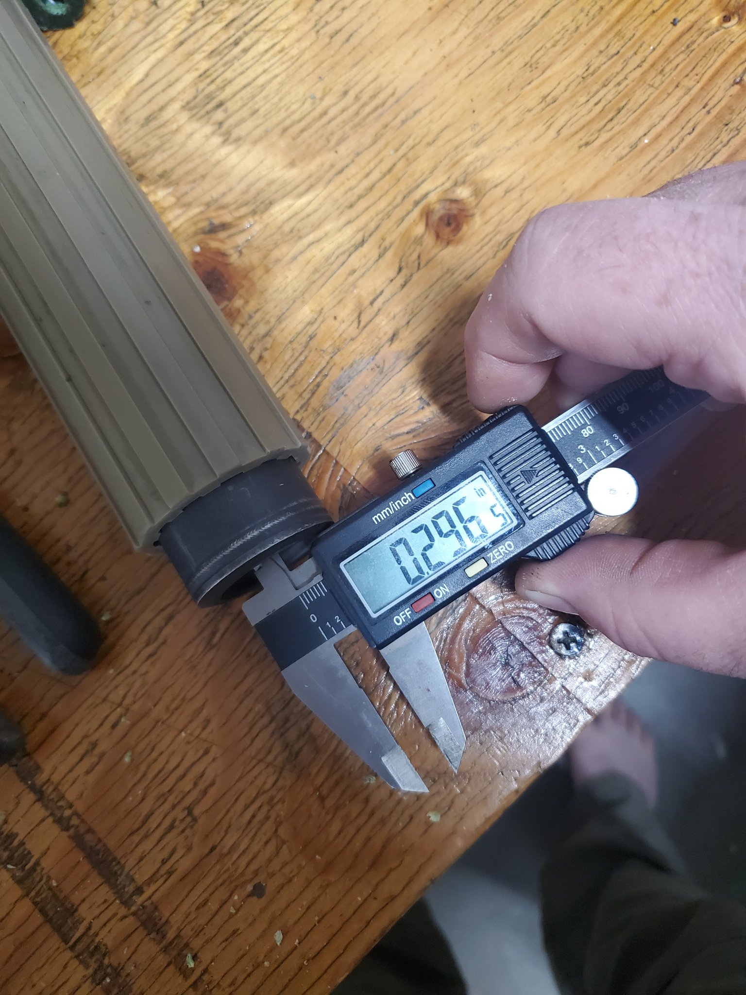

I bet a lot of .224 cans could fit a .243 bullet down their bore.
Depends who made it and how much runout the barrel and mount have. I think OPS Inc used .260 bores, the brakes are tighter. YHM uses a .270'ish bore, SF is even larger. The hotter you get the bore the more likely you'll get a baffle strike. Generally you need minimum .040" clearance, and that is considered really tight.
I can tell you with certainty .308 doesn't fit through a 6.5 brake. It gets worse when you put a .30 silencer on the 6.5 brake with the 308 bullets.
