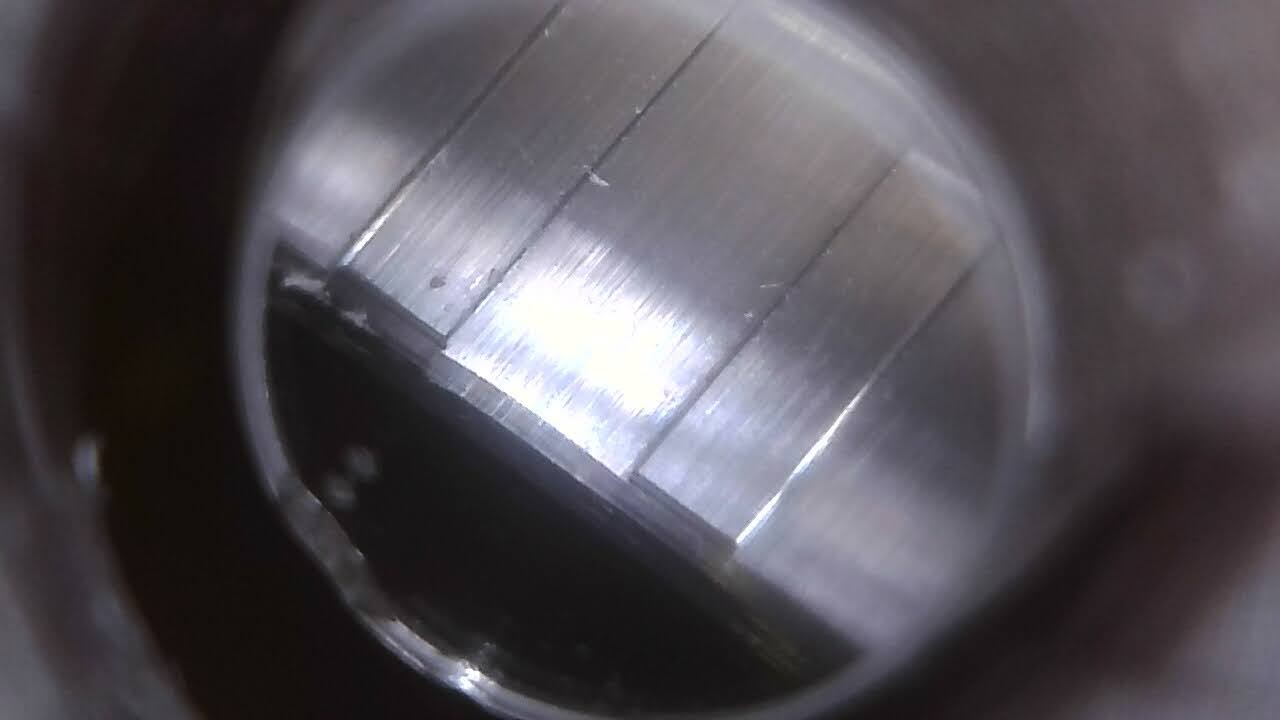

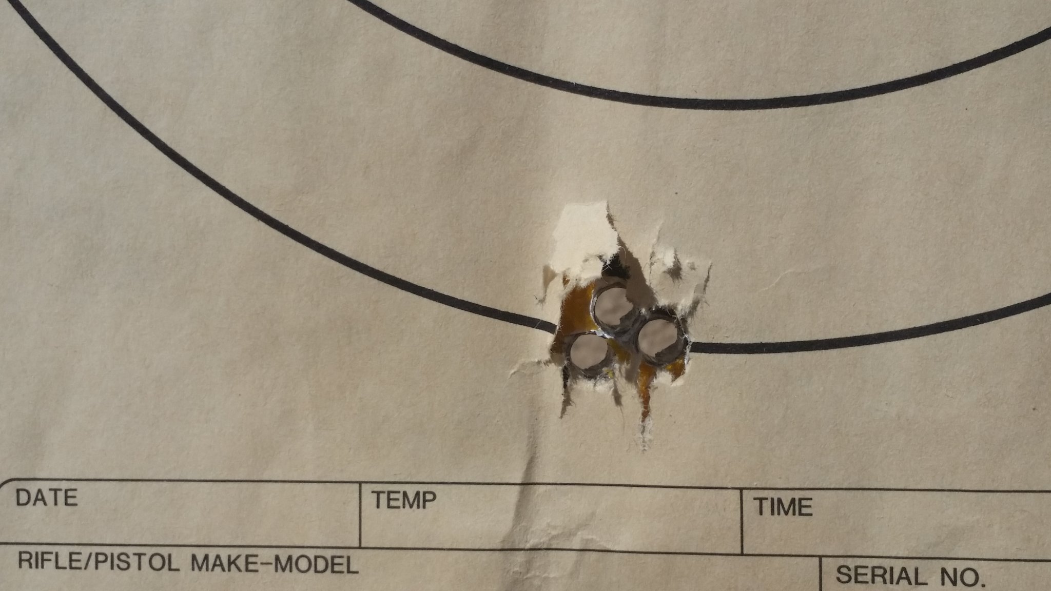

I've had lots of barrels in that length range.
One of the best shooters I've had is a FN 14.7" 1:7 CHF chrome lined.
Lights out was how it shot almost everything.
3/8"-1/2" was the norm and it loved cheapo Fiocchi 223A.

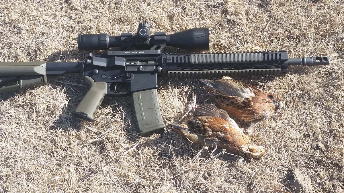

Try shooting quail on the wing with a scoped AR, it's possible, it just ain't easy.

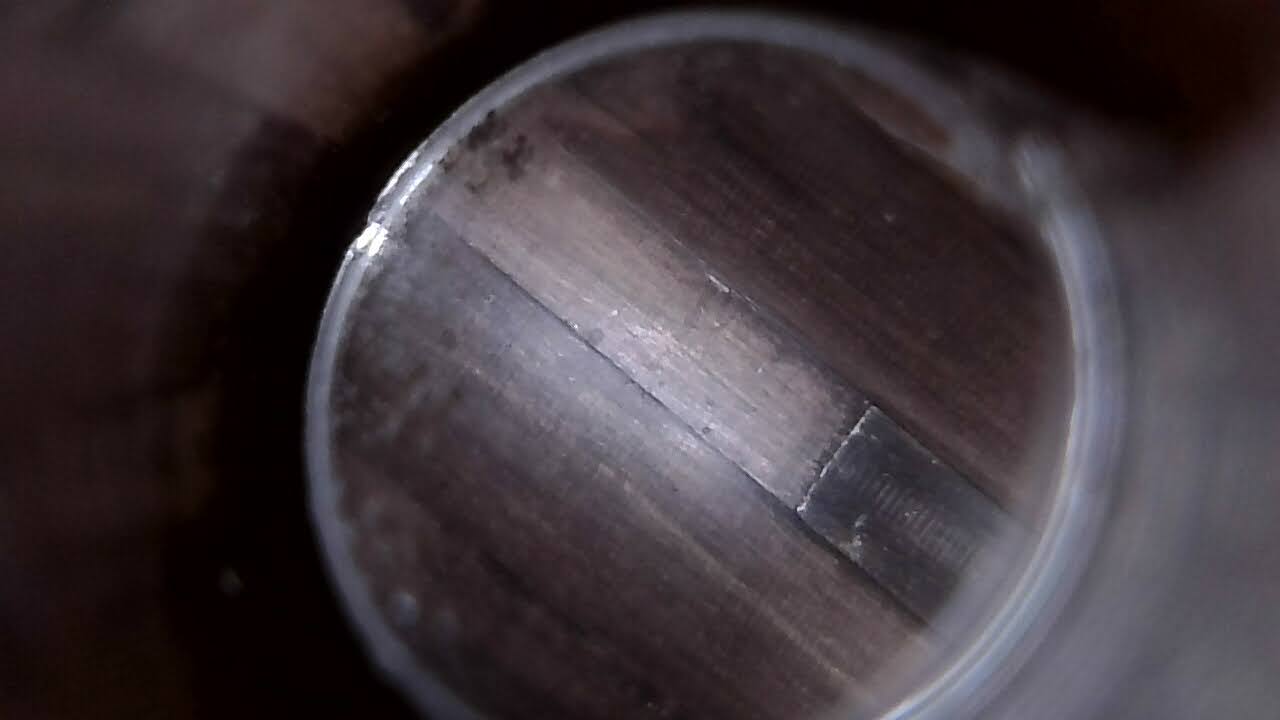

Criterion's chrome lined barrels are done with more uniformity that the average cl barrels done by xyz. I had an 18" .308 gas gun barrel that shot very well. If they have the contour you want I would not hesitate to go with a Criterion.
...Criterion states they lap the barrels before chrome lining. IMHO that can't help but improve on the accuracy potential of their CL tubes.

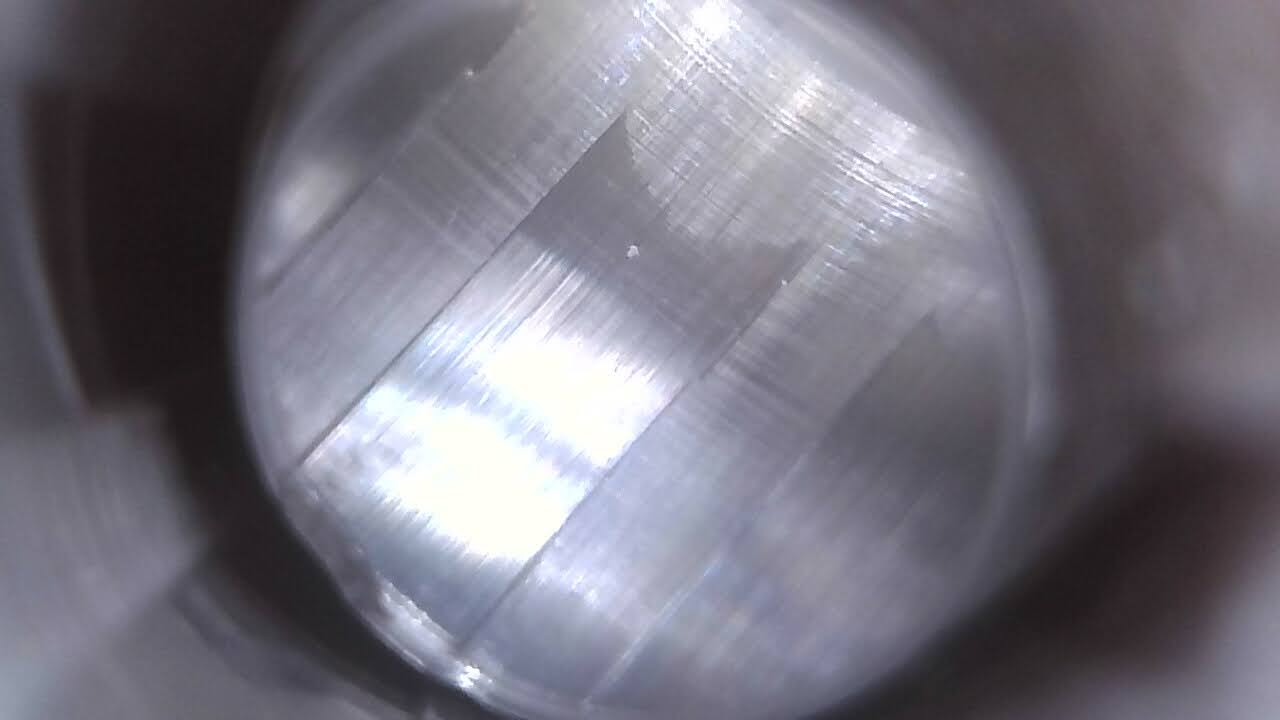

Ballistic advantage has gone to shit. I have had 2 bad barrels in the last year from them. This pic below is how the throats are coming in their 223 wylde barrels right now. I am the 4th person I have seen that has got a barrel like this. This is mine. The ledge is all the way around the throat.
And the bore and groove is oversized on mine. I was able to push a slug right through the barrel with no effort. I shoot lots of cast bullets in my rifles. I wanted to see what the bore and grove was to be able to size the bullet to what I needed. After that I asked for a replacement. I have not shot the new one yet as I was pissed off and ordered a WOA fluted SPR barrel. I put that on today.
Here is the WOA.
