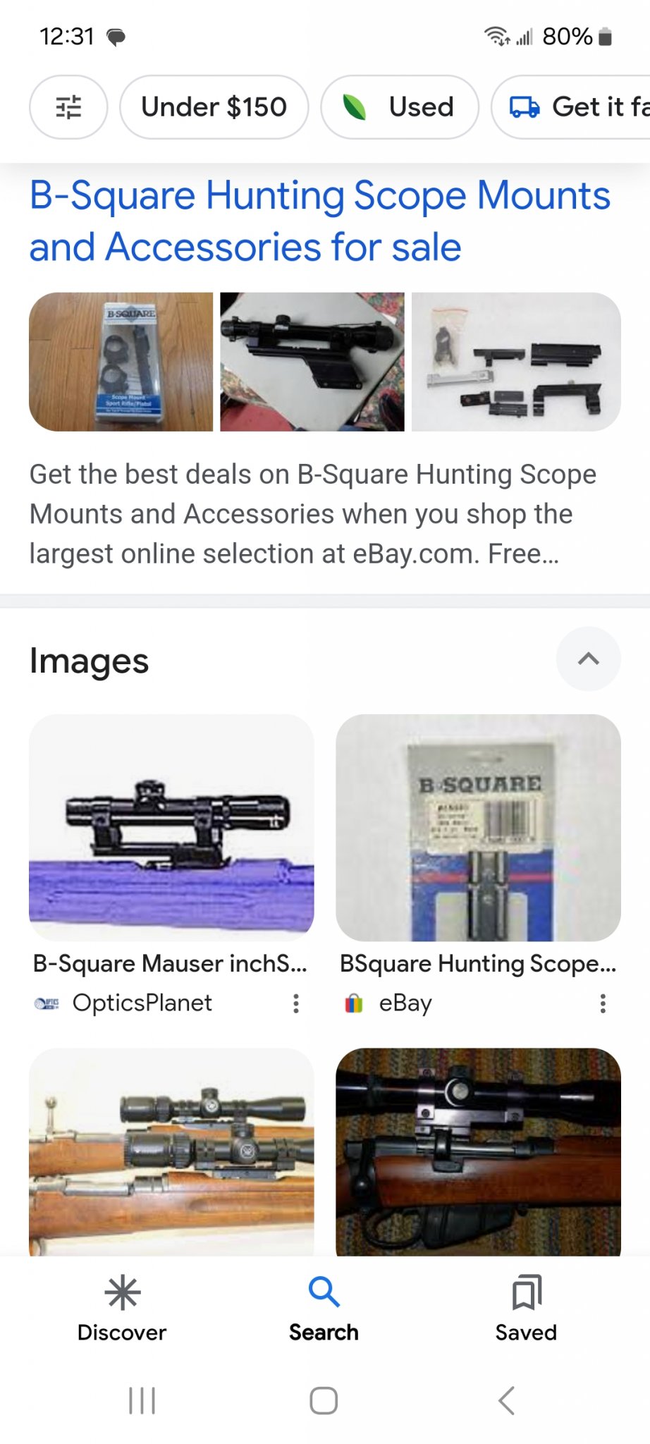

Maybe try B-Square.
No scope, just a sight base for irons. I think I’ll just drill and tap with epoxy. It’s just a fun project, nothing serious.
