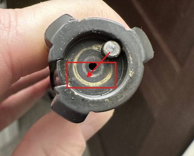

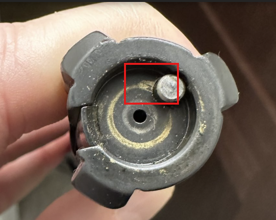

2. Try shooting with the ejector spring removed but the ejector in place. Any debris in the ejector hole? Can you push the ejector down below the face of the bolt? The part with the red is showing that the brass is flowing into the ejector hole or there could be a burr catching the brass. The opposite side of the bolt face shows more brass markings which could mean the ejector spring is pushing the case hard. Try a lighter ejector spring. Erniethegunsmith sells the lighter springs, flings the brass out just not 3' away.
After removing the ejector run the tip of a paper clip across and around the ejector hole, do you feel any burrs?

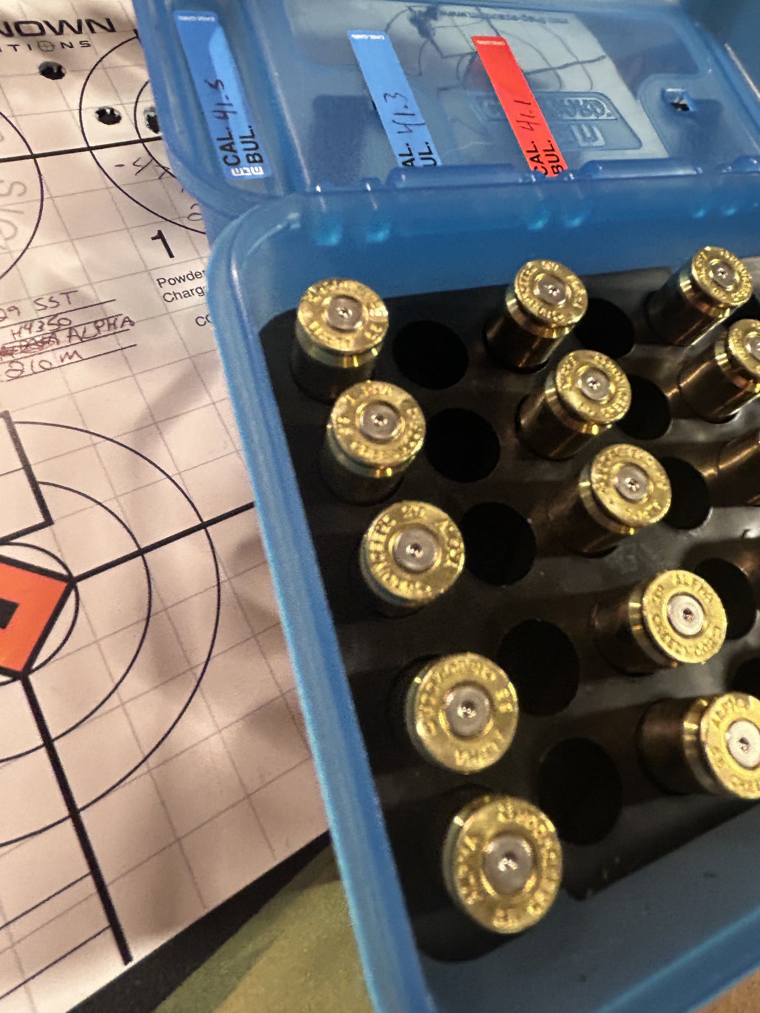

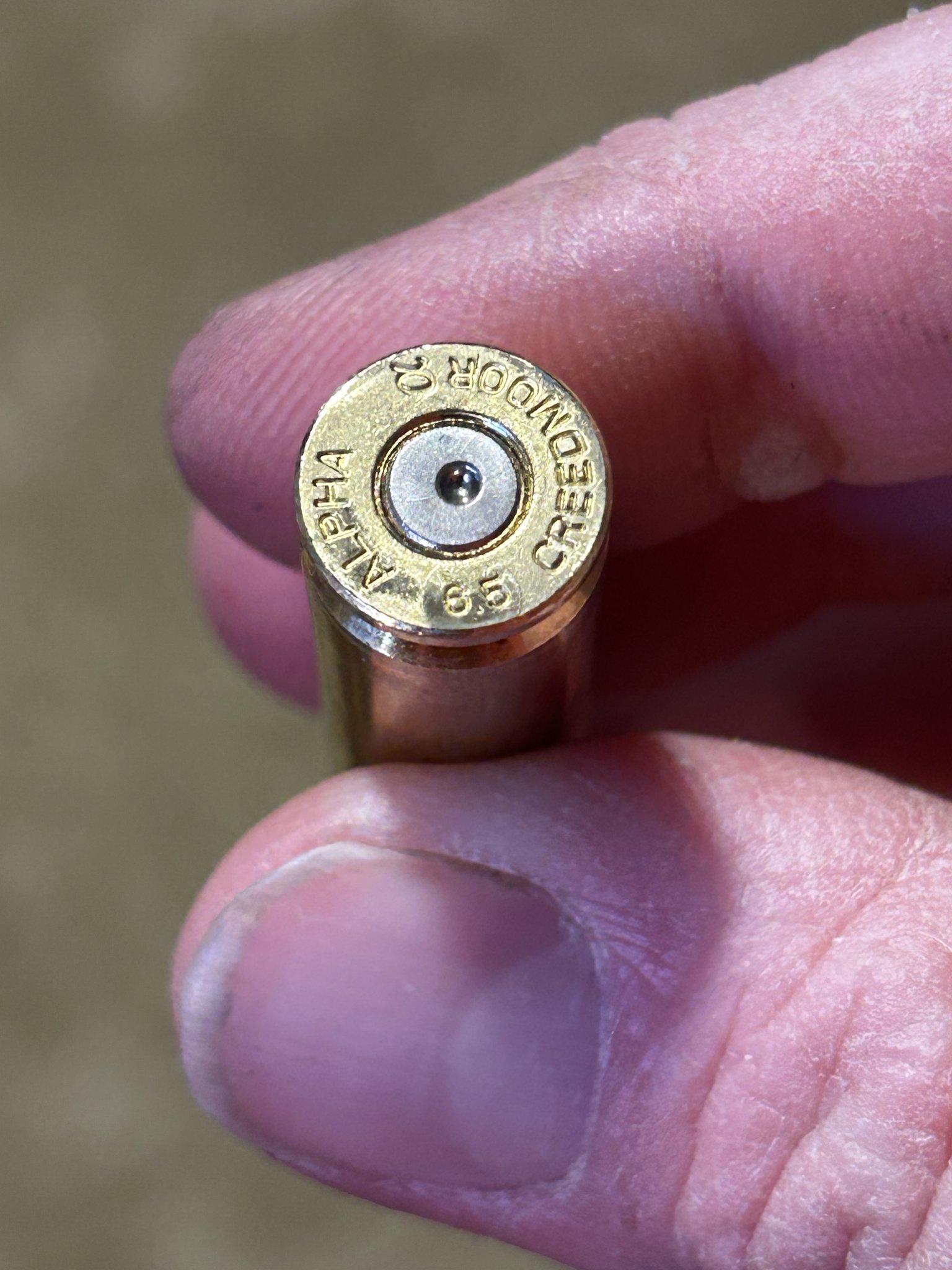

Sent you a PM. I have the same issue with a 6.5 creed Bart spun for a Zeus QC. I’m running alpha brass however. Inconsistent pressure after 30 shots or so. Hard bolt lifts and ejector marks.
Edit:
I have run both federal, and Winchester factory ammo through the rifle and did not get any pressure signs. I’m shooting
129 SST
41.5 grn of H4350
Alpha Brass chamfered and deburred
.262 21st century mandrel
Pressure signs popped up and I deep cleaned and scrubbed the bore. Ran another 50 through with no pressure signs.
Average velocity
2777 over 25 shots
2797 over 15 shots
The 2 groups were shot on 2 different range days. 15 degree temp difference on the days the groups were shot.
Edit:
129 SST
41.5 grn of H4350
Average velocity
2777 over 25 shots
2797 over 15 shots

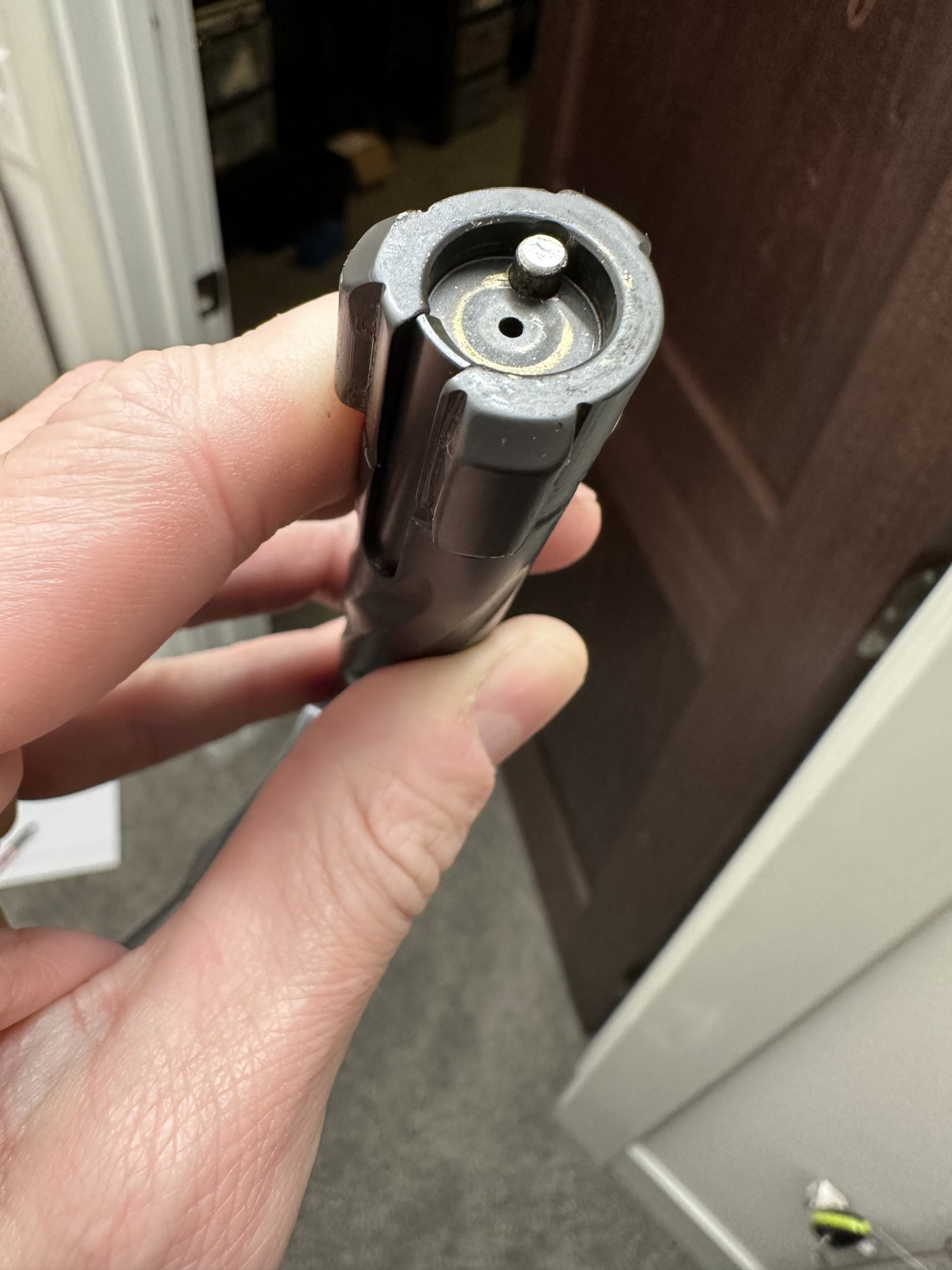

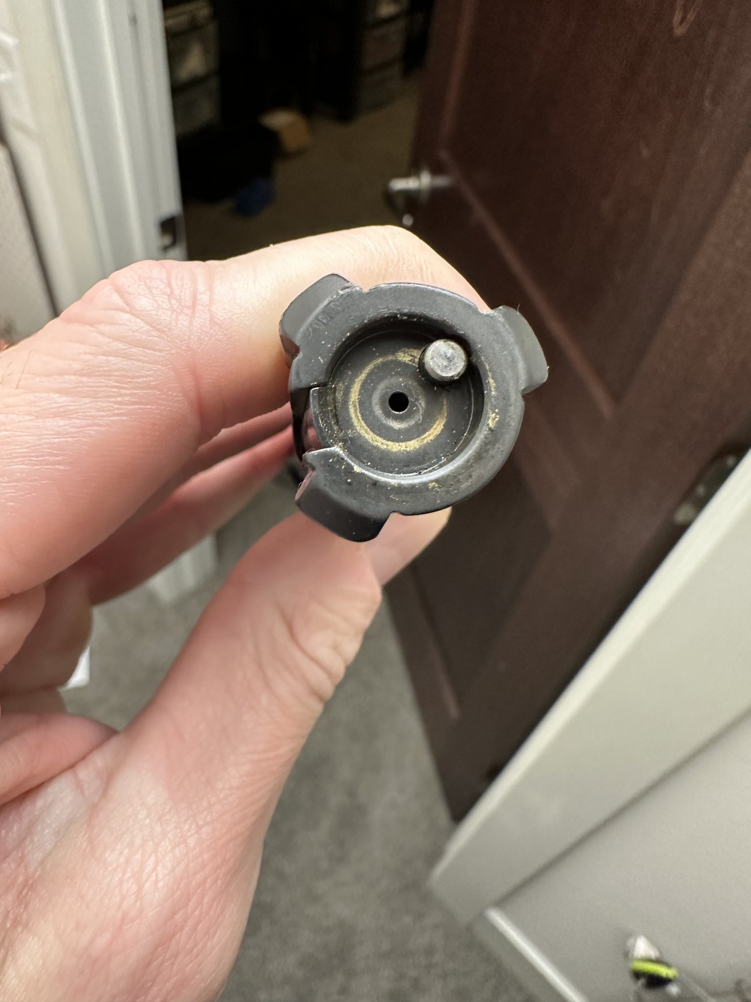

Really appreciate the reply. I also attached a couple pictures of the bolt face. After preparing the bolt like you mentioned except that I wasn’t able to get the extractor out. This was all done without cleaning, barrel is still as seen in pics.

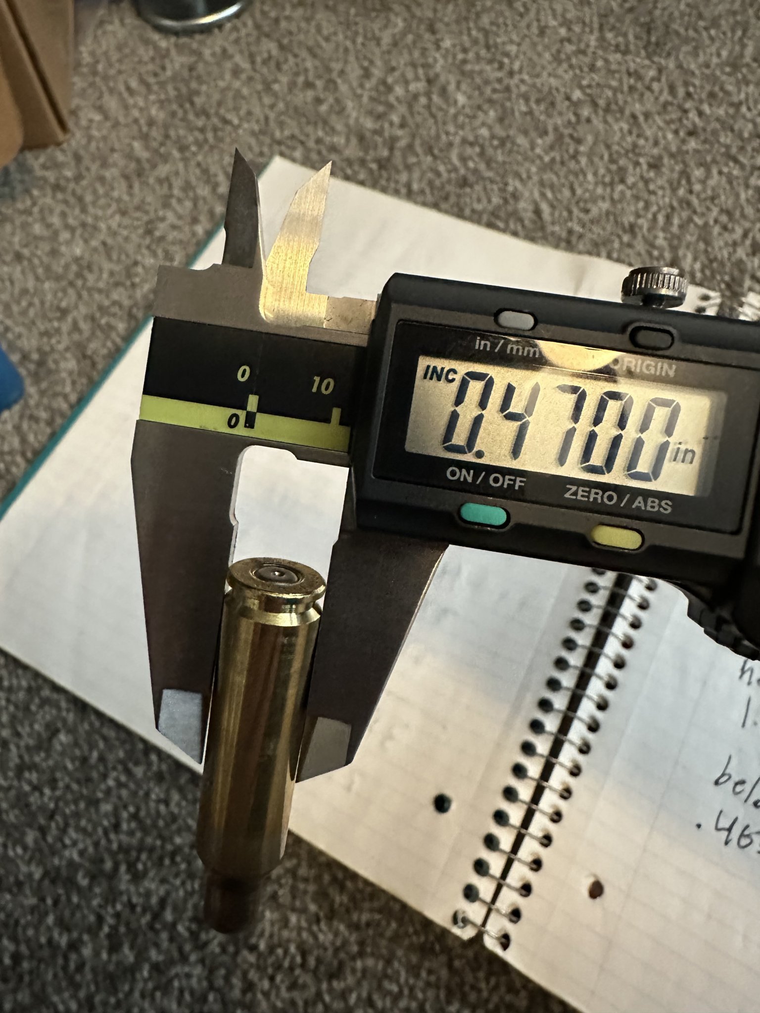

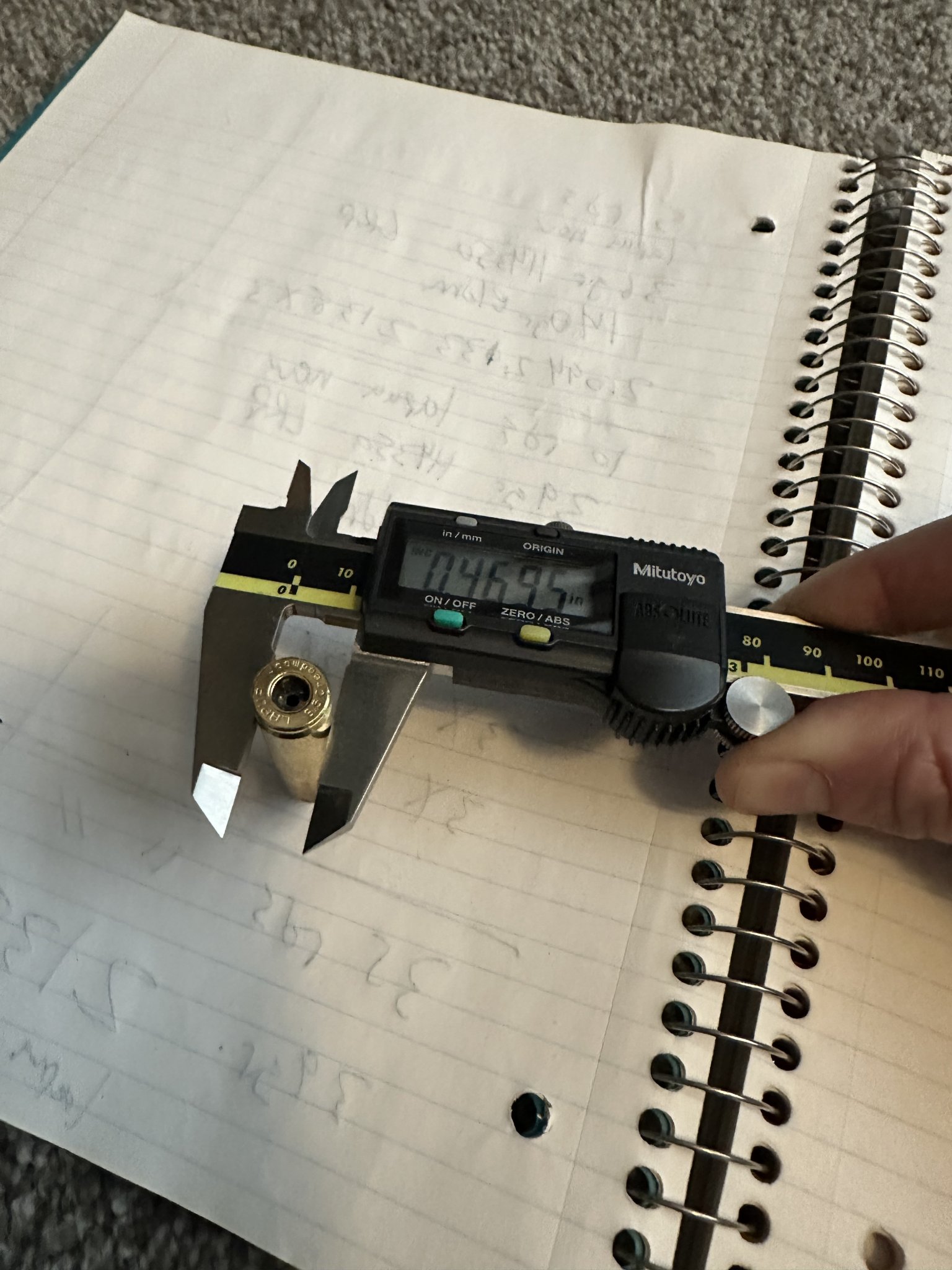

- .200 line with fired unsized brass - there seems to be some variance here. I measured a bunch of them and .4695 is what I’m getting on most of the rounds that DIDN’T have heavy bolt lift, but the ones that DID have heavy bolts lift seem to be .4685. (hopefully I’m taking this measurement accurately, included a picture of what I did). If I measure with the case parallel to and between the end of the caliper like in the second picture they all measure .470.

What I’m noticing is that your “problem” cases didn’t expand at the .200” line. They over expanded in length causing bolt thrust. I’m aware of something similar happening a few years ago with a different cartridge that was caused by brass being too hard. The issue in this situation was solved by firing the cases a few times until they expanded to grip the chamber.
