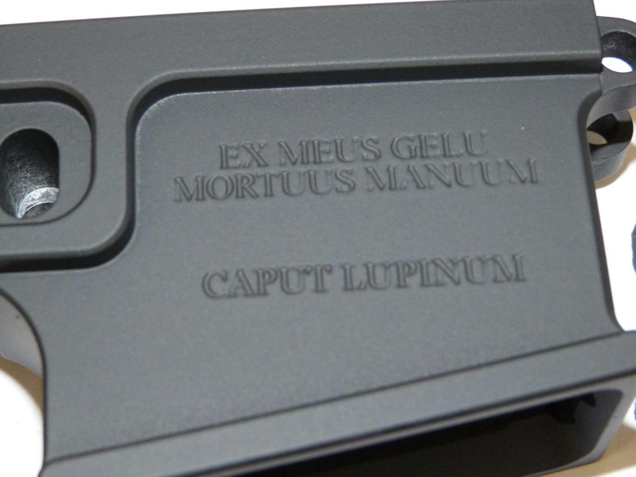

Oh you will love my homage/roll mark on my 80% lowers then...
To be fair, I have a Mid 90s Cincinnati Vertical Machining Center in my shop, so this kind of stuff is relatively easy.

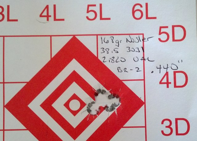

I finally got out to shoot some of my reloads today and thought I'd post an update. Only things I did to the rifle were polish the crown with a brass lapping tool with some silicon carbide abrasive and adjust the torque on the action screws (went from 65 in lbs on both to 45 in lbs front and 25 rear).
For the loads, I used some of the same bullets I had and seated them a little longer than previous loads. I also left the Lead Sled at home and shot off of bags.
I was very happy with my results. I went through 9 different loads. All groups are 5 shots at 100 yds. All of them were under an inch, and the 3 below are the best of the 9. The ones loaded to 2.875 are too long to cycle from the magazine, but the other 2 are good. Too many variables to attribute the improvement to one thing, but I think it's a keeper.

That is pretty decent accuracy for not having the crown precisely cut. I always look at it this way...the crown is the last thing the bullet touches before it leaves the barrel. Any imperfections there are going to hinder the accuracy for a rifle. There are exceptions to every rule....but when I get a rifle that won't shoot...first thing I check is the bedding...if the barrel is free floated the second thing I check is the crown. Blue printed actions are nice and well cut chambers are important...but the crown is the last thing the bullet touches on the way out.
You should have stated that you were shooting off of a lead sled in your first post. I'm almost positive (from my experience) that it's impossible to shoot under .75-1" groups off of them. Now that you know you have a good load, and the rifle is shooting well, take the lead sled back out and report how it groups. I'd put a paycheck on it that your groups open back up.
You are welcome. I know the crown is important, but may be not to the extent that I was always told. I manly hunt and have always been really careful and particular about the crown, probably still will but now I have different evidence to think about.
All the talk about crowns got me wondering if I was missing out on additional accuracy with this rifle, so I decided to have the crown re-cut on a lathe by a "real" gunsmith. It definitely looks better than my attempt, however now I have some marks in the finish where I assume the barrel was making contact with the jaws in the chuck. No biggie as I plan to Cerakote the entire barreled action anyway. I took it out to the range this morning for a checkout with the same hand loads as my last go round. Shot off of front and rear bags. I shot 6 strings of 5 shot groups. Best group was .440" and the rest were .485", .490", .515", .535", and .735". I shot the smallest group on the second string. Hardly scientific, but I believe the hand cut crown was "good enough" and this is at best a .5 MOA rifle in my hands.
