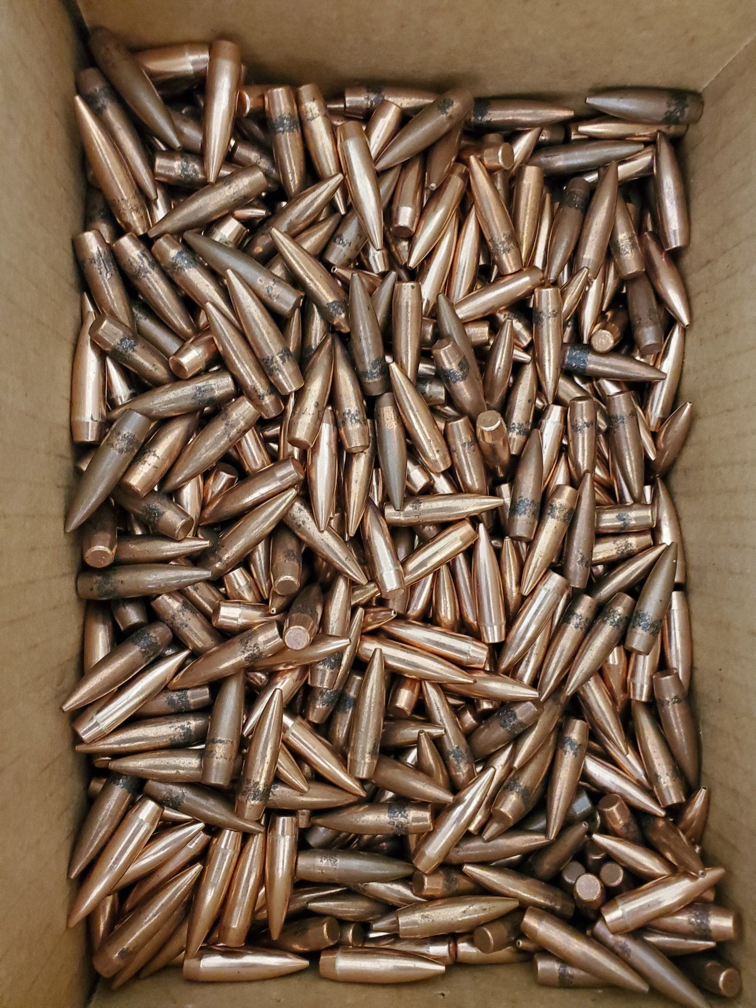

I placed my order for some of that 846 powder. They also had the pulldown sierras on sale. 175 SMKs for 19 cents a piece. I said screw it and ordered 500.
Shipping and haz are free there, so maybe I can work a load up with that powder for plinking in 223 and 308.
If I don't like it for 308, back to IMR4064 I go.
Figured if anyone needs some plinking loads or other practice loads, that's a good place to start.

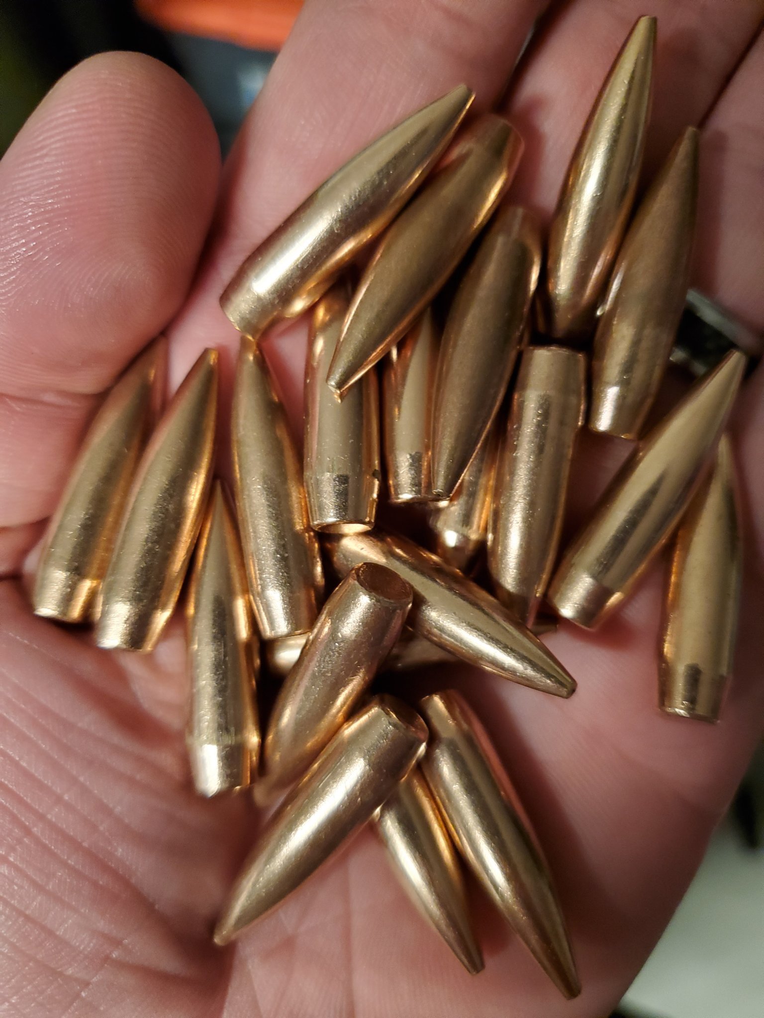

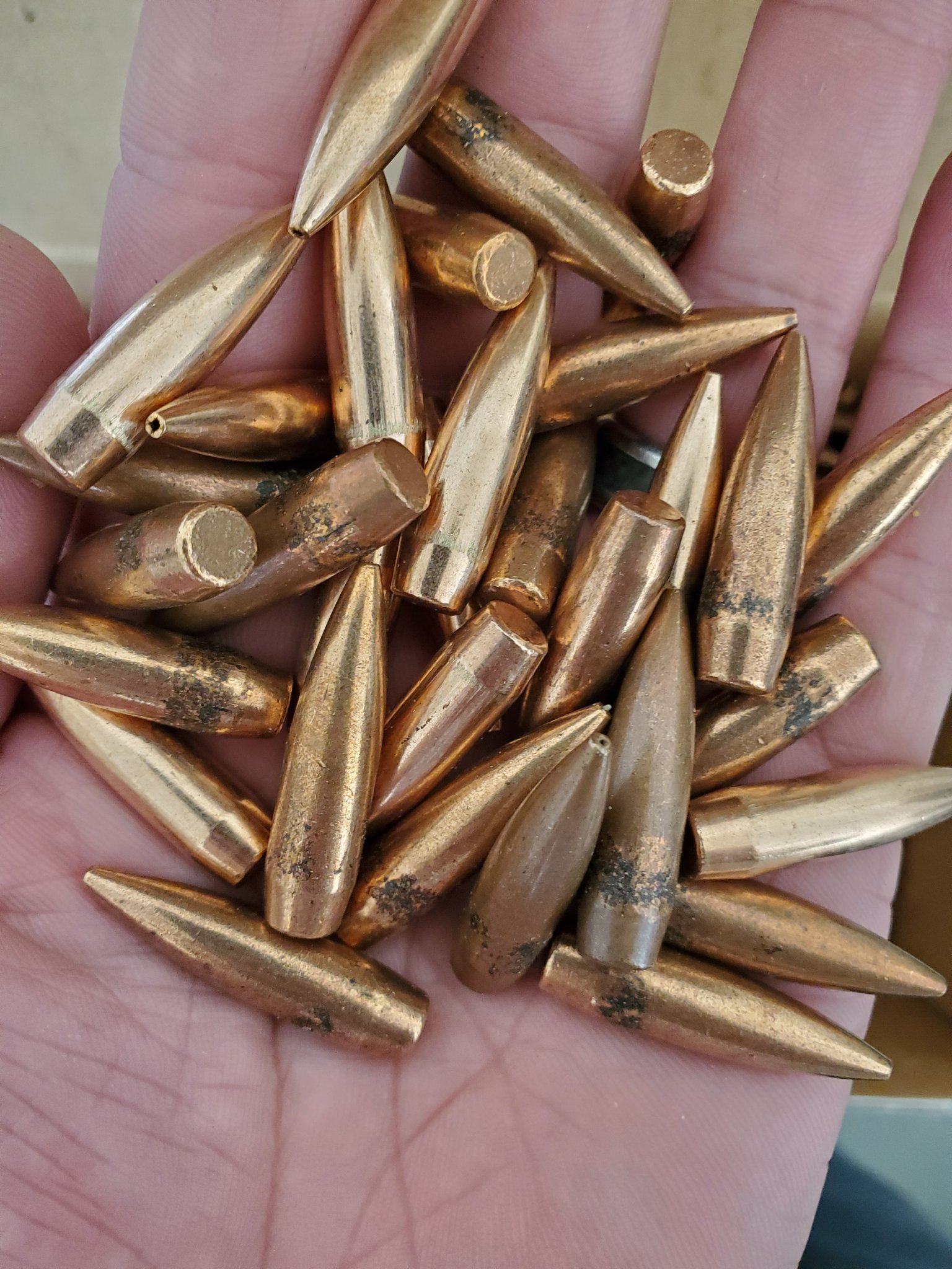

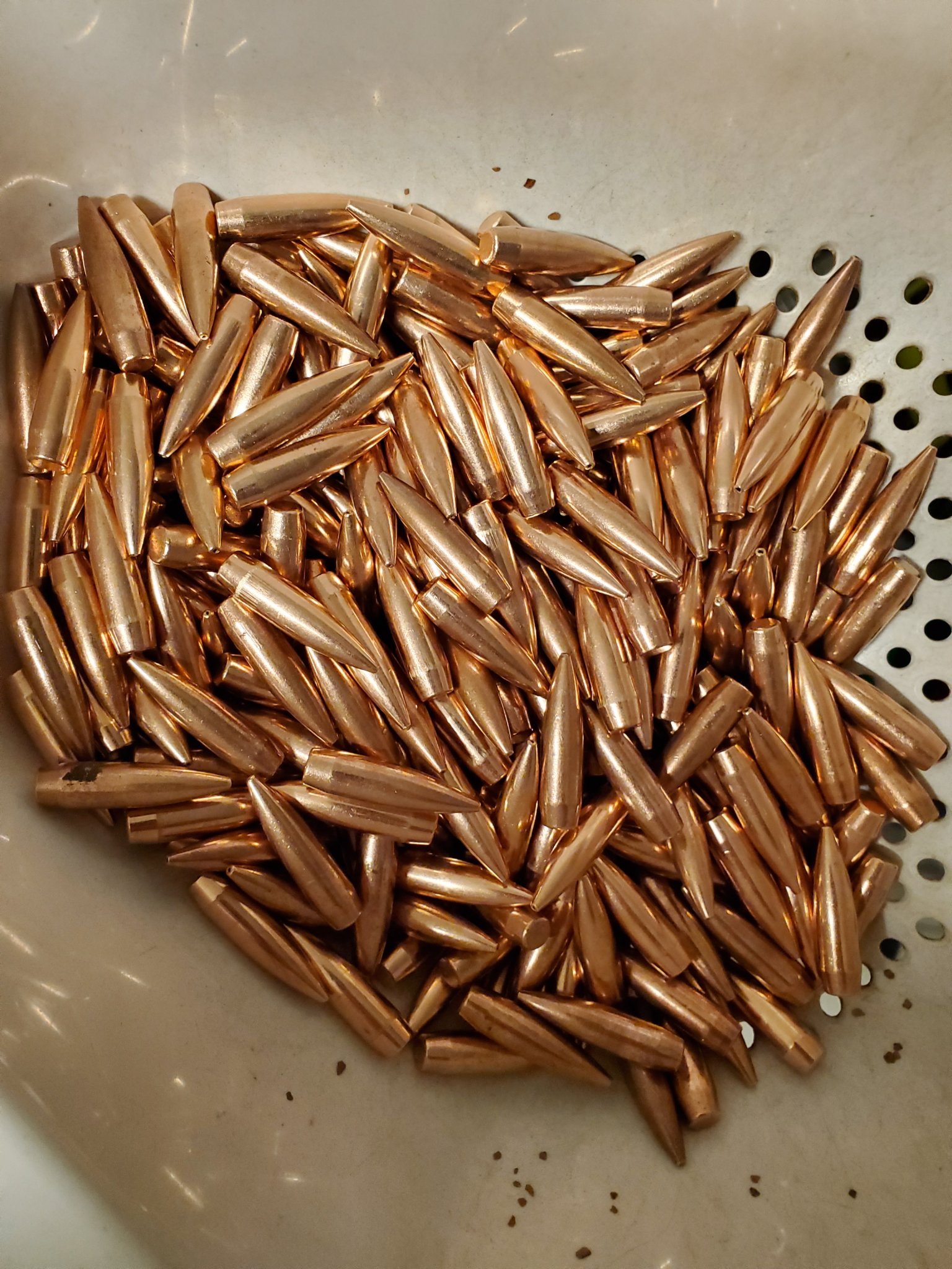

So I got the powder and bullets today. The bullets were as described and as I imagined. There was some sealant on some, and some were a few shades dark with tarnish. I figured I should clean em up a bit. Me being lazy, I threw em in my tumbler with some walnut media and nufinish. They came out pretty decent actually. There are very minor surface imperfections on them. I'm not too worried abou it. Going to measure and compare them to another batch of brand new sierras.
As received:
After 30 minutes in the tumbler:
All in all, I'm not going to complain. For like 19 cents a round, it could be much worse.
You expect them to perform any differently than standard SMKs?
Being pulled, yes. There is some deformation of the meplats on most of them. Not sure how that will effect it. And a few had pretty good dings in the sides, which I'm less concerned about.

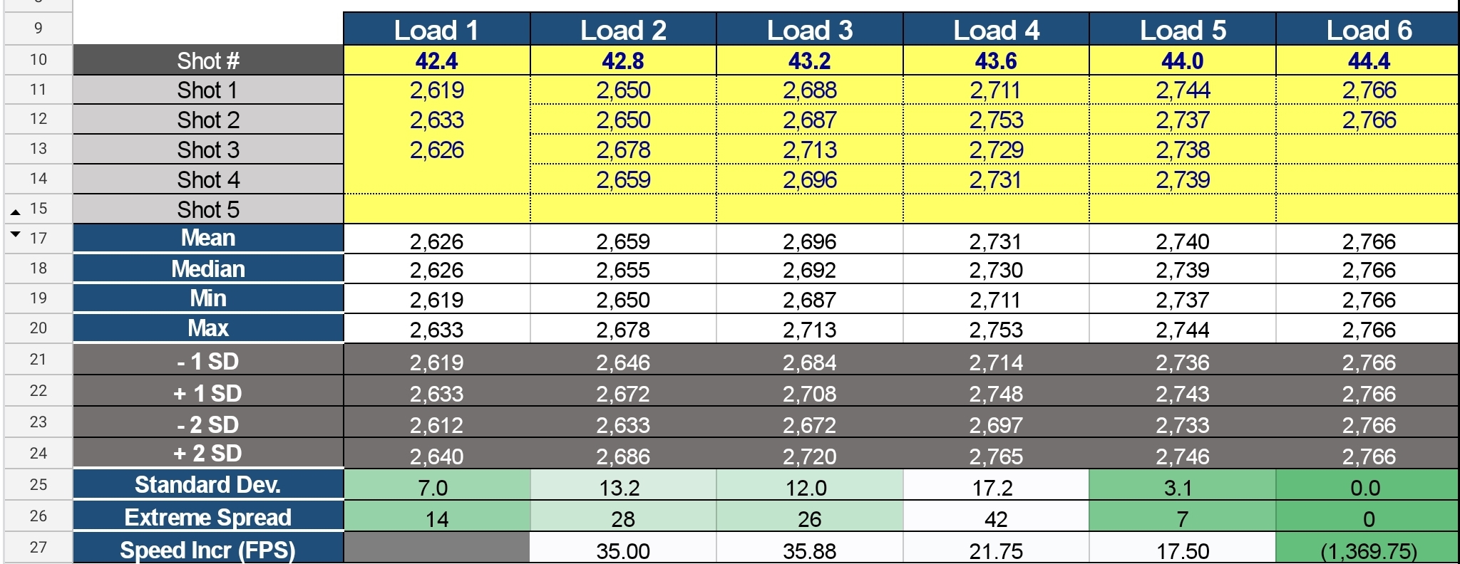

Factory howa 1500 in 308. Barrel has about 1k rounds. The brass is a 1x jag case, powder is WC846. Sized in a Lee FL die, though I now have a forster FL die.
The loads with less than 4 readings were errors on the chrono. It was picking up the shooter next to me. I really wish I figured that out before I finished this string of velocity tests. I looks like I'll stick with 44.0 gr of WC846. I know that one group of 4 charges does not a statistic make. But due to my quantity of once fired, I tried to get the most data over the widest acceptable range of, what I hoped would be adequate, velocities I could.
175 nosler Custom Comp
CCI 200
CBTO 2.270
Jag 308 1x fired (first firing was with 42.0gr of 846, since I wanted to hit it with a relatively safe load).
After the first firing, and after every firing, I anneal the brass. No hard bolt lift or other pressure signs at all in the charges up to 44.4gr. Previously I had a primer blow out at 45gr, so 44.4 was as high as I was willing to go. I'm happy with the velocity at 44.0gr, I just need to play with seating depth a bit because the group wasn't what I was hoping for, going to see if that will help at all. Hopefully I don't lose too much on that extreme spread. I'd really like to keep it below 15.
Hopefully I don't have to do too much new load workup when I switch to the Sierra 175s.
Any input to help improve results is welcome.
