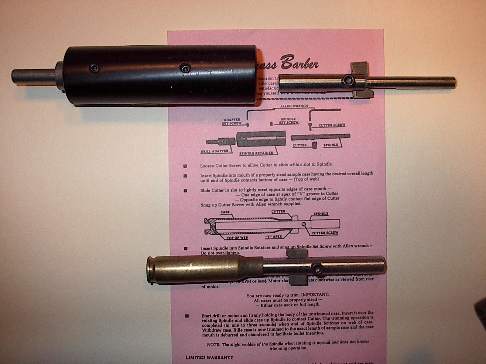

i have a rcbs hand primer i am selling
i'm old .i like this one
the info on where to buy this is:
Monadnock Machine
Raymond Simard
45 Cobb Meadow Rd
Dublin, NH 03444
Dear Ray,
Enclosed are the two pieces of brass. One is fired from my new rifle, and one is brand new brass untouched.
Please make me a new monadnock cutting tool with the spindle. I already have the interchangeable sleeve.
Enclosed is a check for $45.00 to include the shipping and handling.
The case is a 6.5 Grendel. Enclosed is a “print” of the case from my Sierra manual number 6 (2019 edition)
Thanks Ray, Always a pleasure to do business with you.
Sincerely,
Robert xxxxx
That is a carbide cutter and they last forever. I've been using these since 2002 or so when another Highpower shooter told me about them. Be SURE to buy the FINGER PROTECTOR sleeve, that will FIT all the tools you buy. I have a cutter for .223, 243, 25-06, 308, 6.5 Grendel and 6.5x284.
you might want to call him to be sure that the price is the same.
(603) 563-8359
Good Luck
Bob
