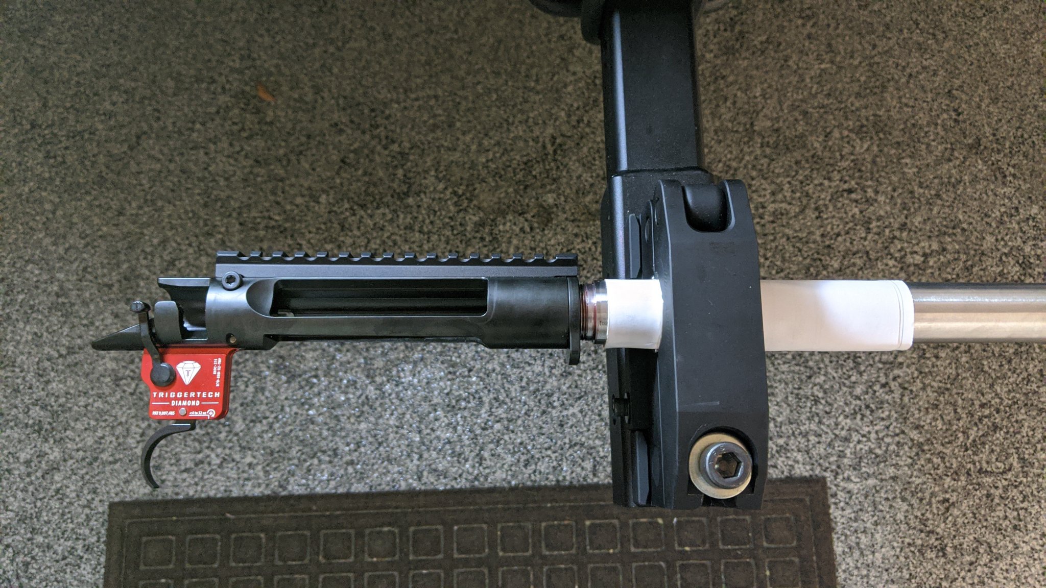

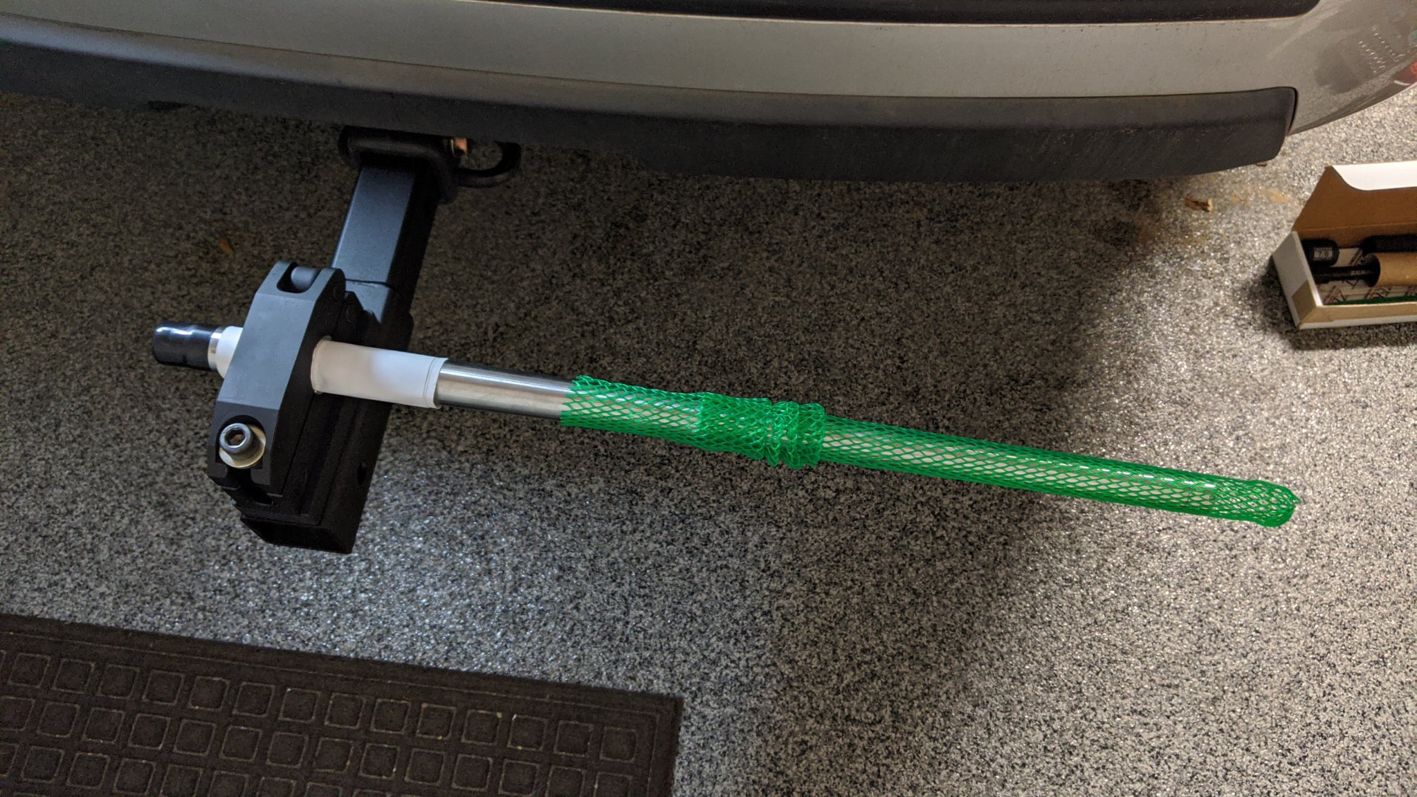

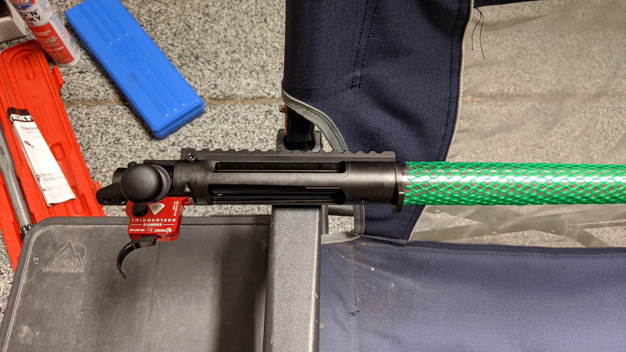

SAC Vise.
I would go with torquing the bbl, no bbl nut. Shouldered bbl, if to spec, would not necessarily need to check headspace after torquing to action. (You SHOULD FOR SAFETY, I usually don't). I use the SAC vise and it works great! Because i don't have enough workbench space, i purchased a 2" trailer hitch extension and attached my SAC vise to back of my SUV.
Shouldered bbl install/torque looks the best and cleanest.

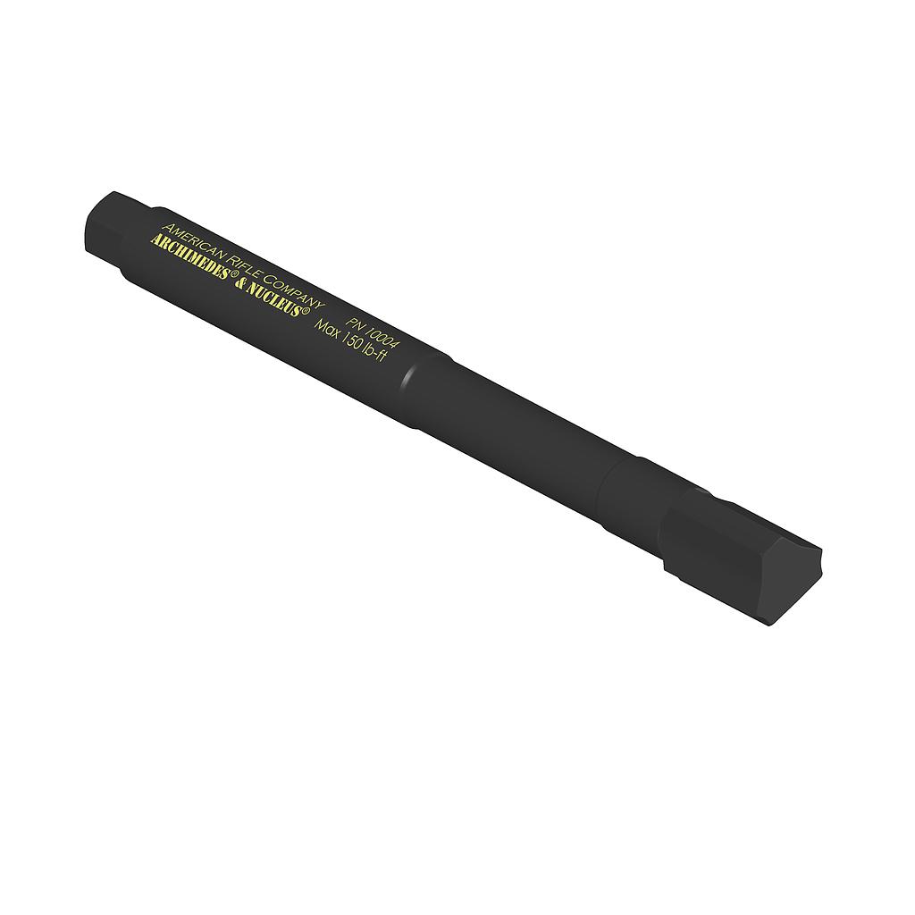

Silly question, I have my LA Nuke and I am trying to fit the action wrench. The one I picked up from ARC goes about a quarter of an inch in the back of the receiver and no further. Does it slide all the way in or that is it? Does this have to do with the mechanical ejector?
Yep, pretty sure you need to remove the ejector. Not sure where I remember reading it tho
You are correct. ARC beefed up the new action wrenches and new new ones require you to remove the ejector.
The old ones had a limit of 100 lbs-ft and the new ones are stronger (Max is now 150 lbs-ft)
