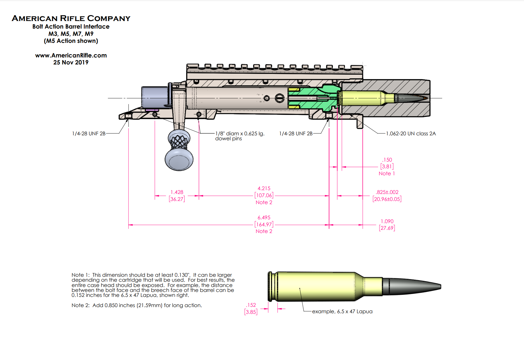

I might trade up my 1.1 for a Archimedes one of these days. Can I take my Krieger barrel and just spin it on a Archimedes ?
yup. I took a LRI shouldered barrel off my LA Mausingfield and put it on an LA Nuke, shot just as well.
You'll notice that their "Bolt Action Interface Drawing" on https://www.americanrifle.com/support is identical for all bolt actions.
