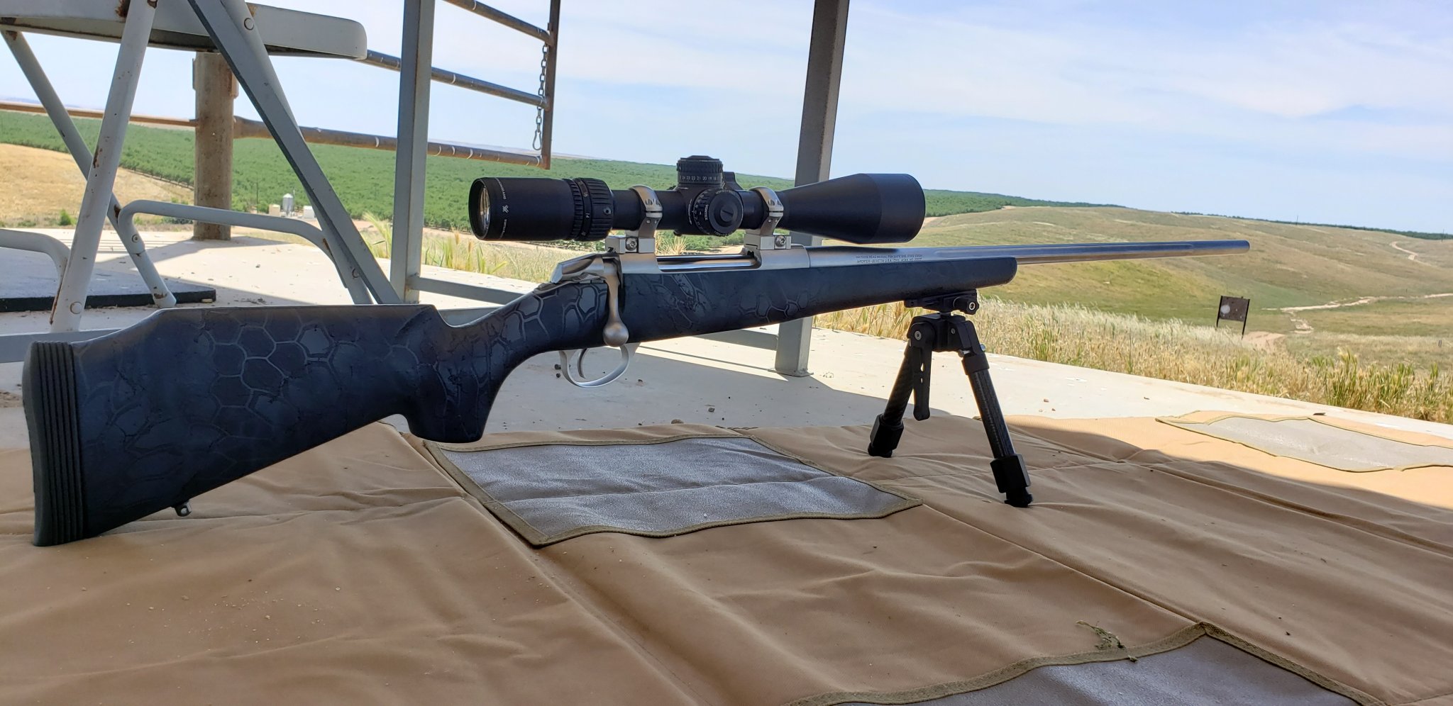

Sweet rifle! Here is what mine will be going on, here it is in CO this past fall with a Zeiss V6 5-30x50 and some rusty POS Burris rings.
Reactions: Muley Buck

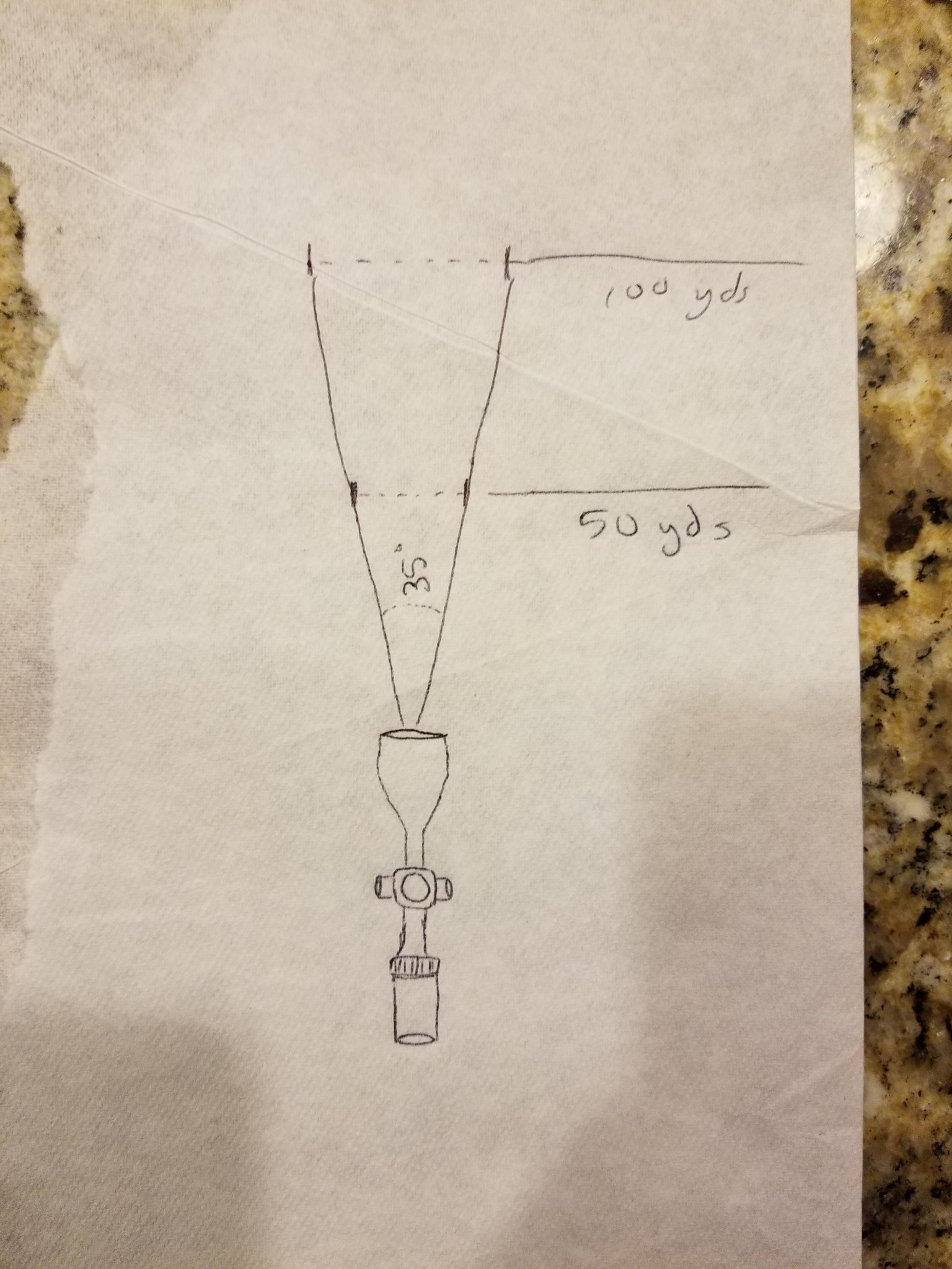

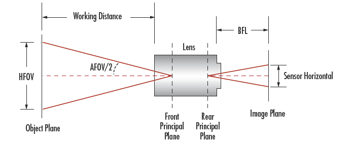

@koshkin In complete ignorance, how can I extrapolate FOV specs? I.E., the AMG at 20.4 ft/100yds, would that be 10.2 ft/50 yds? For some reason I feel like I'm not doing that right, that would take the NX8 26.4ft/100yds to 13.2ft/50 yds, and the comparison would 5.1ft and 6.6ft at 25 yards, which IMO, minimizes the importance of FOV for close action, but that would seem to be counter-intuitive as well. But like I said, I am ignorant on the subject and may have it all wrong.
Chris, take a look at this post, it might help some - https://www.snipershide.com/shooting/threads/technical-question-scope-specification.6934423/
You are not doing it right.
AMG FOV on 6x is 20.4 ft at 100 yards or 40.8 ft at 50 yards.
Correction: I wasn't paying attention. At half the distance, it is half the FOV if expressed in linear units. Angular FOV is distance invariant.

So FOV increases as you look at objects that are closer? I need to google FOV 101...I can’t wrap my mind around that.
Edit: would FOV (HFOV as expressed in ft/yds) not reduce to the objective diameter at 0 yards and maintain a linear relationship from there outward?
