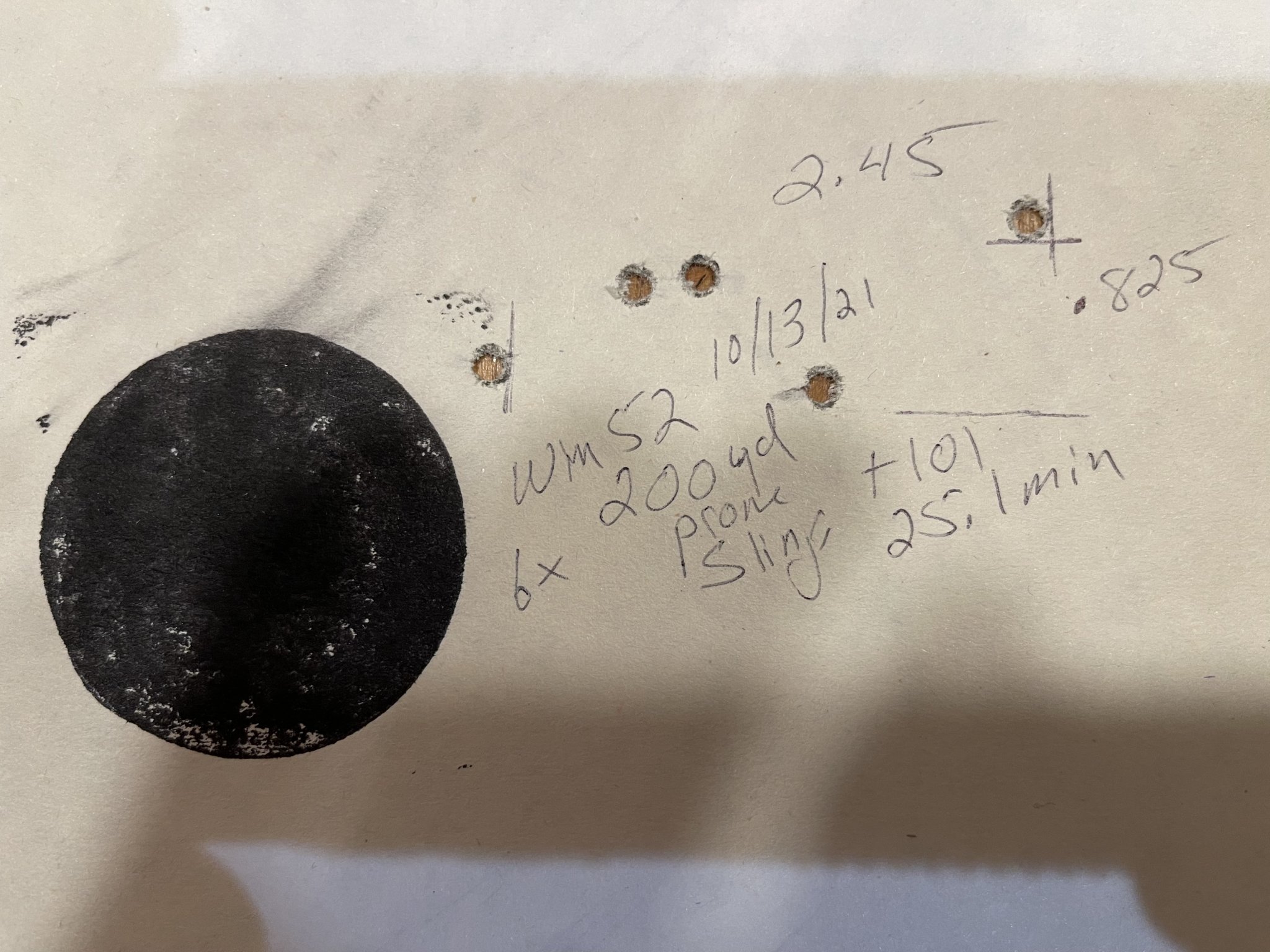

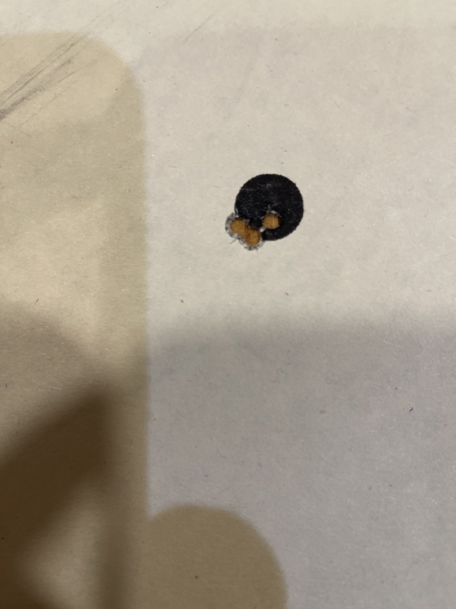

Our net effect is to provide balance to the equation. Please see last nights “wallet groups.”
3 shots at 100 yards 5 shots at 200 yards. Prone, tight sling,
to check POI and data.
I anchor the top end of the asking annoying questions, RT. :D

When rounds that don't appear to be damaged, nicked, or irregular behave in ways that MV doesn't predict, something else is happening.
An alternative explanation might be that SK ammo may have higher incidences of center of gravity issues than Lapua. Of course, bullet heel irregularities may contribute to or cause center of gravity problems.
