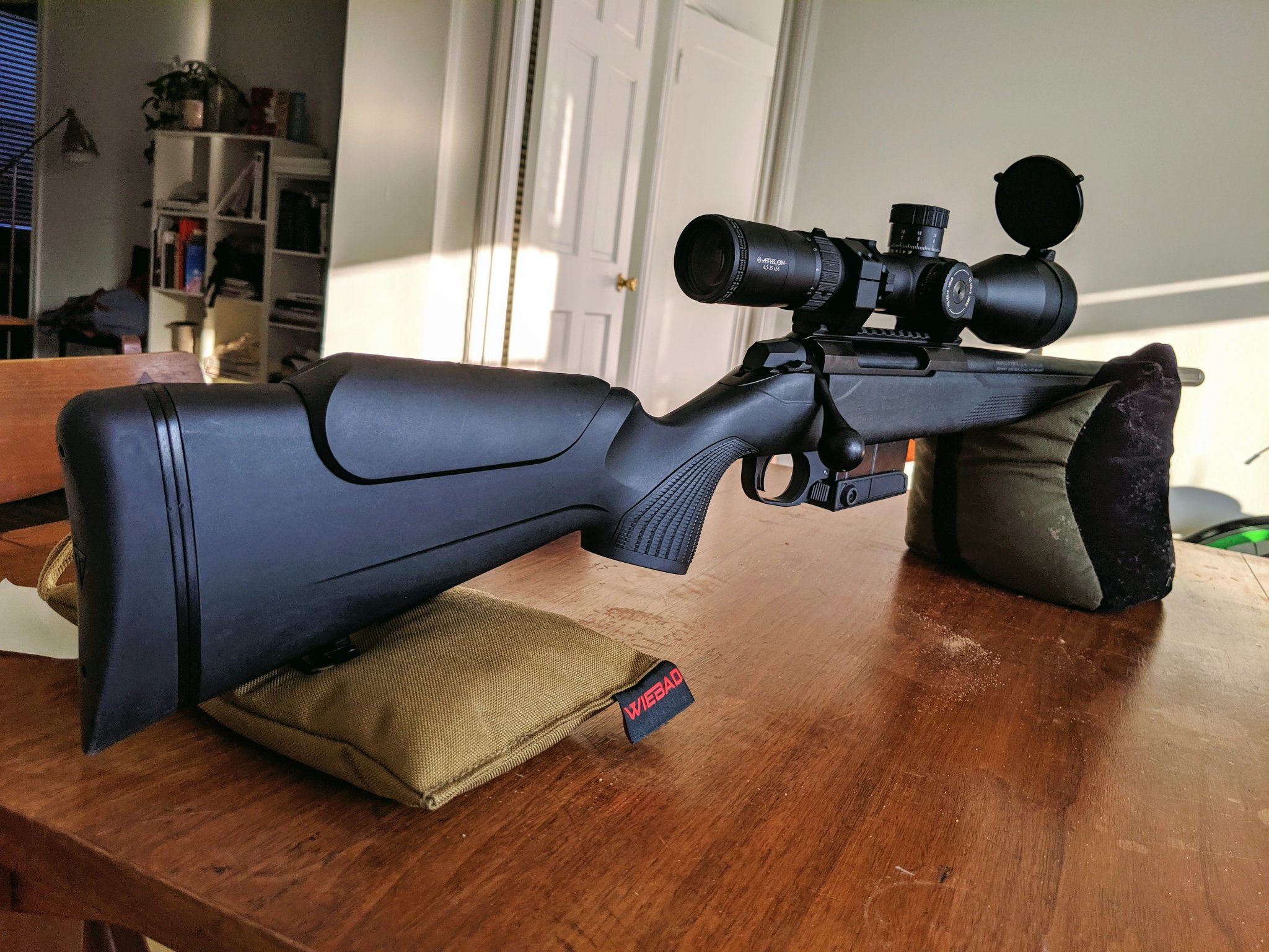

The advice and support on here has been killer. I don't think I've ever seen this kind of straightforward, no-strings-attached guidance on a message board, and I'm very grateful for it.
I was able to get most everything set up last night, and made sure to spend as much time as necessary to get the optic mounted correctly. Using a building corner as a plumb line and the Arisaka Defense leveler I was able to level the optic with confidence. I'm using Vortex Matched Precision Rings at 1.1 a inch height and noticed only after I had cinched everything down to 19-20 lbs that I had uneven spacing between the rings; so I wound up having to repeat the mounting process. Lessons learned.
One thing that became apparent early on was that A. I'm going to need a longer length of pull (I have gumby arms) and B. I'll need a taller comb height. Even with the 1.1" rings, closing my eyes and moving the rifle into a comfortable cheek weld resulted in exit pupil being too high. For the time being (and until I can upgrade to a chassis) I'll have to stick with a higher than usual cheek weld (or get creative with some foam and electrical tape).
I saved a crap-ton of money buying everything used or on sale, and that helped me fund the Sterk components and the match ammunition. The Sterk bolt handle I purchased didn't fit and so I'm going to have to spend some time tonight filing down the cerakote to get good fitment.
Cronus glass is dope, and I couldn't be happier. I paid significantly less for the Cronus than I would have for a used Razor Gen II and I'm pretty confident I'll get 98.5% of the performance. The APLR reticle, while busier than most, will be a good reticle on which to learn MIL. Speaking of MIL, I'm already seeing the advantages over MOA (which I've been using for my LPV optics). Like, you're telling me I don't have to do any calculations to figure out how to adjust my windage and elevation so long as I can use the reticle itself to measure POI from point of aim? And at any range? SOLD.
Regarding the cheek height problem, use closed cell foam (think dense foam, like old green military sleeping pads/ISO mat or the foam most scope companies put their their boxes for shipment) and quality duct tape like gorilla tape.
Cut into little strips and compress/tape each layer down and check the height. You also need to make sure that you leave enough room to remove the bolt without having to untape it all.
If you want to make life easier, drill two small holes at the top of the stock, grab a small piece of 2x2, and file/sand/shave it down to the proper height needed. Drill two holes in it, use bolts/washers/nuts to keep the bolts in place, and put it on the stock. Throw a stock pouch on it (be aware of the added 1/16-1/8” added from that padding) and boom, done. You have a removable cheek piece that is custom fit to your face and stock that is rock solid and won’t compress or slip on you.
I used to build up cheek pieces on my MCM A3 stock with ISO mat then went to the above method. I lost my saddle in all the moves but recently snagged one from a buddy so now I just have the saddle with a spacer block under the stem. But I still have the piece I made if you’re curious about what I mean with the above.

Just looking at your stock.
Looks like there are spacers in the butt
Could you just add more?
Cheek riser looks removable.
Can it be adjusted with spacers under it or layers of leather added and trimmed to fit?
Duct tape and foam ends up messy soon.

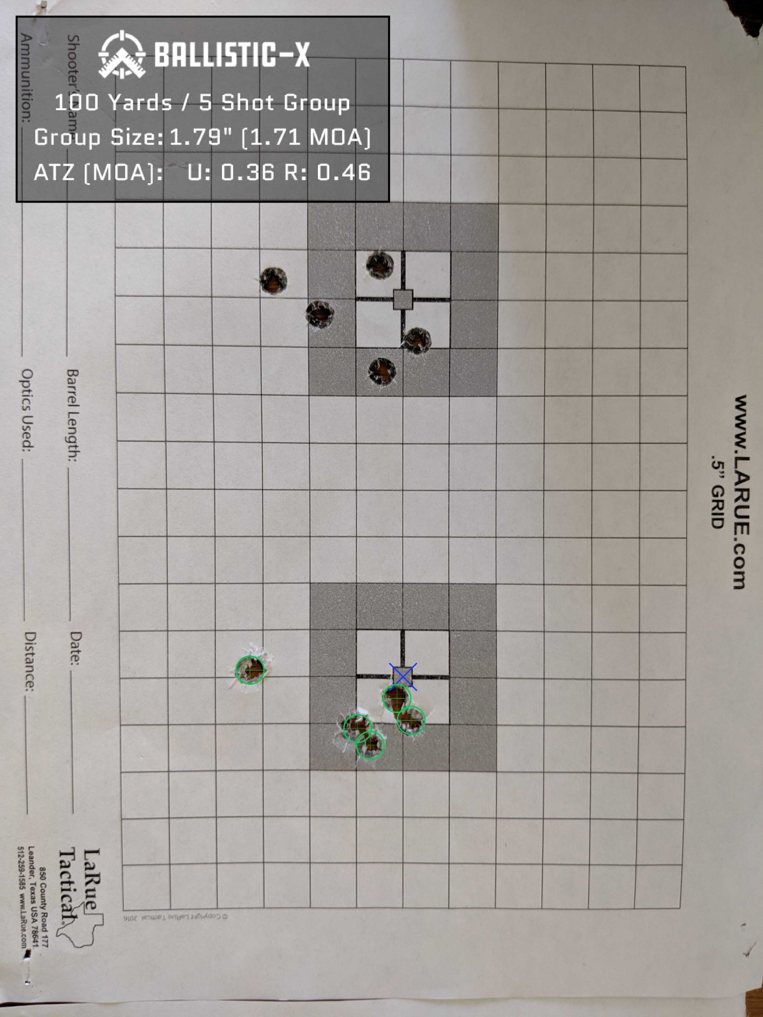

Back from the dead with another range report:
Had more time, shot more rounds. 46 rounds to be precise.
Having already done some preliminary sighting in at 50 yards on my previous trip, it only took (miraculously) three rounds to get zeroed at 100. My previous front bag was broke as hell so I borrowed a Bulls Bag X7 and set up at the bench. My gun range is great, but the benches not so much. I'm 5'-11 and the distance between the seat and the table surface made me feel like a hobbit. I wound up folding my gun bag in half and using it as improvised booster seat, which also had the wonderful side effect of providing padding for my bony ass.
After getting zeroed with the Lapua Scenar (Middle group) I shot another three round group that was entirely underwhelming (Top right).
It was all good, though, because the next three 5rd groups started to tighten up (from Top Left > Bottom Left > Bottom Right).
1st Group: 1.25 MOA
2nd Group: .97 MOA
3rd Group: .86 MOA
Conclusion: Scenar is hella good and I will be buying more (even at the ball-punching cost of $1.80 a round)

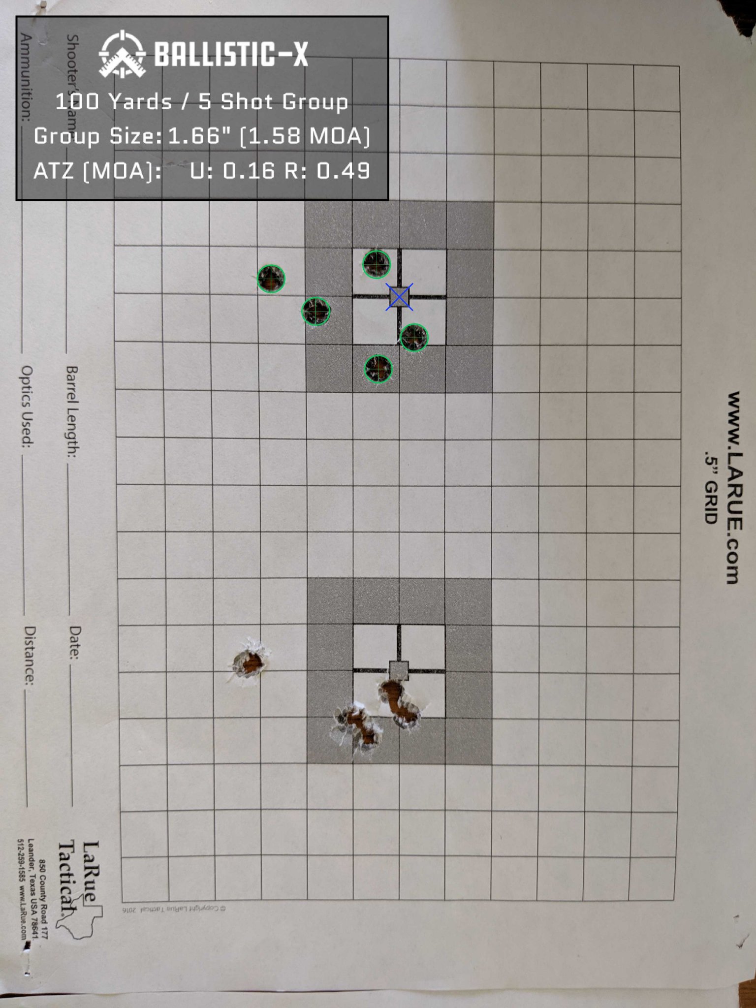

I then switched over to Federal Gold and put another 25 rounds on paper, again seeing progressively better groups as I came into a greater instinctual awareness about shot placement. I don't know if this is what the rest of you experience, but there's a kind of utterly silent zen moment where you perceive that everything is as it should be.
1st 5 Shot Group: 1.58 MOA
2nd 5 Shot Group: 1.71 MOA (but technically better shooting overall than the first group)
3rd 5 Shot Group: 1.17 MOA
4th 5 Shot Group: 1.31 MOA
5th 5 Shot Group: .57 MOA (a freak accident, but I felt completely 'in the zone')
Even though my shoulder hurt like hell after 46 rounds of .308, it was a massively positive experience. I could generally tell why bad hits were bad hits, and I could 'sense' when the shot was going to be good (calling shots). I also discovered that some of my best shots were made when I wasn't even thinking about my breathing. It was just clear to me in that millisecond of time before I pulled the trigger that the conditions were perfect.
Major takeaways:
-People often talk about relaxing your body, but I think some emphasis should also be placed upon relaxing your face. I found that when I relaxed my face (and especially the eyelid of my dominant eye) my shooting became more consistent. Keeping your eyelids in a kind of listless, nearly-squinted state seems to be the ticket, but I'm curious to hear if this is actually a beneficial practice.
-Someone next to me was shooting their Aero Precision AR10 build with a 419 Hellfire brake, and it was miserable. I thought that I had gotten my range 'jumpiness' under control. Not really. I jerked every time that gun went off, and it went off a lot. I was considering the Hellfire break but now I'm not so sure. I may skip the break altogether and jump on the suppressor bandwagon instead. Time for a Thunderbeast?
-I didn't need to be at my optic's max magnification range to shoot good groups. Every shot was taken at x15 power, and that was more than adequate to see my hits at 100 yards. The advice I see regularly is to never use more magnification than you absolutely need, and it seems like good advice to me.
-If this game is about consistency, then it doesn't make sense to exclude bad shots from your group calculations. Even if I land four great shots, it's still not a great group if the 5th hit sucks.
-If I am being honest with myself about the averages, I'm probably a 1.3 MOA shooter, even though my technical average comes out to 1.03 MOA for the 8 - five shot groups.
