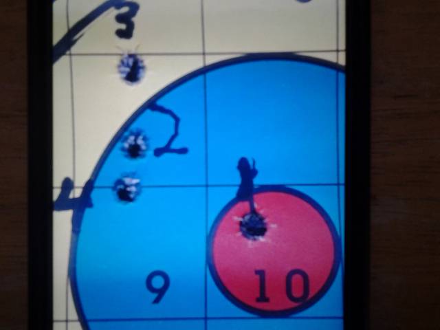

I just did a test on some new 243 ammo.
I didn't know the barrel had been cleaned and lubed.
Took several shots to settle down.
This is a sight in string not a group, saved it to empfisize a point.
Shot 1 cold bore, wet with lube. Never mind it hit well, fluke.
Shots 2-4 cold bore, waited 15 minutes between shots and checked barrel temp.
I think a wet bore makes more difference than temps, untill you heat up the barrel.
Something to consider in testing.
Rem 700, 243 thin barrel, 4x14 Leopold, 100gr American Whitetail ammo, 1$ a round factory
Stuff. Dead air, bench rest with bags.
The cleaning between brand stuff shows up more in 22lr subs for me. Imo it's the wax.
I would not get too extatic on the first 5 rounds of anything , especially if you decide to clean.
