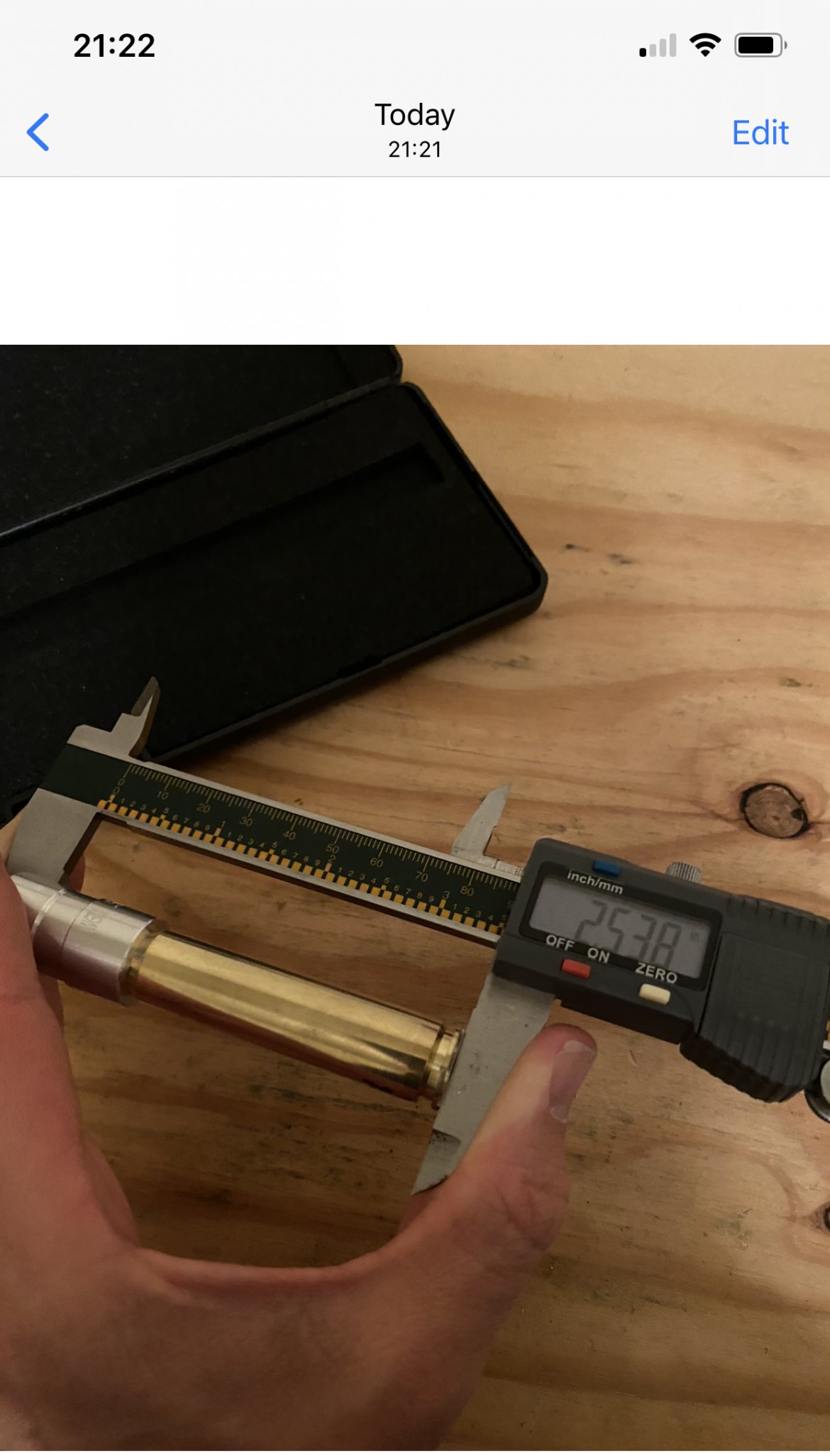

Took the fired brass and it chambered. 2.538”
Took non annealed brass, set the shoulder back .002 and it chambered just fine. Easier than the plain fired brass. 2.536”. Also no chamber burr markes on the case body like last time
Annealed a case. It is 3.540”. It was a bit difficult to get the bolt closed. I repeated this multiple times, same .002” stretch.
Sized the annealed cases to 2.536” and everything chambered fine and no marks on the case body this time.

Correct, measurement before annealing was 2.538. After annealing 2.540”. It was done over ten times with the same result.
I think their may have been issues with the last batch of brass. This particular lot will chamber just fine after sizing and annealing, unlike the last lot.

Did that tonight with 5 leftover cases and saw an increase of .002 in the length. But the case body did not grow this time and everything fit fine in the chamber.
