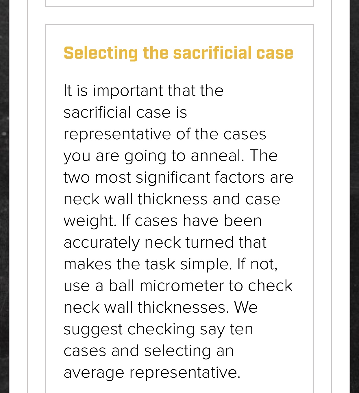

    Have the Giraud, got AMP recently, really impressed. Until tonight.
    I ran Aztec on a 50 BMG RWS case and got my code during setup. Tonight I was bored and figured I'd check some other manufacturer brass, just to see and record the different codes. So I did a LC '95 case. Code was higher. Great. Did a Lapua 50 BMG case. Code was between LC and RWS. Great. Then I said to me-self, Amigo, run that Lapua case again. The first time it was 2274. I ran it again. It wasn't even close. I forget the number. Cuz I apologized for me AMP machine and me said to me-self, Amigo, it's because the first time it deformed the neck so of course it's a different number the second time. So I got me 2 new unfired Lapua cases like the first, from the same box and the same lot. Mind you, these are $5.50 a piece. And the next one was 2269 and the third one was 2282.
    So, these are not so far off from one another me says to me-self, but then me gets to thinking. If a f'n Lapua case, considered the best in the industry, with the possible exception of RWS/RUAG (I ain't burning any more of those up!) has a *variability* of this "perfect" code of 13 points, what point is it to be "perfect"? Cuz the Lapua brass ain't "perfect"! And if there is that much variability in the brass, then why do we need these codes to be so precise? Why not round to the nearest 5 or 10?
    I suspect there's some clever marketing at work, and EVEN IF the machine is so precise, it doesn't matter because the signal from the machine is lost in the noise of brass variability.
    Let that sink in for a few minutes, all of you, who like me, touted the "set it and forget it, it's perfect" sales pitch of the machine.
    Hell, I may be better off with Tempilaq and me Giraud flame annealer.
    Go burn up $20 of Lapua brass and come back and tell me what you find. :)

    If I remember correctly. Sometimes I don't. You weren't just supposed to pick a case by just grabbing it and checking it. How I thought it was supposed to work was you took ten cases weighed and measured neck thickness and went for a case that fell in the mid range of it all and use that case. I know I have 1000 same lot .308 lapua and they range in weight and a few odd ball neck thickness from each other.
    I was typing the same thing. Exactly correct.

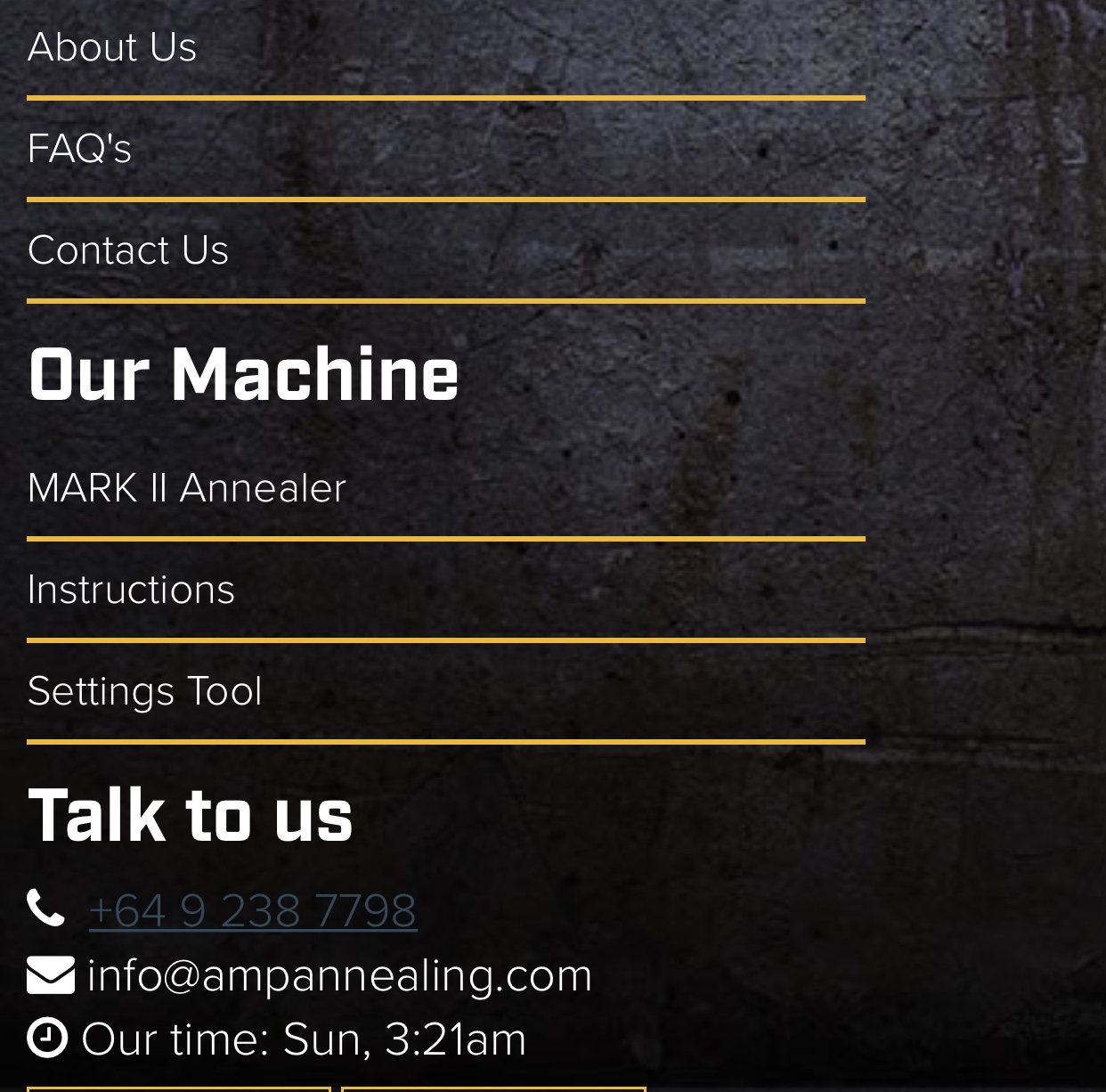

    my machine came with zilch for instructions. No manual. Just one page of pretty useless stuff. So I watch all their videos and set it up.
    it may be another point altogether, but if there is this sophisticated setupprocedure (nobody has yet provided a link to it) then it’s pretty irresponsible to send out the $1500 machine without instructions I think.

    Yep, the instructions are super hard to find......

    So you purchased an expensive piece of equipment without reading the manufacture's data, instead relying entirely on community posts apparently none of which pointed you back to the manufacture's site to read the data? Then, you pick the most expensive brass and proceed to test with it.
    Since you can't find it and nobody else has posted it for you, here is the write-up on which brass to select (note that they see a difference in new unsized but fired, new sized and fired) and how the variations happen.
    https://www.ampannealing.com/articles/46/annealing-under-the-microscope/

    I have an original AMP that was upgraded to Aztec. I have an early version of the firmware that came with the sort feature that they have since discontinued. Mine came with an instruction guide that I have never read. The instructions also contain their website address. I had already read everything on their site prior to purchasing, and still go back to their site every couple of months to see if they have published anything new. In today's world, especially when you are buying something that can be upgraded by flashing the firmware/OS, printed instructions are pointless.
    As for the cases weighing the same but result in a different setting, if you read the article I posted you will see they checked the thickness of brass and found that one of the cases had a 9.6% difference a the shoulder to neck junction. Differences in this section will change the setting. I would imagine that any variation in a 50 BMG case would be amplified (more surface area, greater dispersion of the difference). Since not even Lapua sends brass that is all exactly the same OAL, unless you measured neck thickness, OAL, primer pocket depth, and then weighed, you would not have know if they were likely to be the same.
    Personally, I think you own a screw-up regardless of if there is something wrong with the machine or not. You tested brass that was not fired therefore your readings are worthless. Without knowing jack about metallurgy, I would say that Lapua's method of annealing and manufacture process results in cases that do not have the exact same hardness but working that brass would bring it back to a closer proximity. If that is even close to what is going on, testing the work hardened brass would give you a better result.
    A couple of things....
    1.) You need to use fire formed cases only.
    2.) 3 randomly selected fire formed 50BMG cases are not going to weigh exactly 866.3gr each. I flat out don't believe that.
    3.) There will be some variability in the returned AZTEC codes..this isn't some made up number. It's the machine returning a value for when that piece of brass got to a specific temperature.
    3a.) If you were truly using fire formed brass, that is most likely weight, neck wall thickness, or composition of the brass itself.
    You can expect to see some variability in the machine...however that will be taken to the extreme when you're fire forming something like a 50BMG.
    As an example, on .308 Palma brass you might see +/- 1, but those cases only weight ~173gr.
    Lastly, AMP isn't going to share the method it uses to calculate the AZTEC code. That IP is their entire selling point, otherwise somebody else would just make a bunch of Annie annealers stateside, and undercut the hell out of them.
