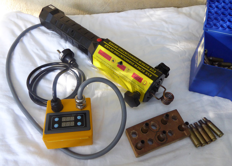

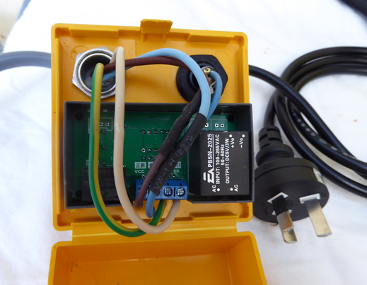

    Magnetic induction is a great way to anneal cases, however the price of the AMP always put me off.
    I found a guy on Youtube who came up with his own hack. Using a 1000W induction wand with a repeating ON/OFF timer you can achieve the same results. Plus use it as for what it's originally designed, to loosen bolts. The New Zealand guys who make the AMP are doing the same thing, but use a metal box with inserts.
    I use an old Berger bullet box to house the timer and have twisted a couple of copper coils for annealing brass. The wood case holder means they all get annealed to the same height. I have done a few thousand in three calibres without issue. As for precision/accuracy (I'm an F Class shooter), it does not seem to improve it at all, so for me it's all about case life. I know two guys who have the AMP and they both report no improvement in results on the target either. It does clean up your velocity spreads, but for results down range...meh. So it's all about what you think case life is worth vs. the time and expense. I enjoy tinkering, so there's that as well.
    Here's the original Induction Annealing video which I copied. I like how he doesn't deliberately over-complicate the build. This settup is under $300USD.
