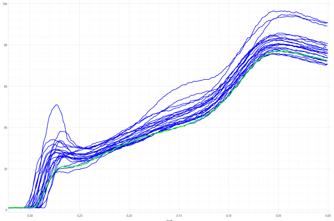

    Have you tried measuring the culls or torn some down to try and find out why they were different?
    I'm personally curious as to what decisions are derived as a reloader as a result of this information.
    - What is your personal threshold for "good" or "bad" ammo according to the seating force metrics? Is there a specific seating force metric you are constantly trying to achieve?
    - For the most part it's nearly impossible to tell because all of the graphed lines are the same color - but it likes like there are potentially 3 specific force spikes on some of them. Are the specimens with the early high force spikes the same as the middle and ending spikes? Or can one projectile while being seated demonstrate an early spike but average seating force the rest of the way and vice versa? It's a shame there's no way to really delineate the specific rounds from that graph, it's impossible to read except for extreme outliers.
    - Adding to the above, what is worse for performance? An early spike in seating force? A middle spike? Or an ending spike? It looks like at least one of the outliers in that graph with an ending seating force spike looked pretty normal all the way through until the last spike, which means there was another round that had a middle spike in seating force.
    - What are done with the outliers? Have you consistently checked the outliers through chrono and/or group shooting to see if they perform as outliers as well? Or is the seating force graph mostly academic?
    - Have you been able to determine what is the cause of outliers as seen on the seating depth force graph? Is it caused by user error? Is it an error in one of your processes? An error in your equipment? Are you able to predict know what will cause an outlier, and as a result have you improved your processes and/or equipment? Or are outliers more or less the same, but you just "cull" them?
    - What has changed as a result of having this new information available to you? Has your process changed? Specific equipment has been replaced as a result? Are you utilizing new or different products such as neck lubes? Now that you have access to this data, have you intentionally tested different equipment and/or processes to optimize bullet seating force?

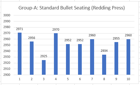

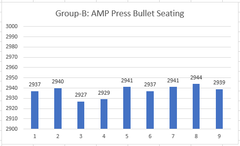

    So as a follow-up ... and for those of you that were looking for hard data ... I finally had a chance at the range yesterday to directly compare identical loads, with the ONLY difference being Group-A seated the bullet using a Redding Competition Micrometer Seating Die on a standard press (Redding Big-Boss II), and Group-B used the LE Wilson Inline Die on the AMP Press. All 19 rounds (two groups of 10 ... but one in Group-B didn't register on my Labradar) were prepared as follows:
    • Rifle: Barrett MRAD 338-LM
    • Case: Lapua 1x (Annealed)
    • Powder: H1000 92.9 gn
    • Shell Holder: .004
    • Bushing: SAC .365
    • Mandrel: .338
    • Seat: 2.777 BTO
    Group-A (Redding Press) SD: 14.5
    Group-B (AMP Press) SD: 5.35
    Graphs are below. This actually surprised me ... and I'd be lying if I said I understood why identically prepared cartridges built at exactly the same time, varied so much in Standard Deviation ... but the data is what it is. I'll do some more testing on other calibers over the next few weeks to see if this repeats with other size cartridges. BTW ... everything at 100-yards grouped just fine in both categories.
    For now ... I gotta say, I'm pretty friggin' happy with my Inline Dies and AMP Press, and I continue to believe it improves my SD's. Still TBD is whether or not that translates to better accuracy at long distances. I also need to do the "Outliers" test discussed earlier in this thread.
    OK ... I'm totally ready to be told all the things I'm doing wrong here ... so ... BRING IT !!! :LOL:
    That's pretty interesting.
    I'm surprised a press would make that much difference. Have your reloads with the Redding press always been around that high of SD/ES?
    Also, have you tested any of your "culls" over a chrono yet to see if the seating force translates directly into performance?
    My 338-LM loads on the standard press have always been mid-to-low teens, until now. My handloads with other calibers (300-WM, 300-PRC, 300-NM) have gotten to high single digits (8.0-ish), but are now consistently in the mid-single-digits (5.0-ish). That said, I've never had a 338-LM test in single digits like this one. No "cull testing" yet ... that's next. I usually don't arm the Labradar until the testing rounds start down-range.

    When you seat with your Redding press, do you find that you have inconsistent base to ogive measurements? Does the AMP produce more consistent results by that metric?
    And for that test, was all the brass sized by the same press?
    Yes ... I don't get tight tolerances seating on my standard press no matter how hard I try.
    Yes ... I get BTO's that are way more precise and consistent on the AMP Press.
    Yes ... All the brass was sized by the same press using a Redding Type-S FL Bushing Die.

    But you do realize in this test that the AMP press really has nothing to do with your observed improvements. You had an easily identifiable issue with your load process ( which even you said you were aware of). You switched to a new method of seating, Wilson in line dies, which you say, solved the problem (and is understandable). So what did the AMP press contribute? In reality, you could have used Wilson dies and an arbor press to fix the problem ( or just better screw in dies).
    Also in this test, did you use lighter neck tension that you mentioned before? If so, which was it, better seating dies, less tension or both? And again, what did the AMP press contribute? While it may have shown your seating pressure to be relatively high, most people can feel, particularly with a Wilson die, that kind of too high pressure, or do the the math, maybe .007 is too much and I should try .002 - .003 tension, and then test that. Again, no AMP required. Another example would be , guys on my F Open team use anywhere from .0015 to .005 neck tension because they have tested that and determined which neck tension gives them the best results on paper. Again, no AMP required. And the trace results are different but the scores say each work just fine.
    I'm not the guy trying to pick on you, in fact I'm pretty impressed with your 338 SD's- is that a 250 gr bullet?, I'm just the guy asking the questions bc many people have been down this road and are still scratching their heads as to what benefits the press brings.
    I am using the same press for sizing.
    Shoulder bumps are perfect ... very consistent.
    And I trim with a Henderson, so all good there.
    Don't you want to know my favorite color? :ROFLMAO:
    (Purple)
    :ROFLMAO:
    Just trying to figure out the consistency issues.
    Interesting that the Redding press leads to inconsistencies in bullet seating depths, but that same press doesn't have an issue with consistencies with shoulder bumps.
    I just noticed now (should've noticed earlier) - but you are using different seating dies with the different presses. So you have two different variables at play and aren't isolated. Is the seating consistency due to the Redding press (maybe? Maybe not - given that shoulder bumps are consistent). Or is the seating depth inconsistencies due to the Redding die? Or perhaps its a compatibility/tolerance issue or procedural issue with specific equipment setups.
    The only real way of finding out if its the press or the die is to isolate one of those variables and shoot some more test groups. Perform the same test, loading groups with the Redding die + Redding press and compare groups loaded with the AMP press + Redding die. If you wanted to go further, you can do the same test and compare, but with the Wilson seating die used in both presses.
