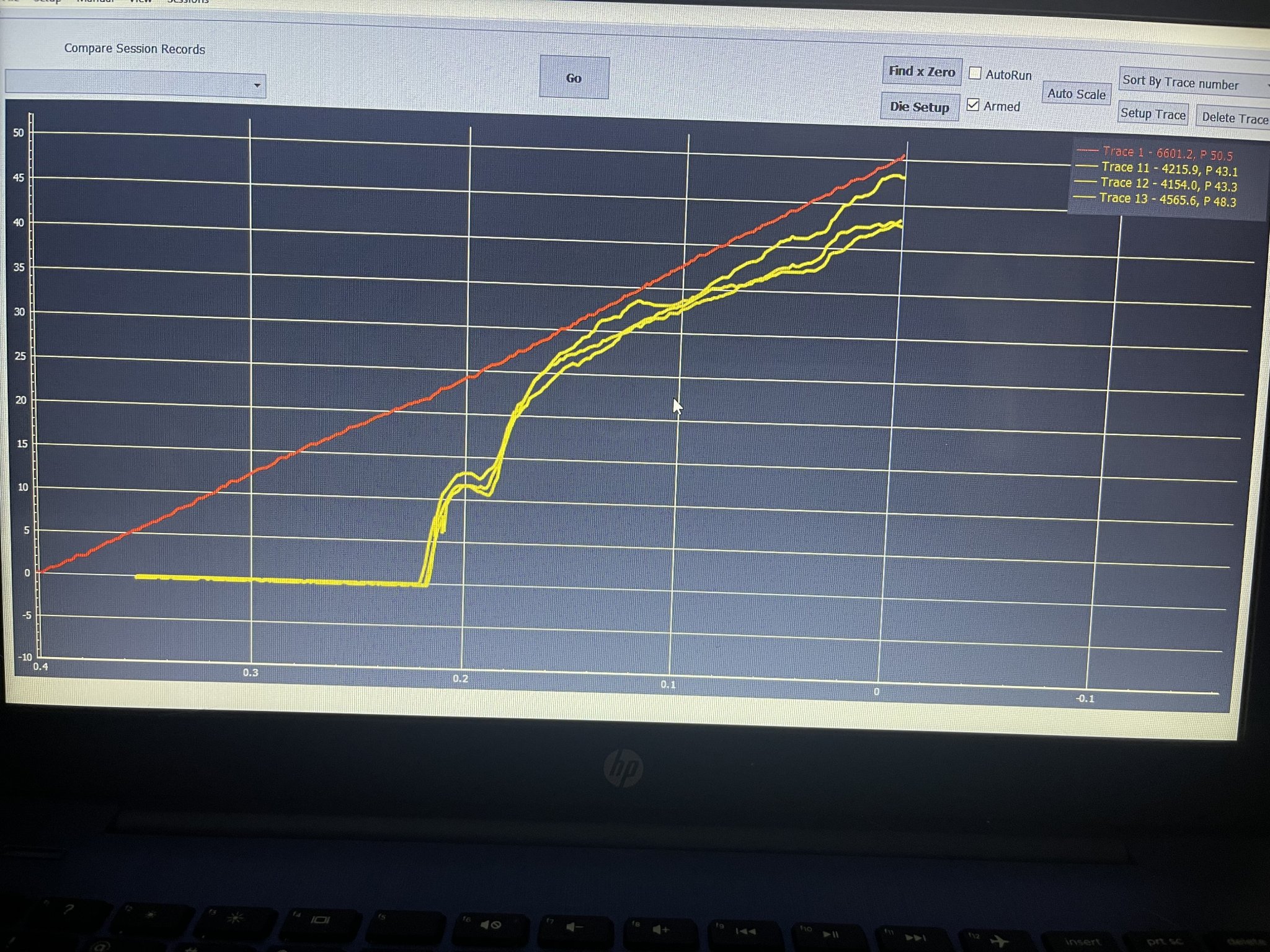

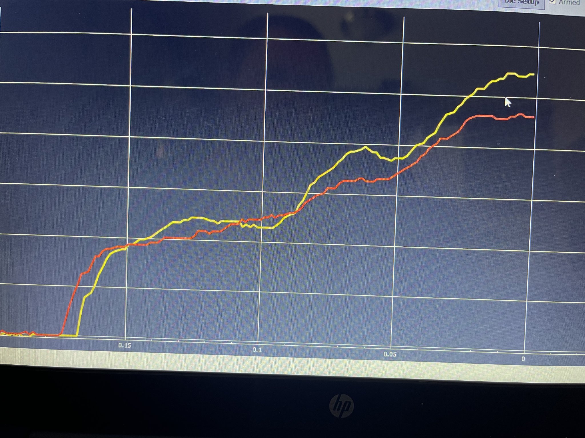

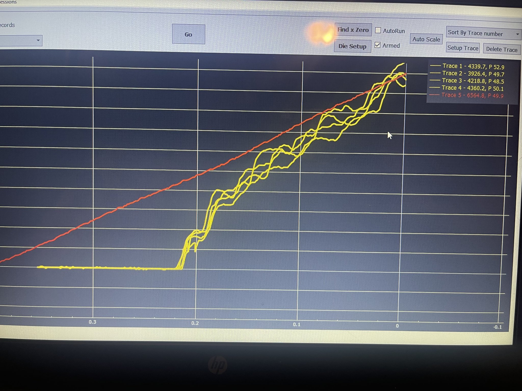

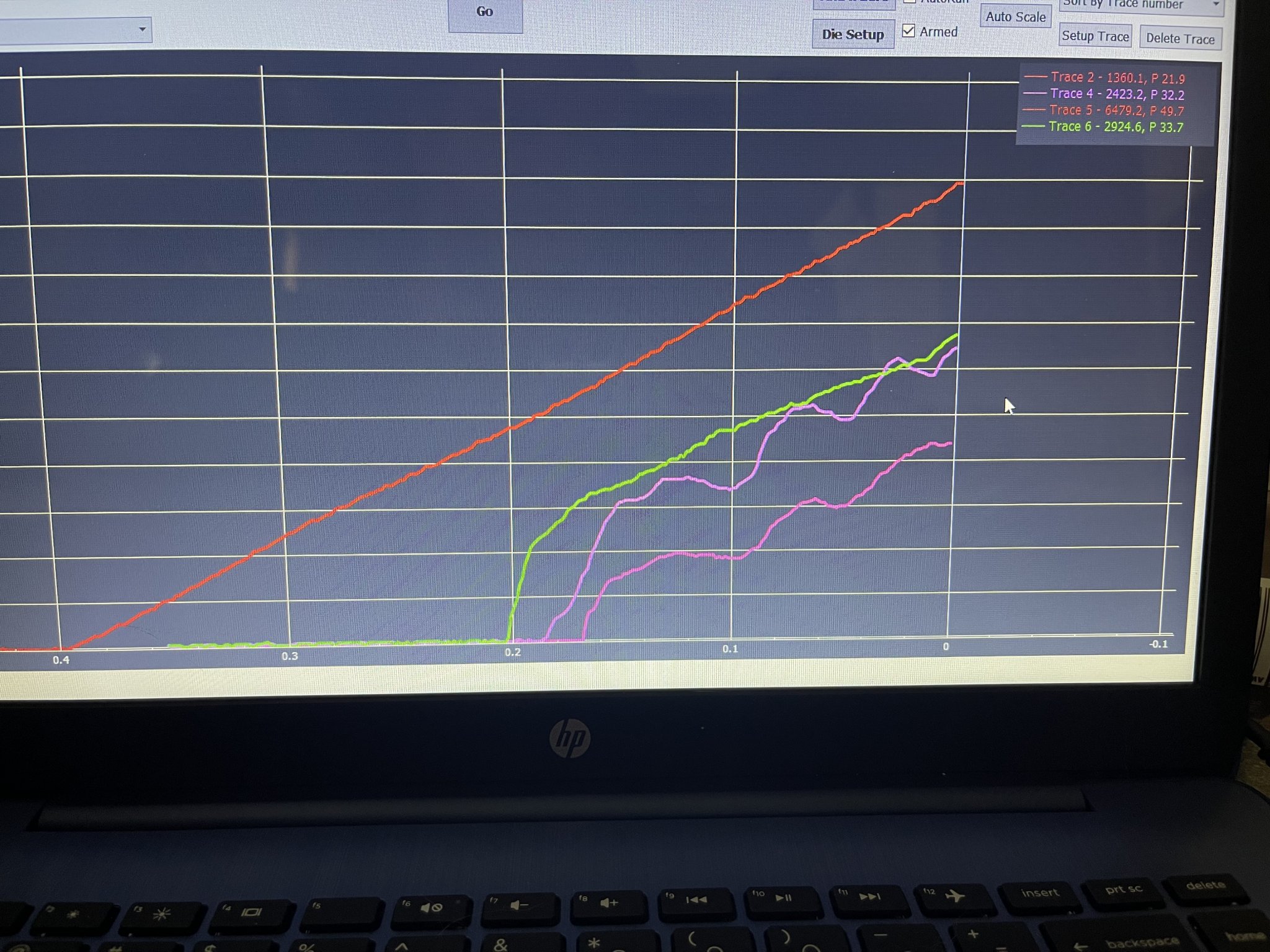

Here are graphs from very small changes in brass prep that you can either barely or not feel with the best manual arbor press you could buy prior.
They all do some different things on chrono and paper. But you’d never know why before you could measure this.
I could literally write a term paper on what you can do with this press we couldn’t before and I’ve had it less than two weeks.

Also, please let me know how we could already:
Keep track of the total work done during seating of every round. Find the SD of total work. Then cull out every round not within 1 unit of SD from the average work done.
This culls out 30% of your loaded ammo from a batch and keeps you inside a single SD measurement.

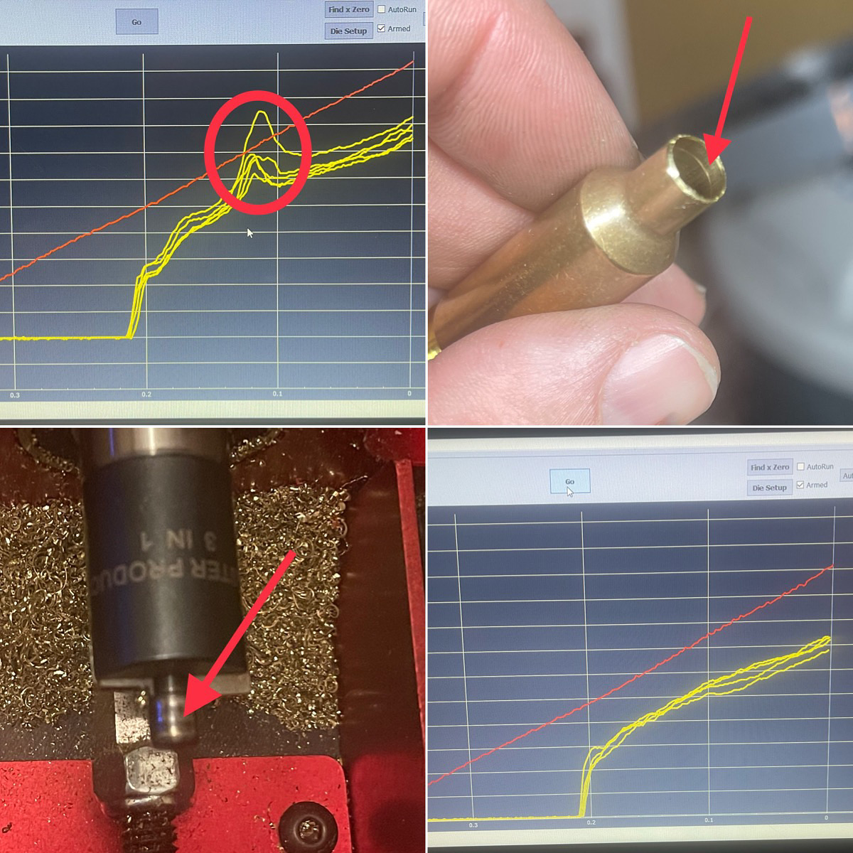

Interesting. How long did it take to figure ol that was the problem? And not consistently seating the base of the cartridge in a collet exactly the same way every way?
Took about 5 min to figure it out.
Just by it’s very nature, if something requires a pilot to work, it will always touch. Otherwise the pilot would not be needed (giruad, IDOD, etc don’t require a pilot).
The minute the brass touches the pilot (almost always) it will always be touching.
Also, I tried it without the pilot and with a .22 pilot.
Just the weight of the brass and that it’s only supported at the rim….it chatters all over the place.
So, all but impossible for it to operate without contact.
