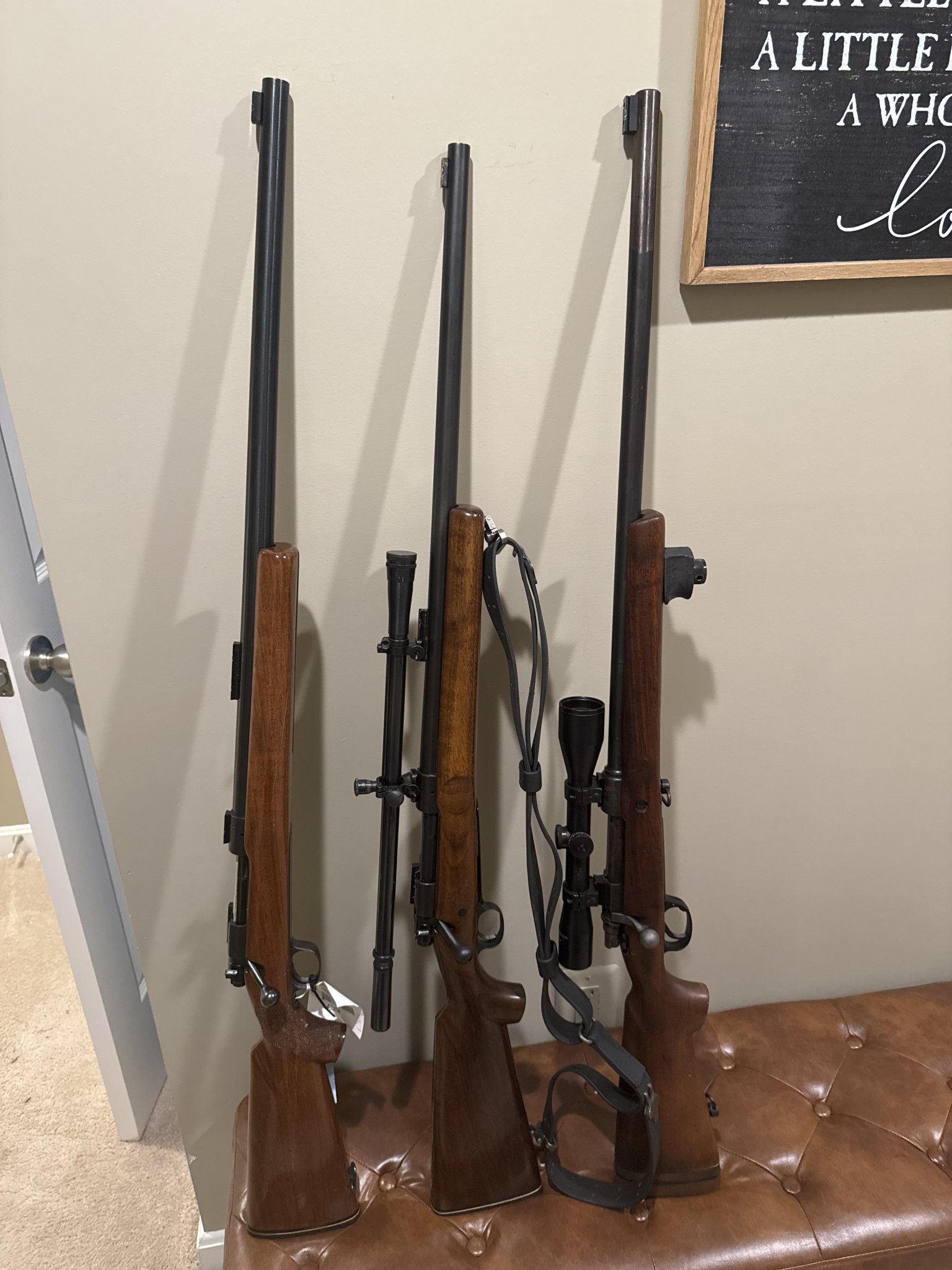

Thank you! Its a 10 twist barrel, trying to post pics, says it’s too big!

Fat wood stocks and fat barrels make the world go round had to add the M82 into the mix too
