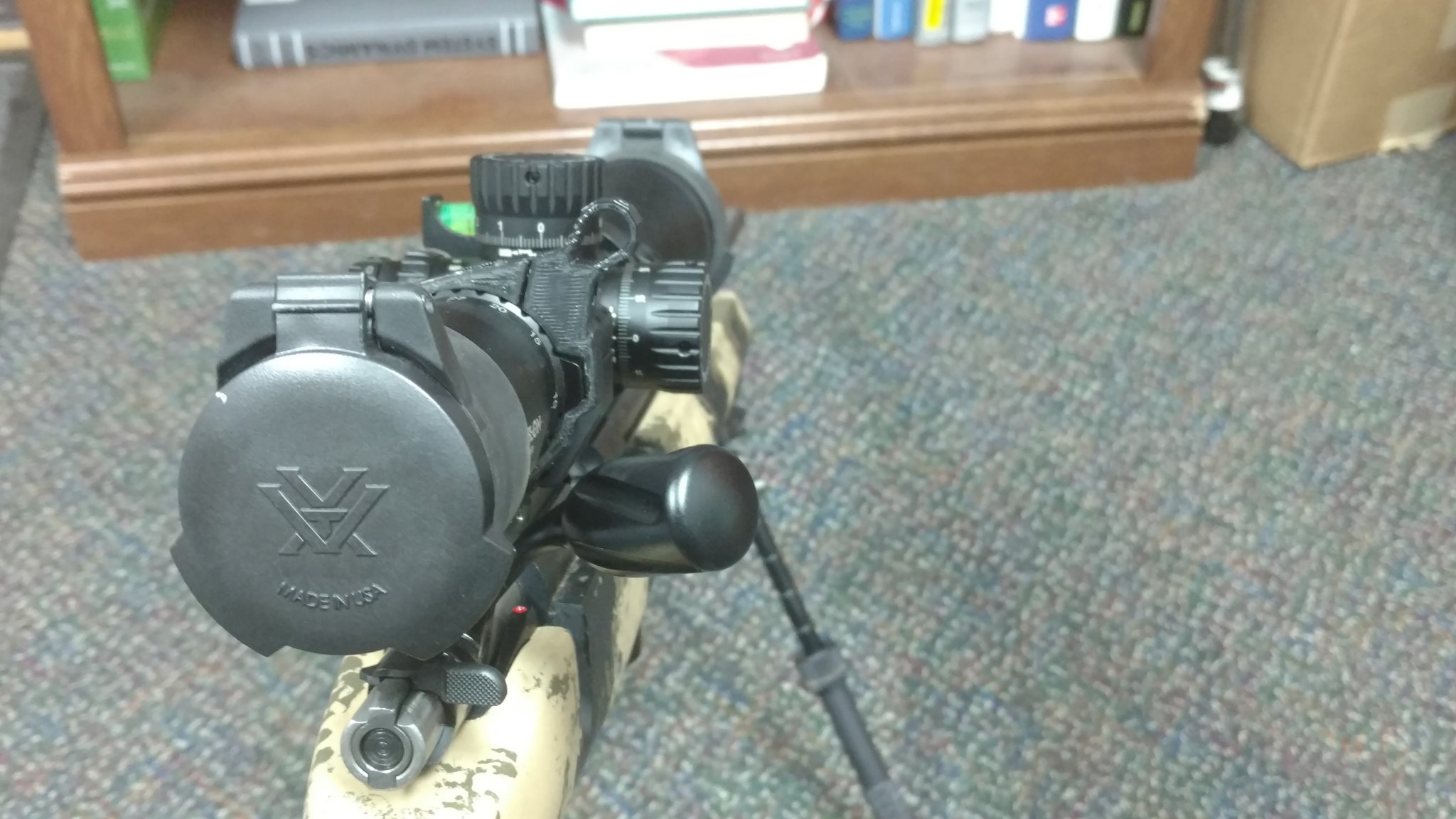

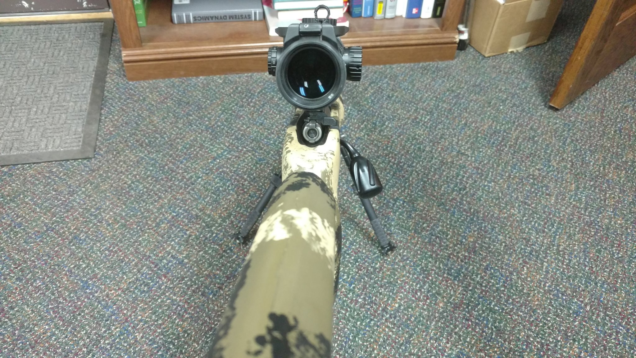

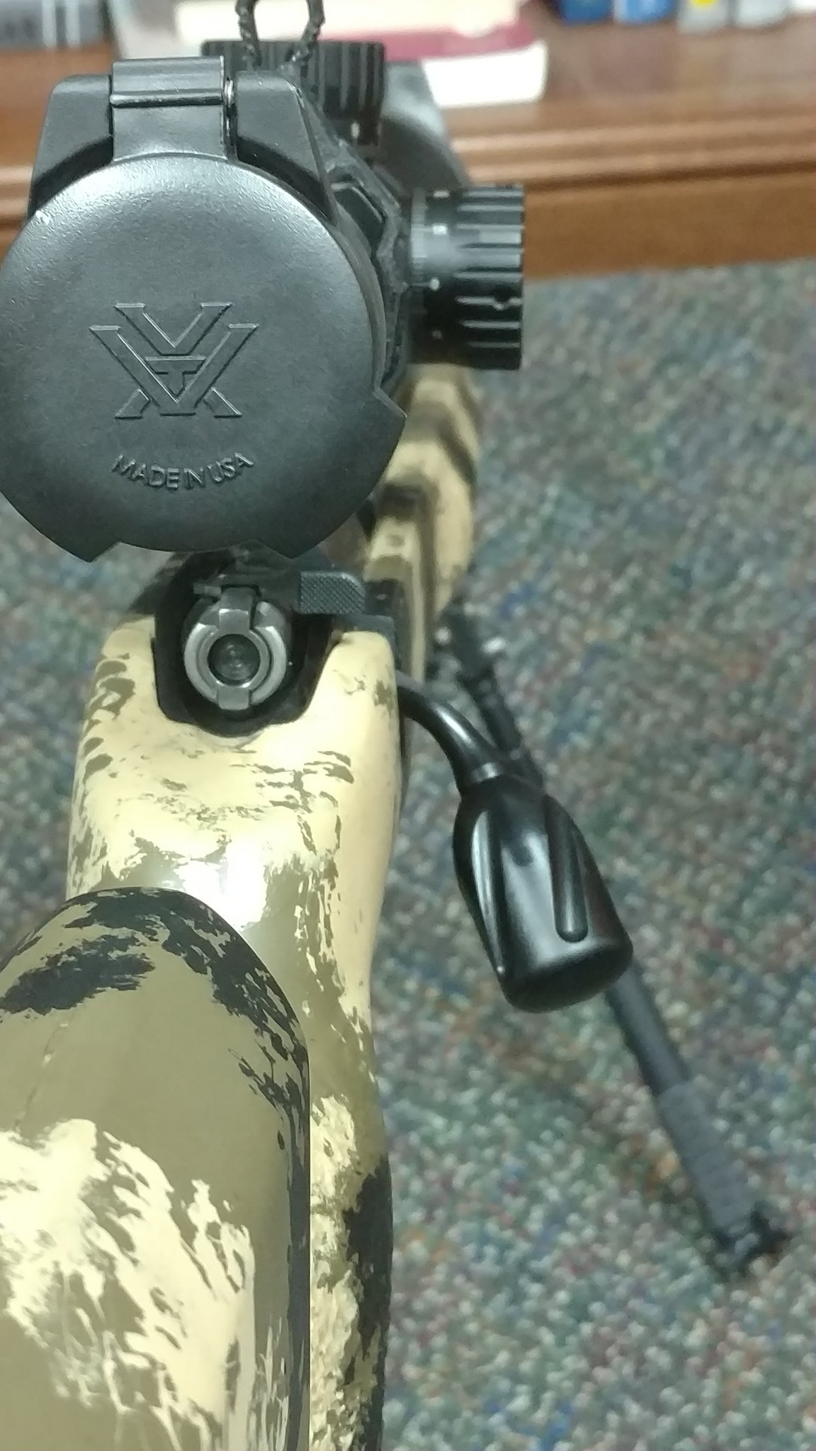

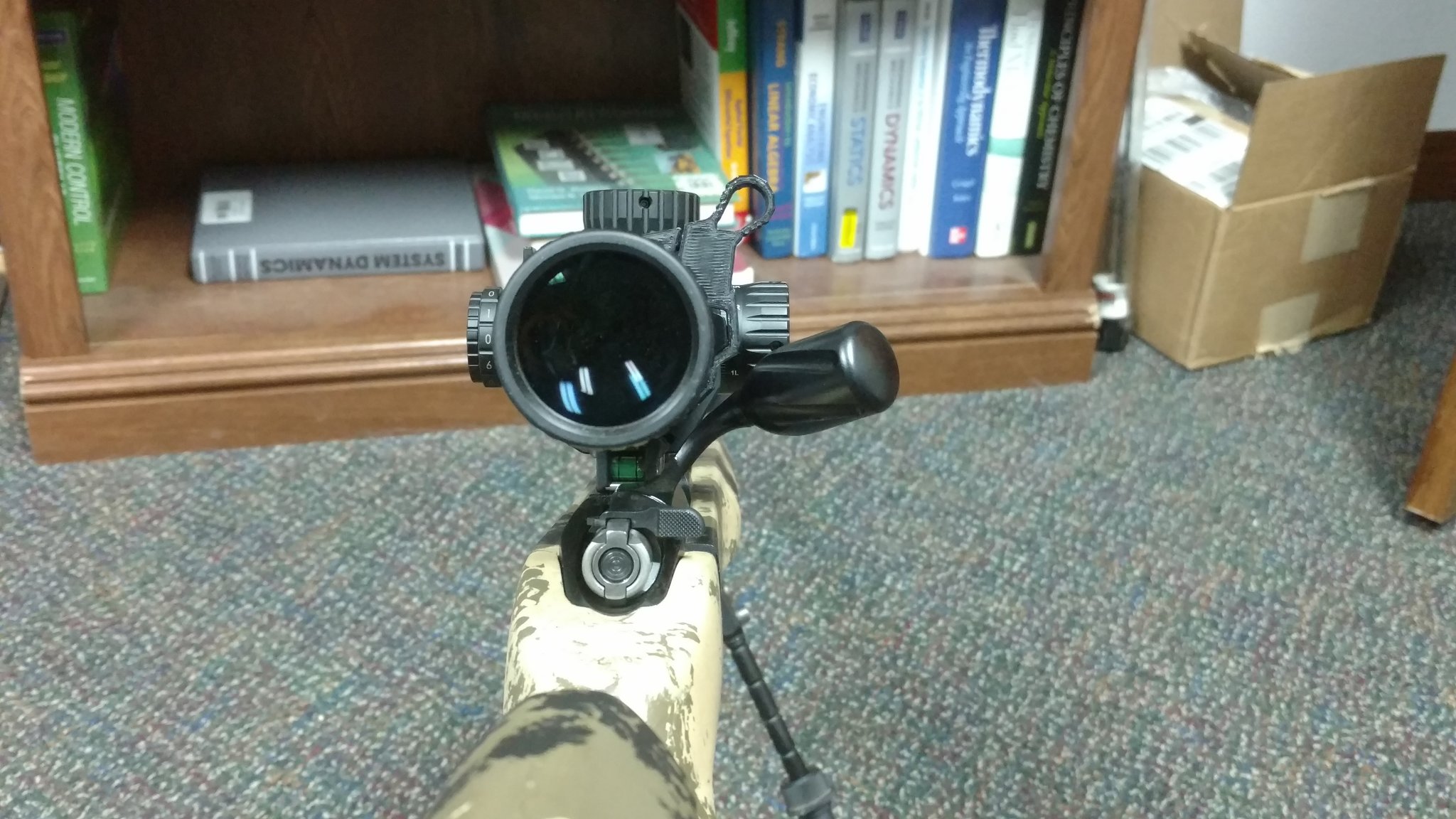

I wanted to share another option for the CZ users looking to have a threaded handle for a knob. I ordered the CZ 455 swept handle from Anarchy Outdoors and installed it today. Haven't made it out to shoot. For me it changes the feel of the action quite a bit. Although I did clean my bolt and lube it pretty well when installing it, I wasn't getting the hitch in the action that I was with the factory handle. The new handle was a little tight in my action at first, with a couple of noticeable wear points, but with some lube and cycling the bolt about 20 times, it is very smooth now. Pictures are with one of the Anarchy 5/16x24 anodized fluted knobs. It may be a little spendy for some but it seems like with the new casting with the hole on the factory knob, you have to go through a lot of work to get that threaded.
BTW - I am using the Area 419 base and also happen to have medium height rings on as well. They suggest medium height rings if you aren't using the 419 base. The handle is about as close to my throw lever as it was with the factory handle but the added length on the knob keeps my hand pretty far from the scope.

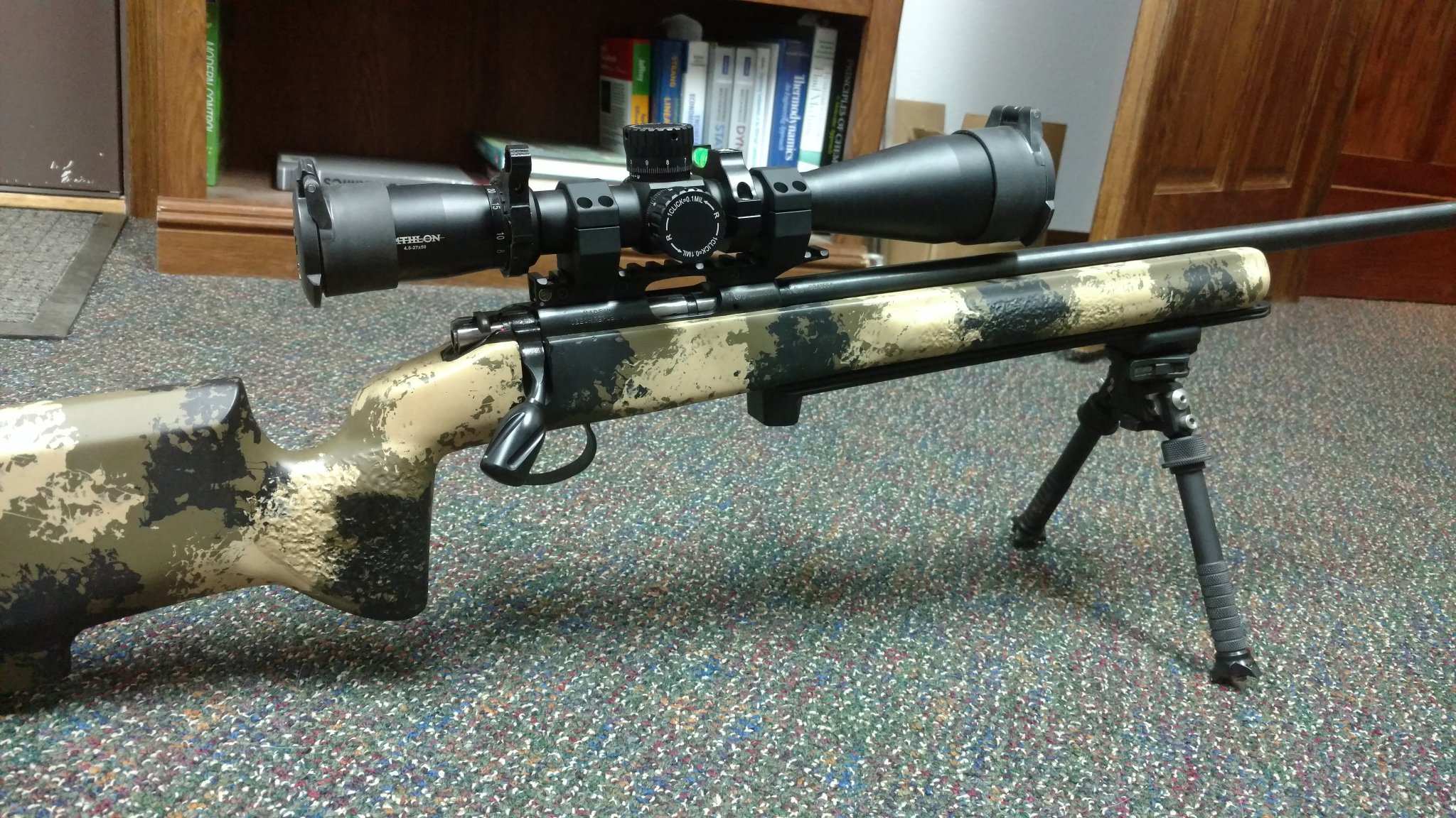

View attachment 6901939View attachment 6901940View attachment 6901941View attachment 6901942View attachment 6901943
What rail is on the bottom? Good looking stick tho
I also installed one yesterday and I was not so impressed. Seemed draggy on lift and closure. And also with 2 different bolt knobs it hits my knuckle.
I was not impressed at first either. Mine was dragging also but it quickly smoothed up after cycling it about 20 times. I will see how it feels after the lube drys out more. For my hand position the knob is very close to my knuckle but does not touch it. I hold the manners a little lower so I can index my finger a little lower on the trigger. However, if I adjust to how I see some hold the manners with their thumb up to the flat behind the bolt then the bolt knob hits just above my knuckle. Thanks for pointing that out as I overlooked the various hand positions people use.

Received mine yesterday and will confirm it felt exactly like Tactical Taz's. A little tight when first installed, and was dragging a bit when cocking the striker. A little lube and about 30 cycles and it smoothed out nicely. I got the same knob as Taz and it is a bit too long for my liking. If you run your hand really low on the grip, your finger won't touch the knob, but I'll probably replace the knob with something smaller (maybe a round ball).
Also, I measured headspace with both bolt handles. These readings are from bolt face to receiver face. Factory handled = 1.23325", Anarchy handle measured 1.23570", so an increase of .00245" in headspace with the Anarchy handle.
Overall I like the feel of the handle, but the knob is a little big. I might even bend the handle a bit to make the sweep angle a little less, but I'm going to try it with a round knob (AI style) first.

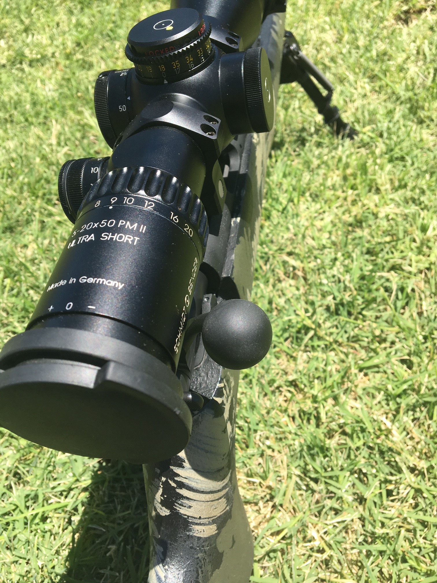

I ordered a PTG round knob from Midwayusa last night. It's .875" diameter, so I'm not sure if it will be too big or not. PTG also makes a tear drop shaped knob that looked pretty nice. I should have ordered both to save on shipping, as they were only about $10 each. I'll update with some pics of the Anarchy knob and round PTG knob with knuckle clearance when I receive it.

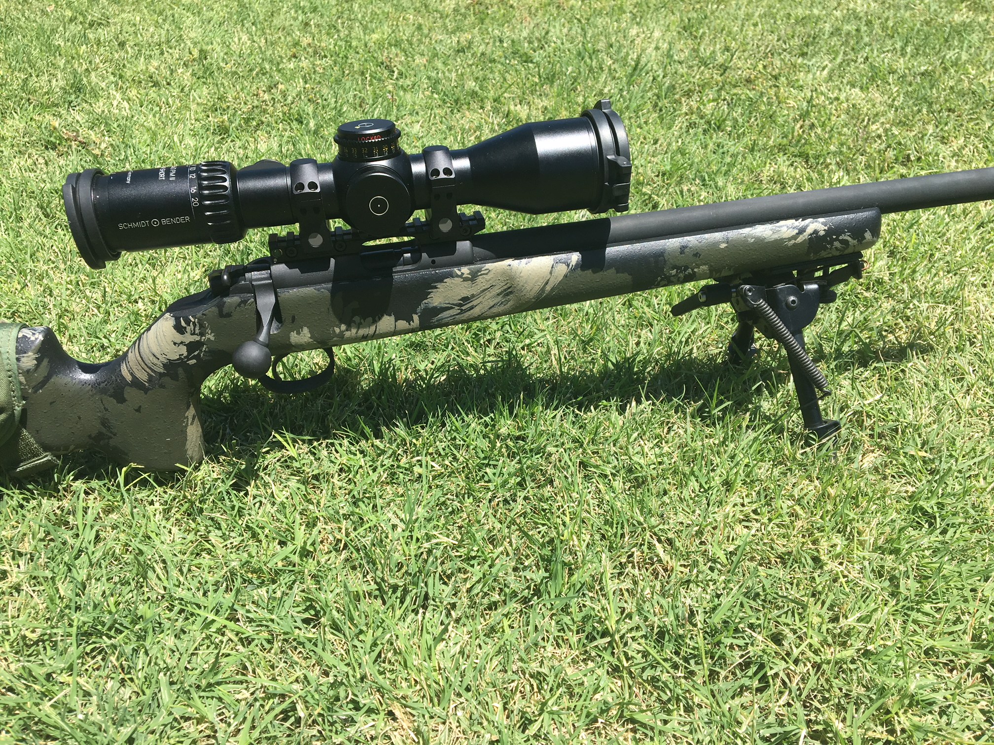

Update: I finally finished my 455 and below is a pic of it with the Anarchy bolt handle and PTG round knob. Clearance is perfect with the S&B and the round knob does not touch my trigger finger, unlike the Anarchy knob. The PTG round knob is the perfect size in my opinion for this application.
Shot mine quite a bit at the range today as it is shown above. Feel is awesome for me and makes the action run a bit smoother when running it fast. I do not notice the hitch on cocking the factory knob/handle gave. Didn't have any roughness to the throw at all in any portion. My buddy and I put about 400 rounds on it today with positional practice. I did not have any problem with my knuckle hitting the Anarchy fluted knob shown. As mentioned earlier, I do sit my hand lower on the stock and index my finger off the bottom of the trigger close to the guard.
