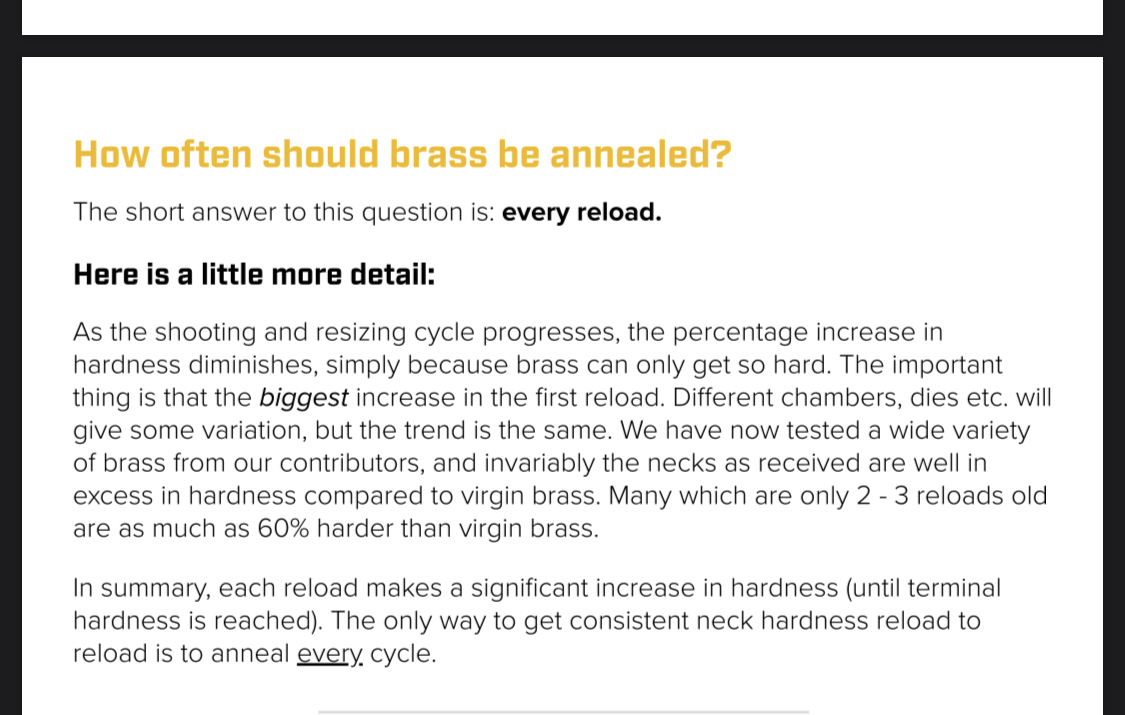

I have the Amp annealer... and enjoy the process... but, in speaking with the Redding technical rep he advised NOT to anneal every firing, suggested every 2-3 times due to “softening” of the brass and “brass transfer onto the die surface.... even quoted “Alex” from Amp saying that was Amp’s guidance. Anyone experience “brass transfer”?
This is from Amps online manual
