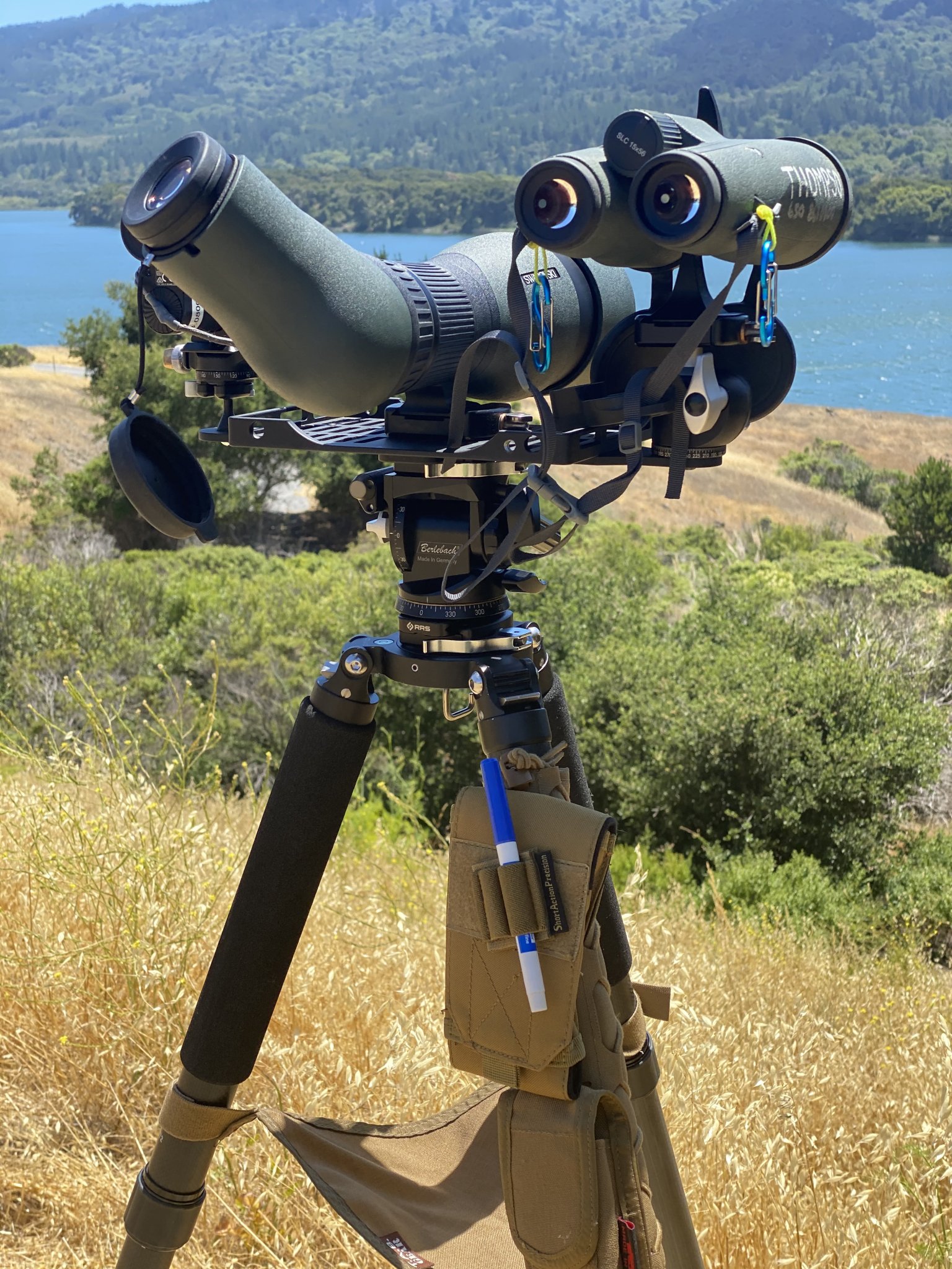

I stay with angled because I can block a lot of ambient light with my head or hat.
these are all co-witnessed.

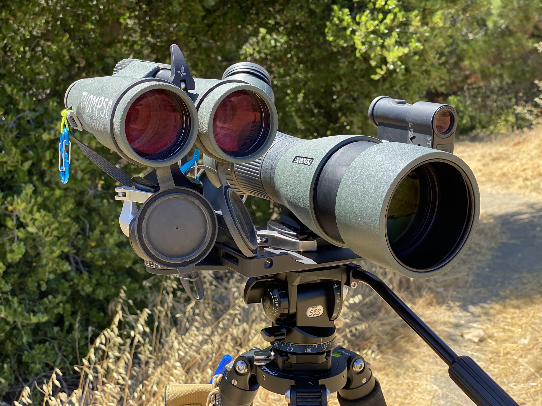

Just your basic cheap starter kit.
