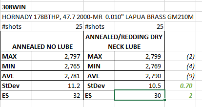

I started annealing with salt bath method few weeks ago and ran some annealed vs not annealed tests over the weekend with identical loads.
None of the brass (all Lapua) has ever been annealed before the test. I haven't kept track of number of firings but 260 has to be around 15 . Primer pockets are almost gone. 6.5x47 and 308 have probably been fired 8-10 times. Primer pockets for both are still tight specially the 6.5x47.
Brass has been prepped identical for both groups except annealing, and all powder/primer/brass/bullets are from the same lots and have been reloaded the same time.
There was no measurable difference between group size at 100 yards for annealed vs not. All shot around 1/2".
25shots were fired for each load w/MagnetospeedV3

How did the seating operation feel between them? I’d think taking 15x .260 vs 15x/annealed would be easy to feel during seating. I know mine did when I started.
Answers to some of the questions:
My brass prep process after shooting is as follows: decap, Tumble w/corncob. clean primer pockets, body size, neck size, expander mandrel (0.001 for 6.5x47/260, 0.002 for 308), chamfer/deburr, ultrasonic for 20-25mins to get the lube off, dry, and reload. I check every few firings for case length, compare it to the chamber length and trim if necessary.
Used Ballistic Recreation system. Temp was between 510c +/-10c for 5-7 seconds. To be honest I did not feel any difference when seating the 260 bullets. Maybe without using the expander mandrel difference would be more noticeable. 6.5x47 felt a little different when seating the bullets. Hard to explain but the annealed felt less smoother than not annealed.

If you anneal incorrectly you’ll make the necks too soft and the Es/Sd will suffer. If you seat the bullet directly against an annealed surface you’ll double or triple the neck friction and the performance will likewise suffer.

I don't think AB used any dry lube in their test (nor above) so that could make a difference. But would need to test again unannealed with dry lube vs annealed with dry lube. If OP feels like rerunning, it would be cool to see if that helps.
Maybe choose one of the loads where SDs increased after annealing.
Interesting re seating bullets directly to an annealed surface. i wasn't aware that could be an issue. I can do a similar test for the 308 with redding dry lube to see if the results will be different.
I've had some pretty good results shooting the 6.5x47 with virgin brass which is direct contact with annealed surface. This is from couple of weeks ago.
140HORN BTHP 37.2VARGET 0.010" FED GM205M

It’s true, though. Factory brass is annealed as the final step, then tumbled to remove the oxide and/or tumbled in carnuba wax. If you compare the seating feel of a bullet into a factory new neck vs a freshly annealed neck you’ll see a huge difference in seating pressure. The annealed neck will feel like it is lined with sandpaper. The factory new neck will seat smooth.
