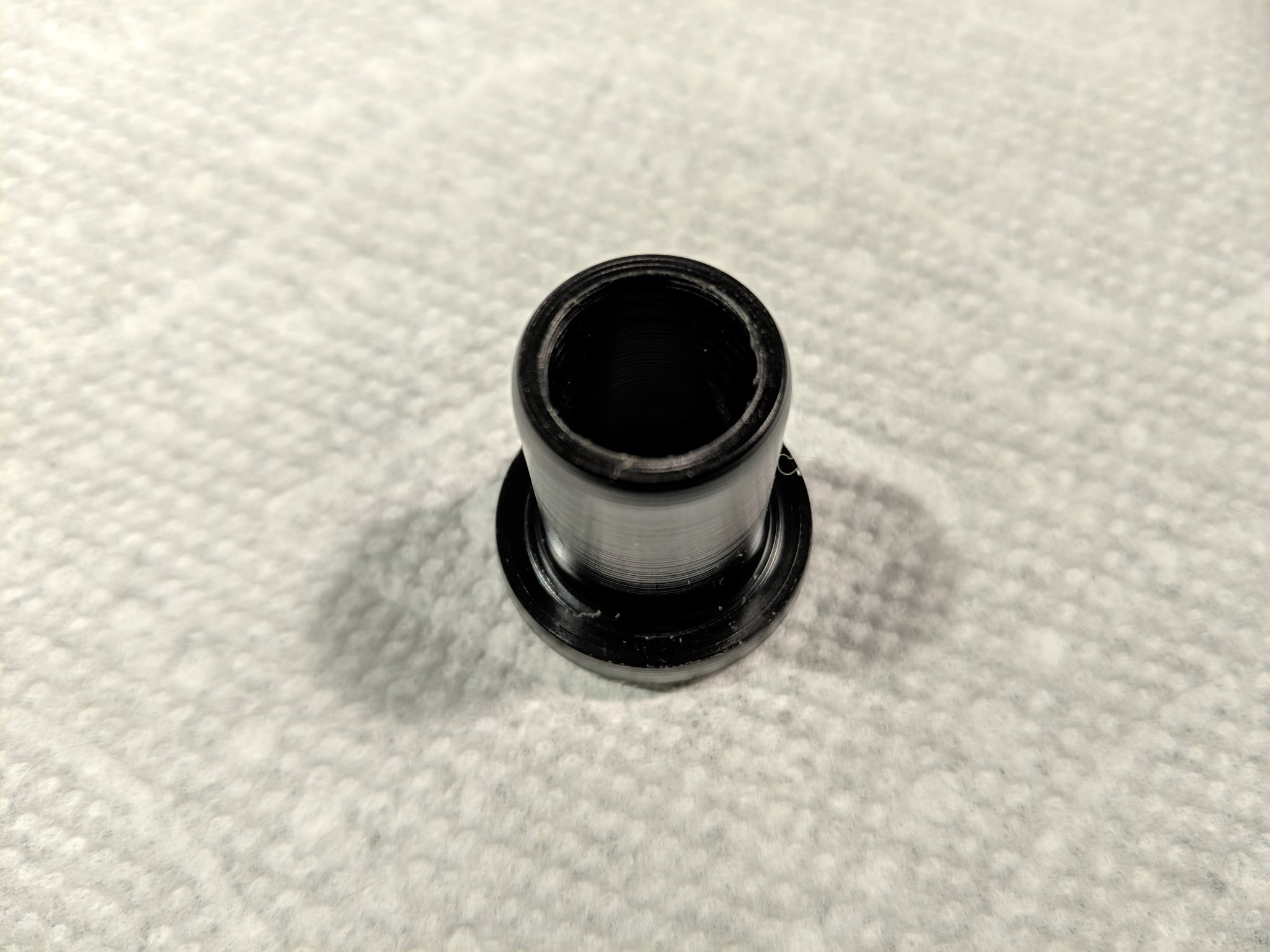

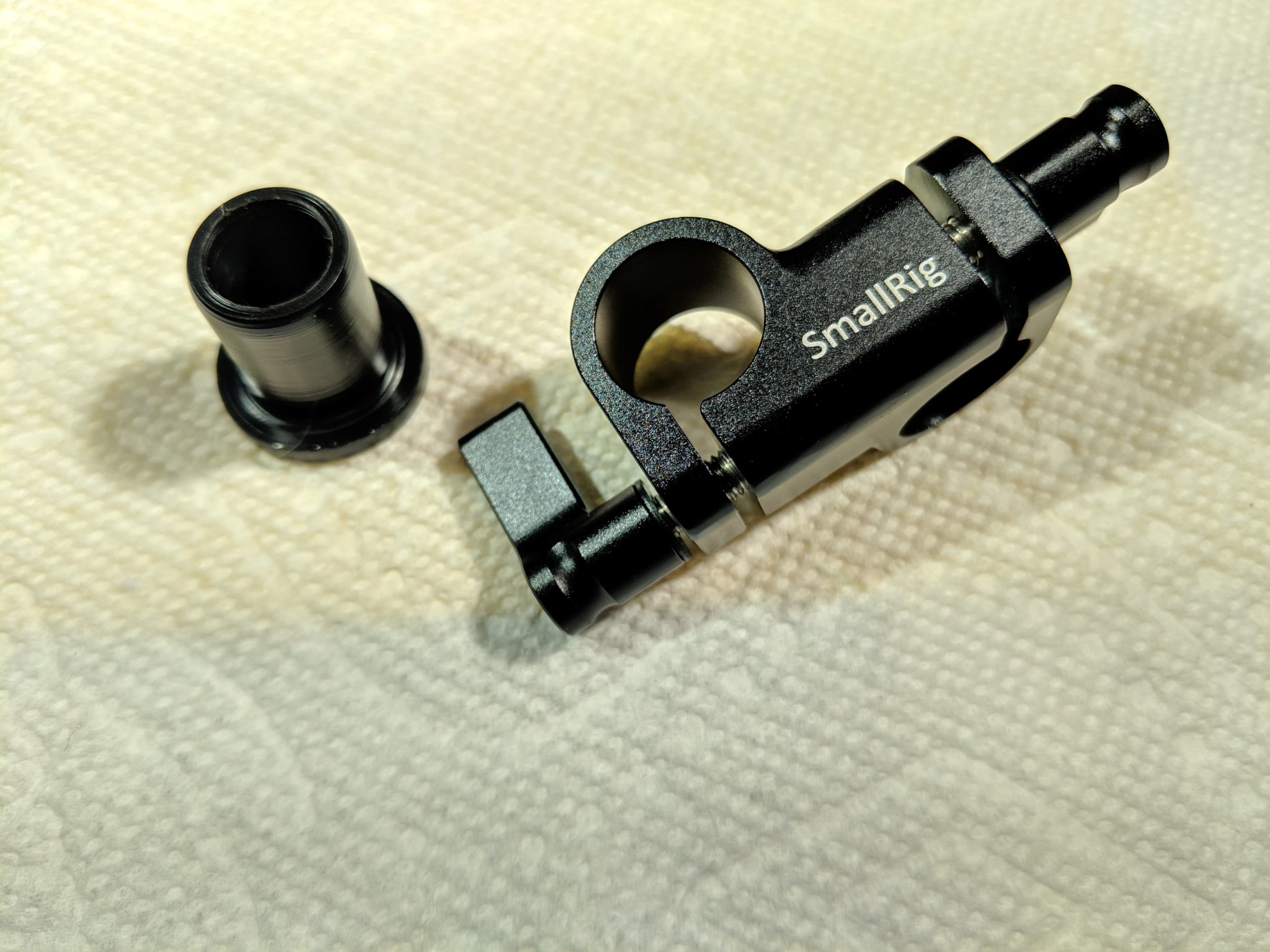

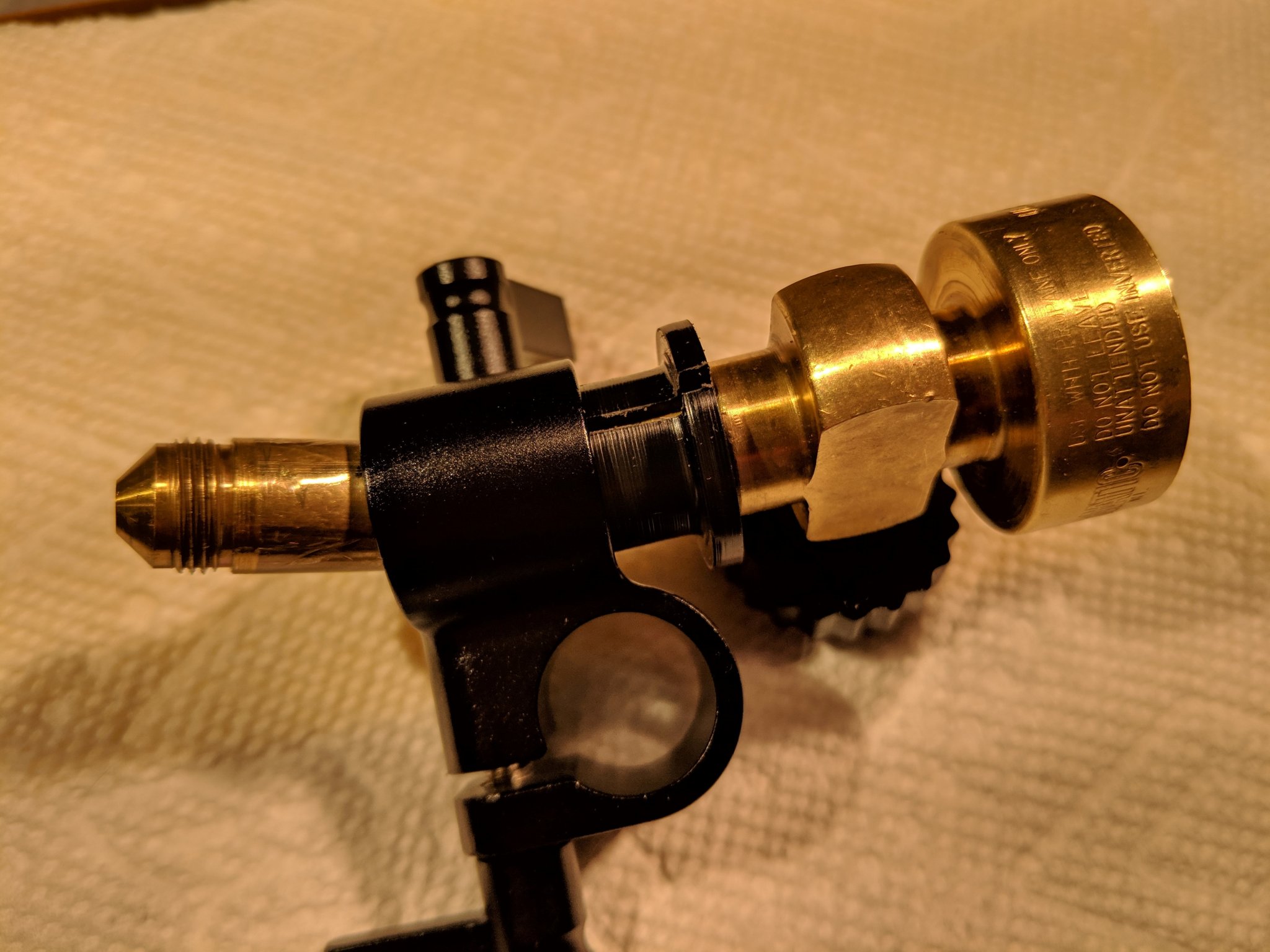

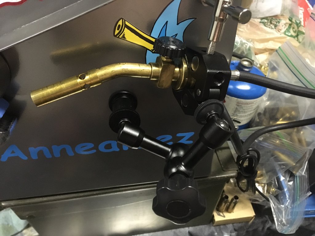

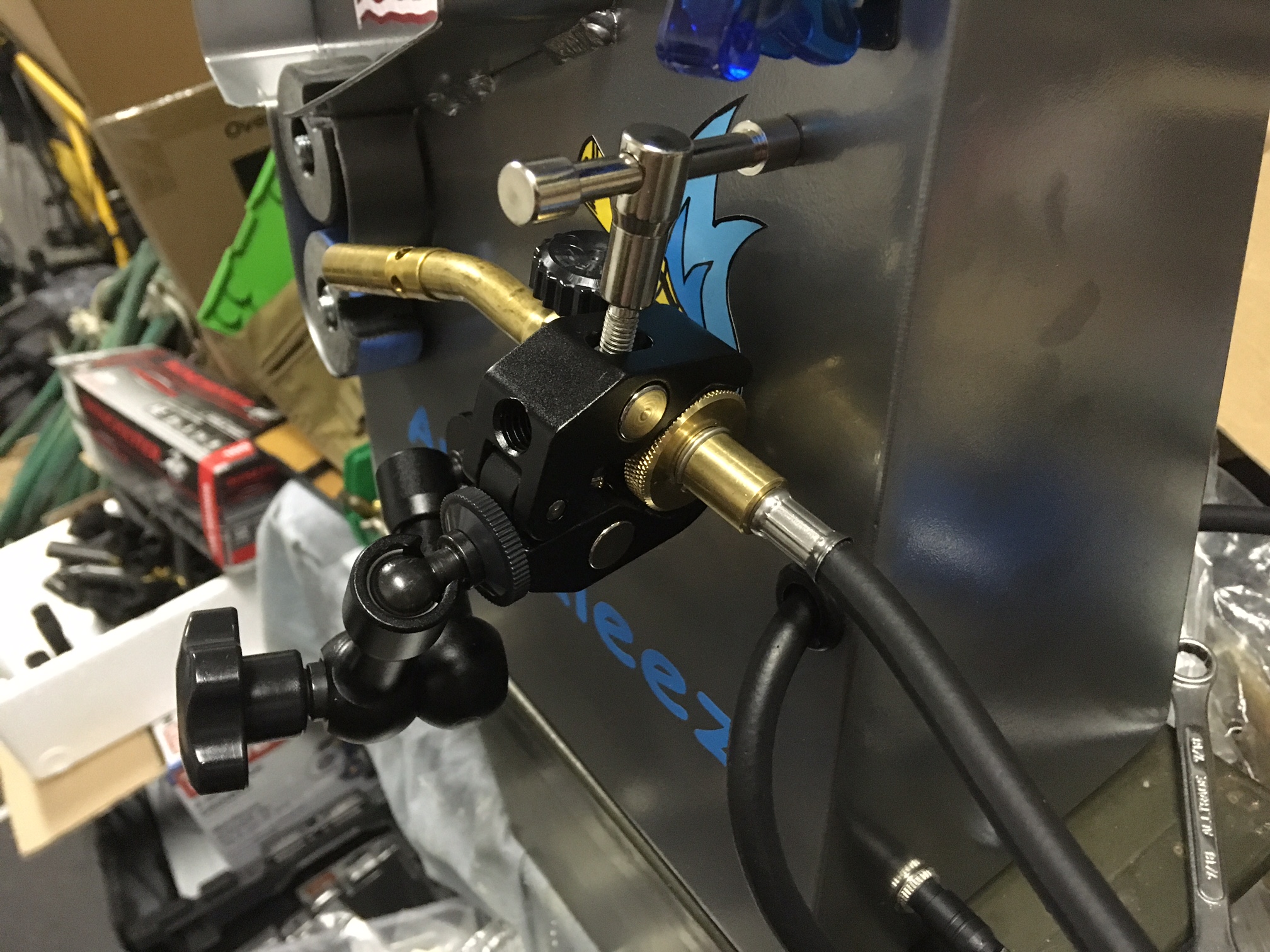

For me the $15 to swap in an articulated arm versus the very basic torch holder setup the unit ships with was a no-brainer.
I've seen the part but I don't see a video online of how the torch is adjusted with the new arm. I think this may be my Father's Day gift

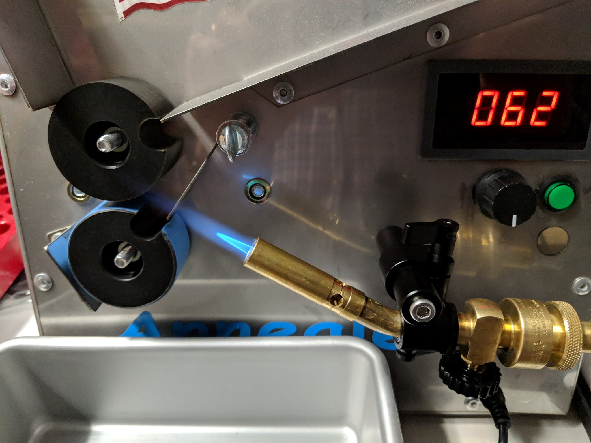

Lastly, the torch upgrade itself lowered my annealing times. I have like 3 torches now but one of them is leaps and bounds above the rest.
As Padom has already started in post #s 3 ,26 and 40 Bernzomatic TS839T for which as of this morning harryepstein.com had one left .So which torch would you recommend after your testing?

I have not tried any of the other torches. Mine still runs great. What is wrong with running one of the standard torch heads that thread onto a pound bottle of propane?
Correct, the new torches we tested are WAY more efficient and effective than the torch that comes with it. They are hotter with a better flame design which means more consistent heat control to the case and less time in the flame.
So both the swirl and newer model we have been using are no longer made. Looks like the new replacement is the TS99. I would buy one of those and see hot it is. Someones gotta be the pioneer. lol. I still have all 3 of mine. The original, the swirl and the TS839T which is the best.

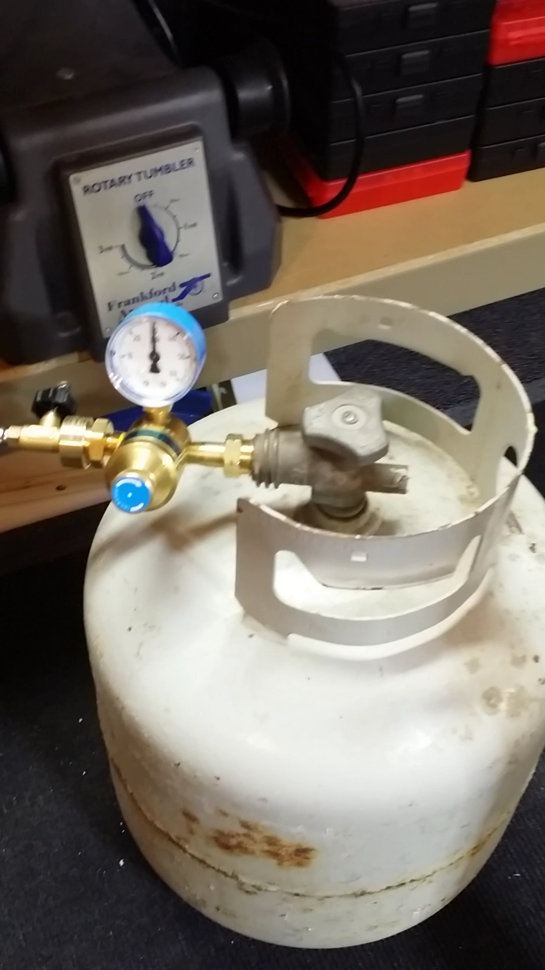

Also for the PWM is it self explanatory how to rig it up?

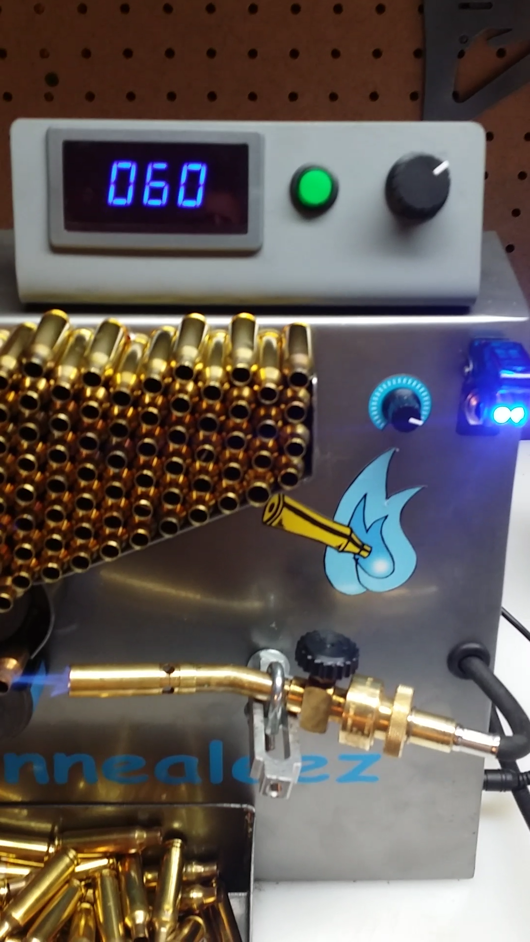

So I have a ball valve just after the regulator and one on the torch head. I keep both wide open and just use the regulator to... regulate! I turn mine off just as you do. That is a good idea about bending that plate. the brass rests against it and the wheel. I can imagine you want more weight on the wheel side so that there is more friction (and consistent rotation). I "think" I read somewhere (can't remember where) about how to clean and/or surface the wheels to ensure good contact. I forgot to mention that my brass is very clean via wet tumbler.Do you have all of yoir balves all the way open when adjusting the regulator? I leave all of mine open and adjust the regulator to control the intensity of the flame. And when im done i just cut off the valve that controls gas flow from the tank and let the flame burn out. I also had to bend the metal tray that is directly beside the case as it is turning on the wheel. My 30-06 cases were kinda wedging in there and not rotating smoothly. It did not affect the function of the annealer on smaller brass.
So what did you do for those cases that don't spin for a bit. It "looks" like painters tape on the wheel, would really like to know what to do to keep them rotating
I took a quick look at your combo of regulator, hose, adapter, etc. I "think" that would work. Not sure I understand the 60 PSI gauge with a 0-30 PSI regulation range. Maybe it is to handle pressure spikes when the valve is opened (which I am not seeing with my tank). I think the idea of swapping out the gauge with one that has a lower range was to allow better accuracy on adjustment. As to the torch, my only comment is that it is roughly 12" long so it may be unwieldy to mount and use. I expect that with a long torch head it will put a good bit of leverage on the mounting system and try to rotate it out of position and potentially create flame pointing issues. But i guess that depends upon how tight you torque down the stock mounting setup.Just ordered my Annealeez today, and after reading this thread, I would like the convenience of having mine running off a 20lb propane tank. But I need some guidance.
I see people talking about this Goss regulator, seems kinda spendy for $80.
Is there any reason I couldn't use the below item?
https://www.amazon.com/gp/product/B07GR9T2H3/ref=ox_sc_act_title_4?smid=A2KBKE1A991P4A&psc=1
And hook it up to the annealeez with these two fittings?
https://www.amazon.com/gp/product/B008E5CMMM/ref=ox_sc_act_title_2?smid=ATVPDKIKX0DER&psc=1
https://www.amazon.com/gp/product/B000BQN4IS/ref=ox_sc_act_title_3?smid=ATVPDKIKX0DER&psc=1
