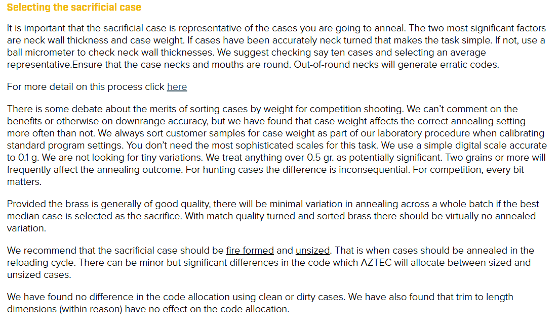

    For what it's worth, I always sacrifice a piece of my brass to generate a code for my brass. I don't rely on any codes from other folks. I want to know what my brass needs. Small price to pay.
    Reactions: Baron23
    Well, if you carefully read the AMP instructions, you are supposed to sacrifice several pieces of brass and take an average. And before you sacrifice several, you are supposed to weight sort them, and choose the several sacrificial pieces from the center of the weight distribution. (Of course, now your lot of brass is even less uniform, since you’re culling the good “center weight distribution” pieces :)
    I have a thread on this they got the AMP fans all bent out of shape because with different pieces of brass you get different codes, which kind of undermines the whole “perfect“slogan because it doesn’t matter how perfect the machine is if the cases are imperfect and they are. Even RWS and Lapua.
    Finally, the code CHANGES as you keep cycling your brass, trimming it, etc. Try it: sacrifice a case fired 5x times and compare that code to your original code from that lot. It will likely go down (cuz material has been lost from the case.)

    So the amp is better if you take multiple cases from what you are using and take the avg number to run for the whole lot your using? Then after a few firings are you needing to redo that test to get updated numbers?
    I thought everyone did that, I would never believe the info provided by other people .

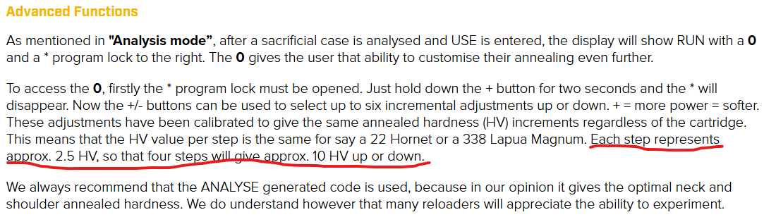

    Yes, the codes will change as the brass ages and thins.
    But I honestly don’t think the difference between say 174 and 179 Makes a bit of difference because you were going to have that much variation in a whole lot of identical cases
    Which again is why I say the “perfect“ part of the marketing is a sham. The only thing that might be close to perfect is the heat output of the induction coil for each a kneeling cycle. But because the cases are imperfect, it doesn’t really matter.
    I would think the amp would be more consistent though? Your kind of making me think that any annealer is just as good then......

    https://www.ampannealing.com/instructions/
    FWIW
    This gives you an idea of what the sensitivity of using the average case weight would mean and how much hardness value variation there is with differences in the resulting code steps. You are able to change code values yourself based on your preferred feedback method, i.e. hardness value or seating force. You can always just run them without making adjustment changes unless you want to.
