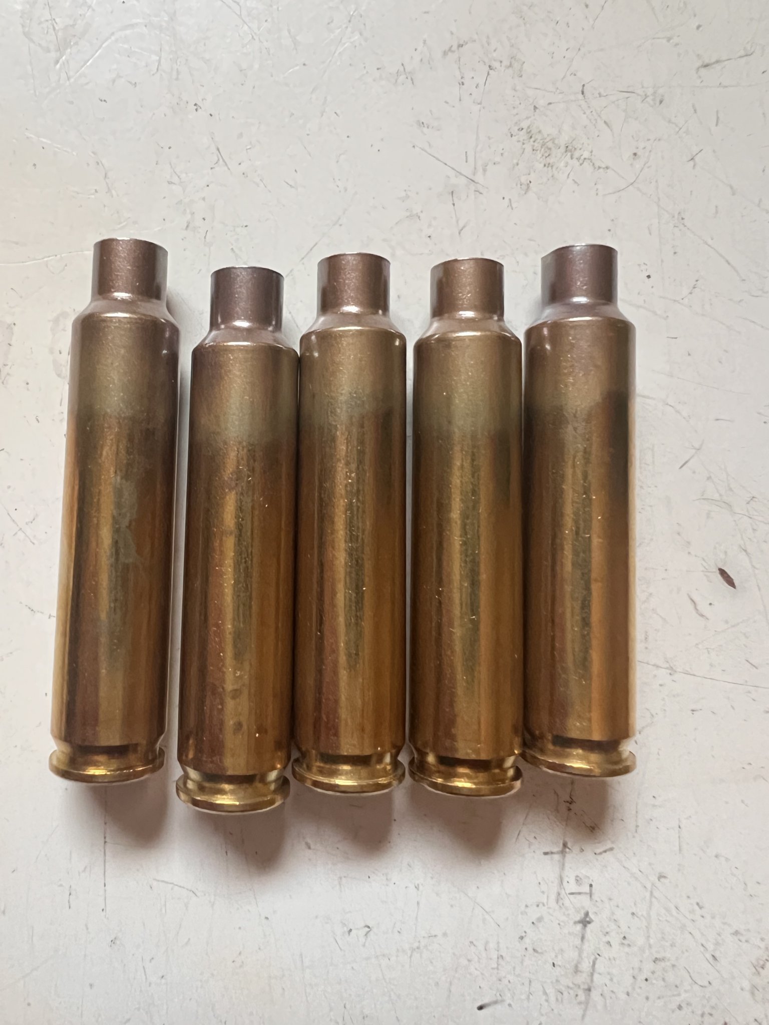

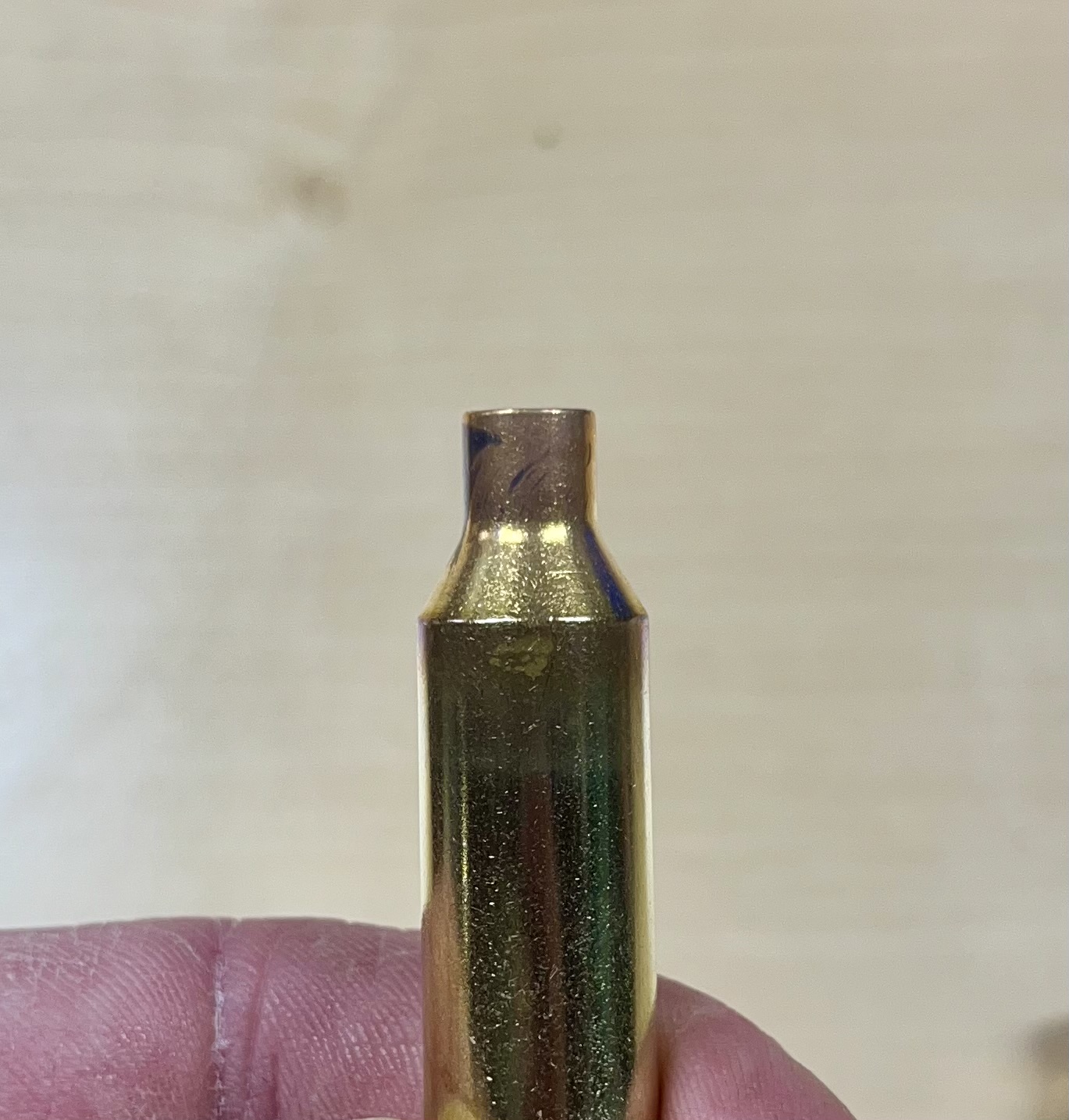

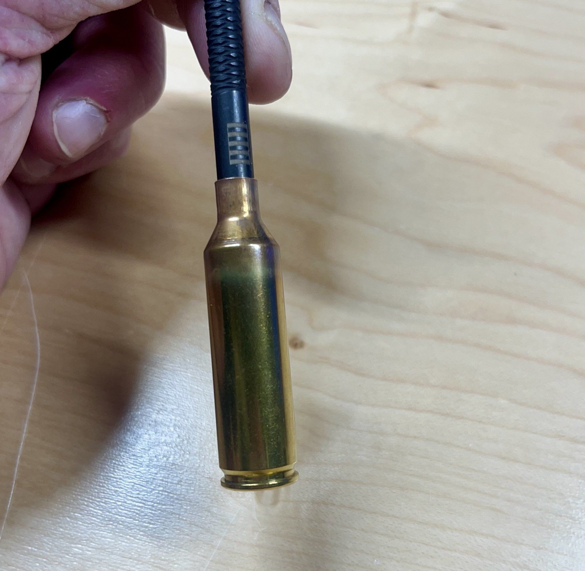

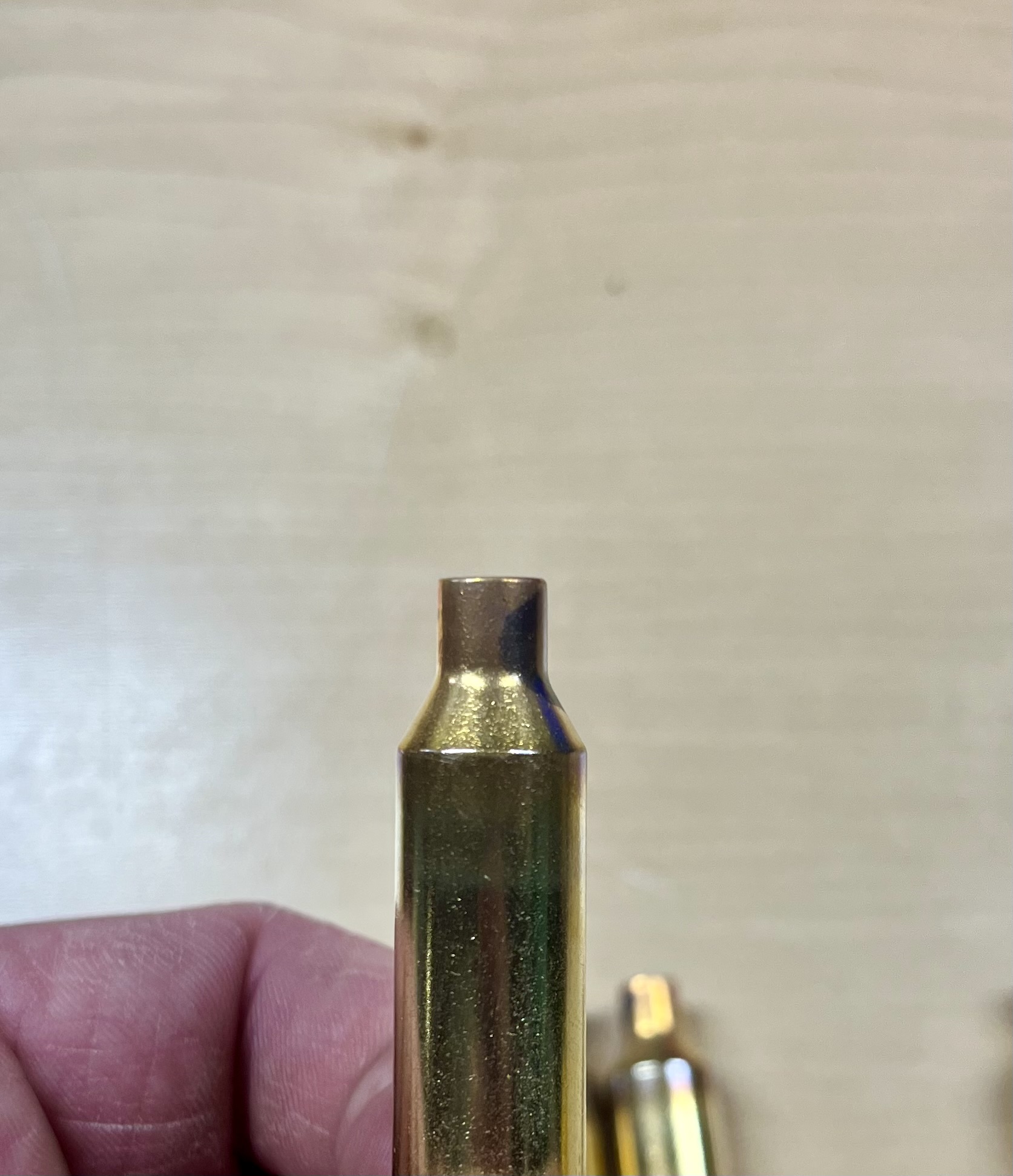

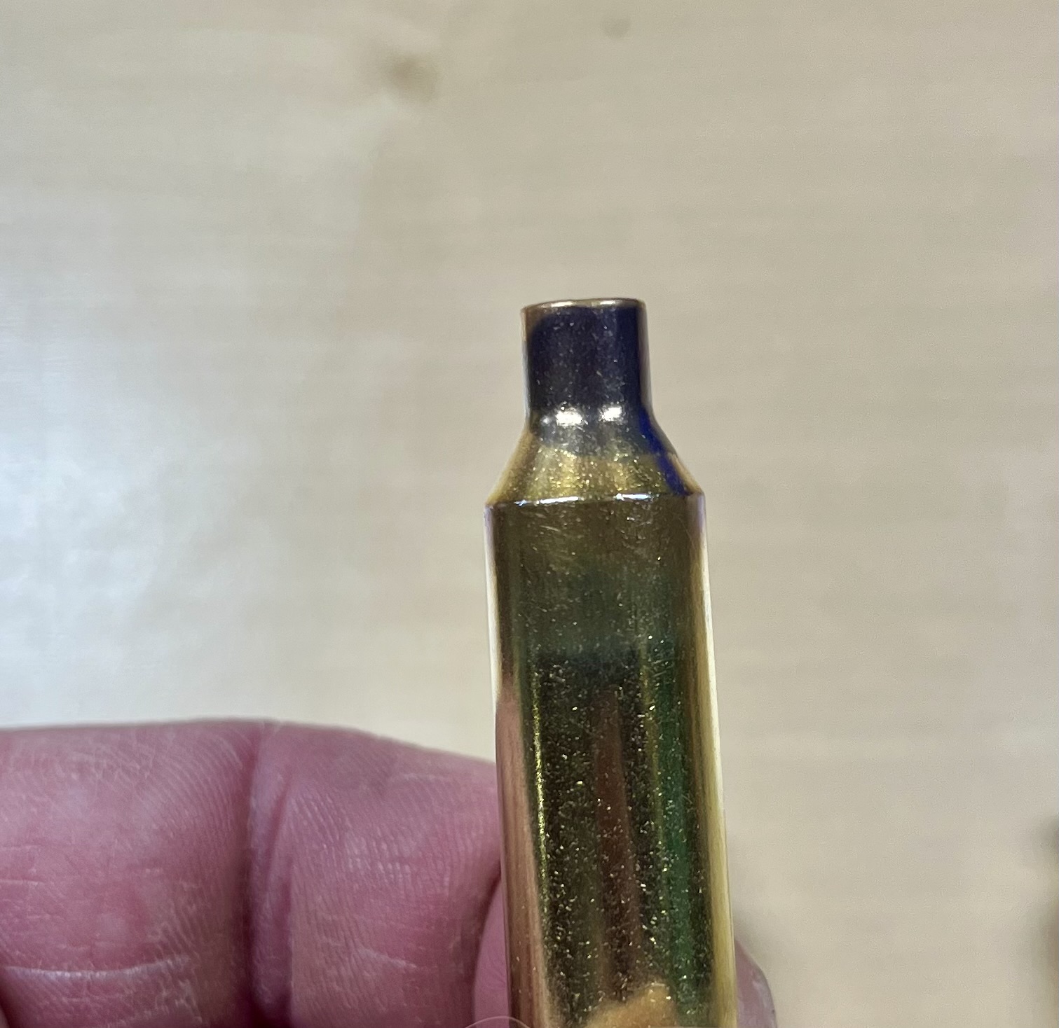

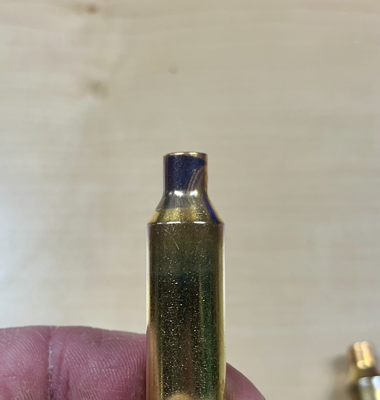

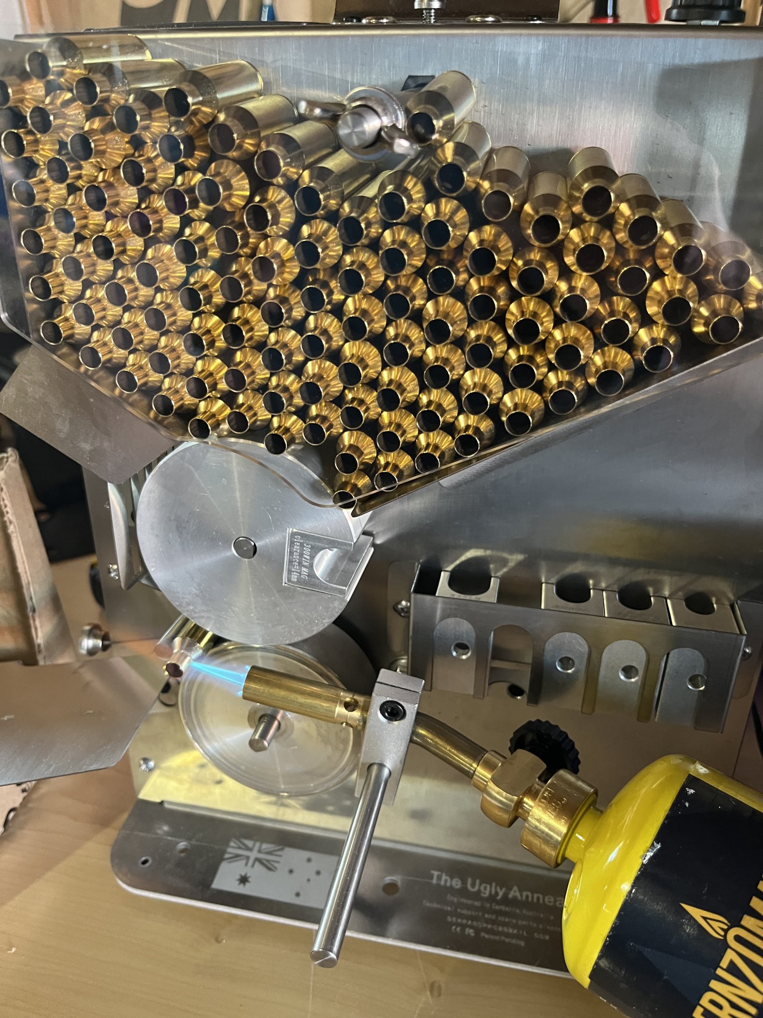

Have an ugly annealer and did about 50pcs today. Annealing until it just flashes orange while in a dark room and I’m getting these dark spots on about 2/3 of the case neck. I’m assuming it’s the last spot that the flame hits?
In the pics I’m rotating the brass
To me, it looks like left over residue from cleaning being burnt.
Reactions: Lucreau
Looks like left over residue as noted above. Maybe sizing wax?
I anneal as my first step in reloading so only have powder residue which doesn’t do that on mine at least
Are you doing stainless tumbling? I have seen kinda similar marks when annealing if I didn’t wash the brass really well and still could had a thing layer of soap or cleaning agent on it.
I get very small blue marks sometimes that I think are that.
Yeah I’m using steel chips. That was my thought as well was there might be some soap residue left ovsr
Reactions: Kadams1563
