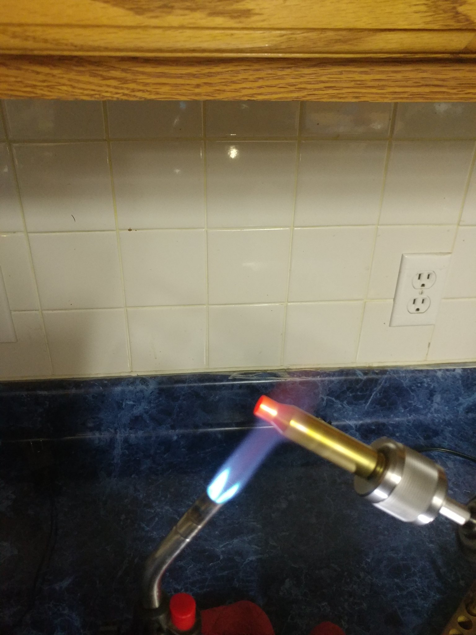

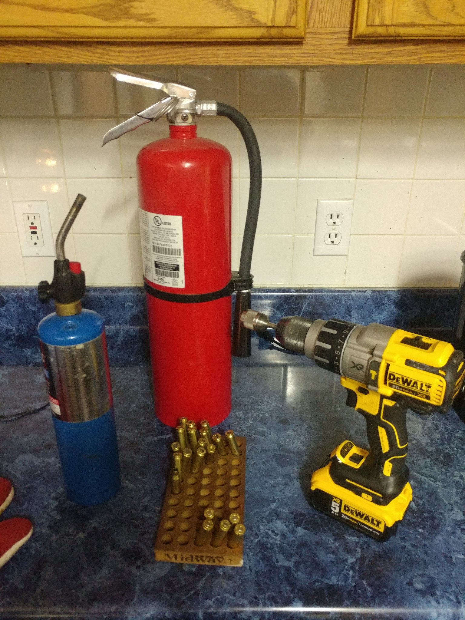

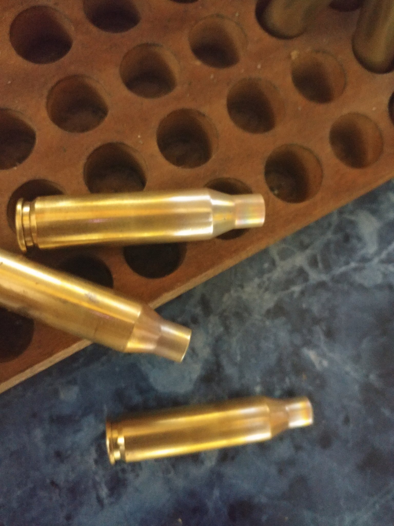

I did three of these to see how they came out. I'm pretty sure I overdid it. Please go easy on me this is my first try at this with some random brass

Echoing what others have said, and adding what little I do know, that first picture shows too much heat.
You've got the right idea though for a quick and dirty method of annealing on the cheap. Only things I would add would be shut the lights off (as stated by others), a deep socket to hold the brass (exposes only what needs to be annealed and serves as a heat sink for the rest of the case), and a pan/bowl of water to dunk the brass into after reaching temperature.
The above isn't the most consistent method of annealing, but is about the best you can do without dumping money into dedicated annealing setups.
We all learn the same way, by doing. And I would say you're smarter than most for posting pictures and asking the more experienced folks here. And you got a fire extinguisher in hand, which you may need if you keep it up. lol
Not everyone can afford a $1,000 annealing setup. And many great shooters have used the same drill/socket method you're trying including a recent 50 BMG world champion I spoke with on the phone. But it will take some practice and patience. Consider adding a metronome app to your phone.

Looks reasonable (maybe a bit bright orange) but really just get some Tempilaq. I run my Skip design annealer so the 750 burns off about 5 sec before the case leaves the flame.

To check what you are achieving you can check the following. If you overdo the heating of the mouth the bullets will not stay in place as the brass will have no springback. If you try and crush the bottom above the rim with pliers and its not difficult your method overheated the base and softened the brass.
In either case too much heat for too long.

WTF too hot.
if you don’t have a consistent method with a machine I say don’t do it.
it’s hard enough with the Giraud and Tempilaq. Or benchmark or whatever
I would not even attempt the drill method now, knowing what I know from messing around over the years

My opinion won’t be popular here based on most of the guys above but I’ll tell you how I did it for a lot of years with very good results on target.
First I ditched the drill for a powdered screwdriver. The speed is way more appropriate for annealing and your finger won’t get tired from trying to not go too fast.
Ditch the case holder for a close fitting socket. Some cases will do well with a deep well and some will need a standard depth. Much easier to get cases in and out and keep the pace up a little.
A nice steel pan to drop the hot cases on is nice to have.
With the flame perpendicular to the case, aimed at the body/shoulder junction. I ran cases until they were a full orange on the entire neck in a very dimly lit room. Like almost so dark that you can’t see. Your eyes will adjust and the flame gives off light while you’re working. Once the proper heat is achieved, dump it in the steel pan and start another one. You can count in your head or use a metronome if you need to. Not all cases will take the exact same amount of time. Sometimes you’re not in the exact same spot in the flame, or the neck is a little thicker or thinner.
It doesn’t have to be perfect to work.
As above it can be done esp if guided by Tempilaq or a dark room. There are 4 consequences of getting it wrong. I am on record saying it don’t need to be ‘perfect’ but.....
1. overdone neck unalterably removes tension. Do it on purpose and squeeze neck with your bare fingers and you’ll see what I mean. Brass permanently softened now. Compare to normal case. What was the point of it if that’s the result?
2. overdone and base got too hot. Case permanently destroyed
3. Under annealed - I did thousands I’m guessing on the Giraud like this because I was worried about 1&2. With this, you just wasted a giant pile of time. What was the point if that’s the result
4. Inconsistent anneal leading to inconsistent neck tension. No point in that either
problem is, without a consistent technique, you don’t know what you’re getting as a result and how much of 1234 above is in the mix of your batch.
