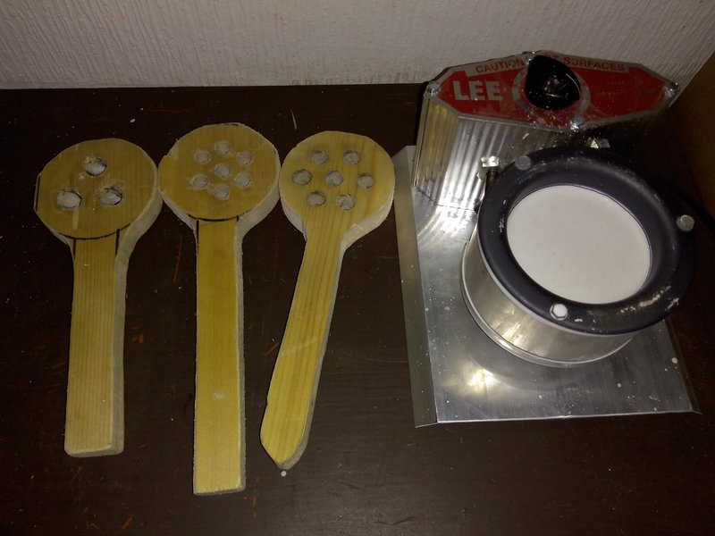

I have been experimenting with salt bath annealing for the last month.
I made a bunch of wood shell holders to hold cases to dip into the salt. Took me about 15 minutes per wood paddle to make them. I made one for .223, .308 sized cases, and magnum sized cases. I just drilled the holes to where the cases fit snug. I press the cases in until the head of the brass is flush with the wood paddle. I then dip the cases into the molten salt until the paddle touches the top of the smelting pot. This gives me a very consistent anneal depth. I wait 5 seconds and pull the brass out, dip the case mouths in a bowl of water briefly then dump them all out of the paddle into another bowl. You need to dip them in water to solidify and flake off any salt left on the necks. You don't have to rinse or dry them if you do this correctly as the heat in the brass evaporates the remaining water droplets. I can anneal 100 pieces of brass in less than 10 minutes because I am doing up to 7 in every dip with my .223 and .308 paddles. I also sprayed the bottom of the paddles with some heat resistant paint. Switching calibers is as easy as grabbing the other paddle and brass. IMG_20171220_204919192.jpg
There are basically no consumables with this method. You simply turn the pot off when you are done and the salt solidifies. Next go around you plug it in and wait for the salt to warm up.
Wear safety glasses and make sure there is no water on brass when you dip it or you will get the frozen turkey in a deep fryer affect.
Here is a pick of my setup.

10 to 15 seconds would overheat the brass I believe. I wouldn't want to go longer than 7 seconds. The heat transfers rapidly through the brass.
Also, this thermometer works fine for check salt bath temp. https://www.amazon.com/gp/aw/d/B072Q6DMXJ?psc=1&ref=yo_pop_mb_pd
I have found that the Lee pot hits a steady state temp of about 950 degrees if it is filled to the level in my above picture and left on the highest setting.
