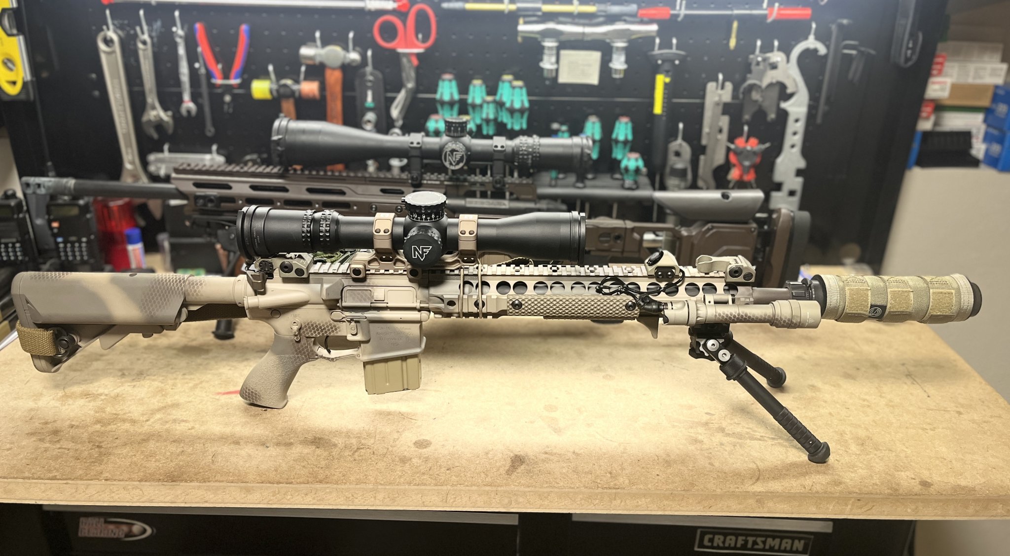

My favorite optic for an AR-15 that will be shot at longer ranges is the ATACR 4-16x42. Great reticle options, great glass and they did the Leupold turret better than Leupold. Can be picked up from Eurooptic as a demo that’s real close to your budget.

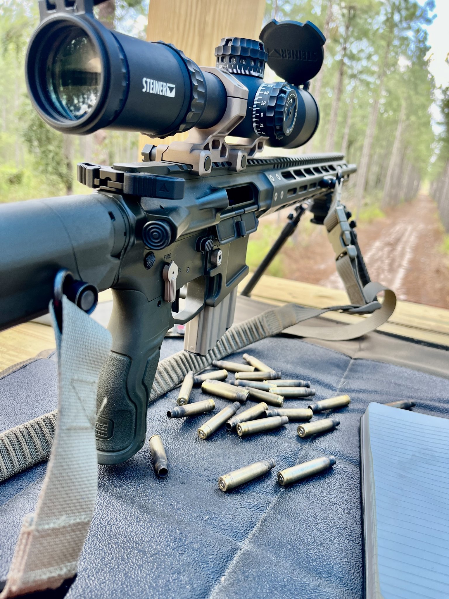

Is that new range in the pic with the firebreak cut in the pines? I can imagine why you wouldn't get much wind! LOL
I don’t use the turret for Windage, I use the reticle unless shooting a group is what I meant by that. Yeah it’s not the prairie in these pines but more wind than you’d think and it’s usually a full value wind since I’m set up shooting North.
If only they all could be North facing ranges! E-W ranges really put one to task with the head and tail winds. Then the Sun can dick things up early morning or late eve depending on direction. First world woes I guess.
