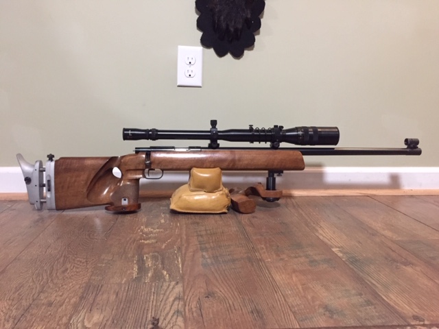

45 years ago I shot small bore rifle competitions with this rifle and just by dumb luck was able to recently re-acquire the rifle. I would get a big kick out of my kid shooting this as well. Has anyone ever thought to try and put a modern day optic on a rifle like this? I'm sure it will prove to be more for nostalgia than competitiveness, but I'd sure like to try.
Thanks in advance,
Bob

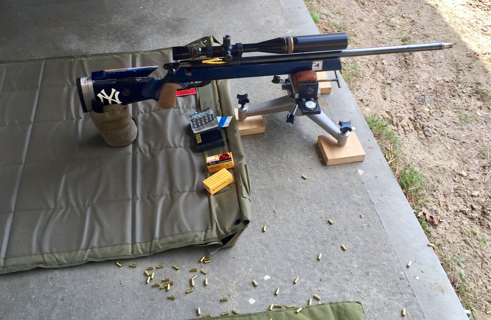

The BEST rings for the Anschutz rail are probably the Kelbly sets. Have them on my 54 Silo, as it doesn’t get fired in the dirt.
That said, they don’t make a cantilever version, and it’s hard to get a scope far enough forward on the 54 receiver for Prone without getting the scope out over the barrel.
Thus: a BKL mount on my 3P RF Sporter rifle.
Just be damn careful with it, as the little mount has a wholllle bunch of leverage working against it.

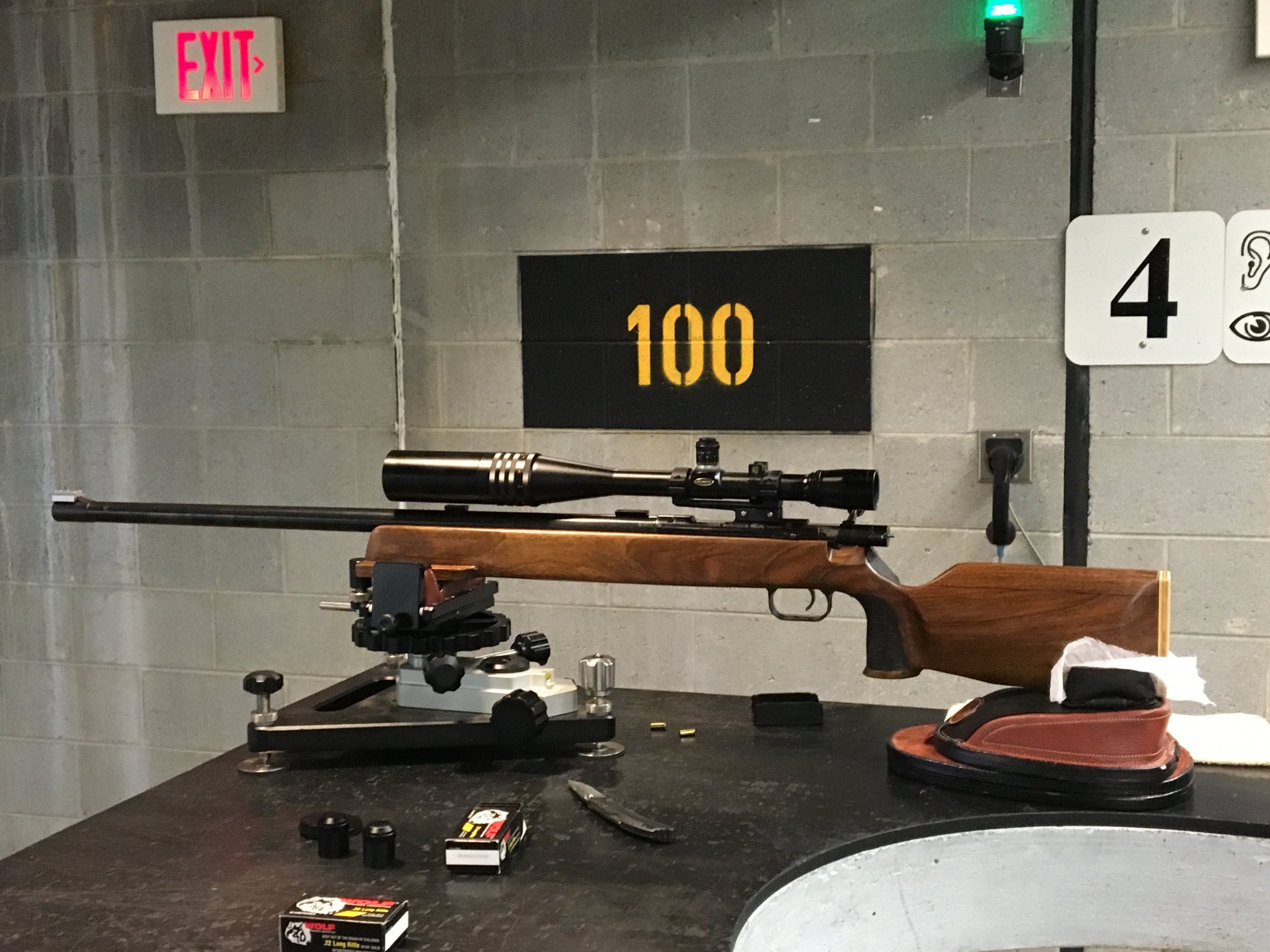

I don’t shoot prone with this rifle. Just bench rest and in that mode it is fine. My scope is a T36 and i found that i could not get enough down elevation so the version of BKL mount i had to by had a weaver rail. Then i used Burris z-rings so i could turn it into a 20 moa rail. Then everything is fine.
one thought about having it far enough foward is to move the scope far enough forward so both rins are behind the turrets. I have seen that done also
David
I have heard of that, but have never seen it. Why the need 20 moa of elevation? How far are you shooting a .22?
I really don’t know why i needed the 20 moa. I do know that T36 don’t have a lot of elevation and windage adjustment. That was what i attributed it to. My T24 that I originally had on it had no problems.
I am only shooting shooting 50 and 100.
David

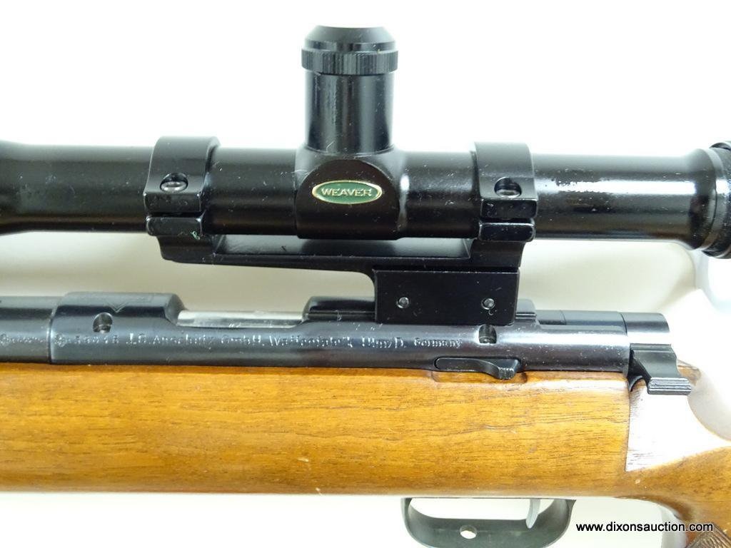

@Contender-1 I used these for a '67 Super Match. They are an elegant solution from an engineering stand point. They are very easy to use, very reasonably priced, work exactly as described and with Burris Signature Z-rings allow you to build in elevation.
The problem the OP and I have is that the older Match 54 do not have an extension of the 11mm rail on the front bridge. Your solution would indeed be a good one because your 67 does have the extension of the 11mm rail.
David
