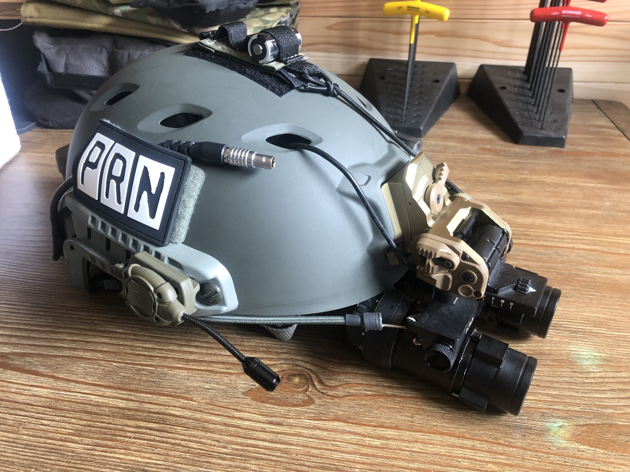

Here’s my setup. Open to suggestions.
Reactions: Kayakfish1
- I've never seen that mount for an ANVIS; not sure what it is, but chances are if its not some version of the surface mounts linked above, its some kind of airsoft something. Does it have the force to overcome disconnect feature, and do the electrodues disconnect/connect to give you power to the unit when its flipped up/down? The two biggest reasons I'd look at a better mount are lockup so its not wiggling and making knocking noises constantly, and so it doesn't fall off your head.
- Get a helmet with an actual bolted on shroud and 4D pads.
- You need a dummy cord on the ANVIS unit itself; not via a piece that is held on via velcro. The shock cables are old school tech designed to take the slack out of RHINO mounts back when they had horrible tolerances. I never use them as its something else infront of my face to get snagged on shit and I've seen them seperate and hit a guy in the face below his eye. Ever since then I get the 'fishing hook in eye' picture in my head.
- Not sure if its the angle, but is the mount sitting the ANVIS very high on your face?
- You need a white/IR light on your weak side (non shooting side) for lighting up a larger area if you are searching; it will follow where you're looking and its handsfree. Mount it on the weak side so if you operate it, you dont have to come off the gun; using light at night thats attached to you is a whole other thread.
- Move the PTECH light back.
- Cable managment needs to be re-thought. A helmet cover on this (or a new helmet with a bolt on shroud) will aid in this. The only cord that should be exposed to anything as far as a snag risk should be where the ANVIS and bettery pack cables lock together. On my ANVIS helmet this is routed through a chem light holder and stowed in it when locked. Your cable for the battery pack is basically held on by a velcro patch; brush, tree branch, a million things in a vehicle, etc will rip that and your battery pack right off the helmet. Your battery pack also needs to be dummy corded and secured to the helmet other than by just velcro.
- I'm betting the battery pack isn't enough counter weight for the ANVIS unit. You'll need a counterweight pouch with it (look at the Mohawk; this will also help you with dummy cording and cable routing). My notes say my ANVIS and mount weight 26.5 ounces. Battery housing is 9.1 ounces, an AA battery is .9 ounches, a AAA is .5 ounces, a CR123 is .6 ounches, the nylon battery 'card' I have in my counterweight is .7 ounches and each lead bar I have is 3.7 ounces. Knowing what your individual shit weighs will help you balance it properly as well as be able to carry useful shit instead of just lead. Rule of thumb for us was fo NV equipment, you carried enough redundant batteries to replace all the batteries in your NV equipment once, at the same time. Chances are you weren't going to replace batteries in every piece of NV gear during the same night, but that way you weren't stuck with only a few batteries and then being fucked when you had to change out 2 or 3 pieces of equipment.
- Look into LIF inserts as well as the screw in covers for the front side for when they are not in use.
Not sure exactly what you mean here. The goggles are lined up well with my eyes. No trouble with "scope shadow" around the edges.
Got it. Just can't see it in the picture.
Dang, thanks man! All great information. I'll look into making these changes.
My purposes with this setup are different than yours I'm guessing. I'm just a lowly ex-LE guy with a handful of weapons/training courses under my belt. I'm also working on my private pilot's license. I want to hunt at night with this setup, home defense, and hopefully use them while flying at night.
*edit - you are correct on the counter-weights. I had a weight pouch on there first and then got the battery pack. It's just the pack right now, but as you pointed out, it's not quite enough weight on the rear. I'm hearing you say there's a way to run both??
