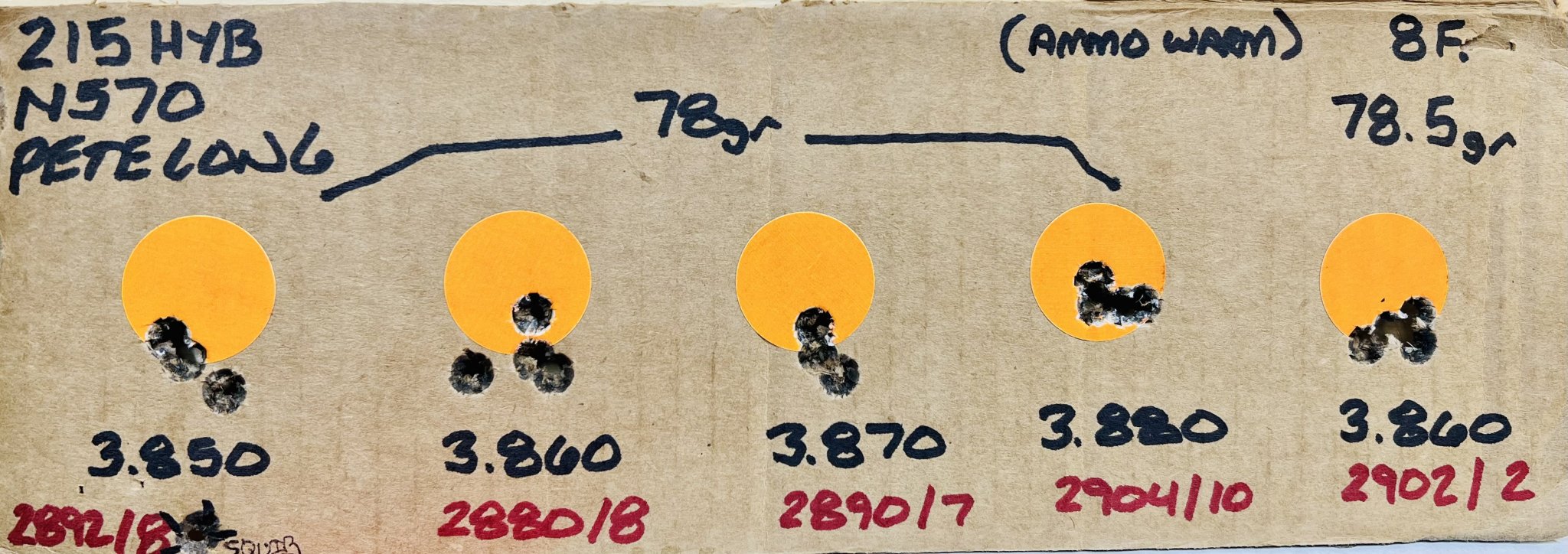

Each development I find the lands, load on the lands and back it off .010-.050 if needed while measuring primer pocket growth from virgin state. First go with 215 Hybrids with the 300WM. Pockets grew .0005 with the CBTO 3.850 and on the lands at 3.880. Then .5gr increase showed promise and 2SD. Next run will be 78.5gr and 3.870. Thinking the 3.870 and 78.5gr will be the ticket. This is how I go about it.
That's pretty impressive sir. Your method makes complete sense. I've been loading 22-250 for 20 years. Many a coyote and ground hog paid the price when I lived in Kentucky. LOL But I am not super familiar yet with my new 7mm Rem Mag rig. I appreciate you taking the time to respond. TY very much sir.
