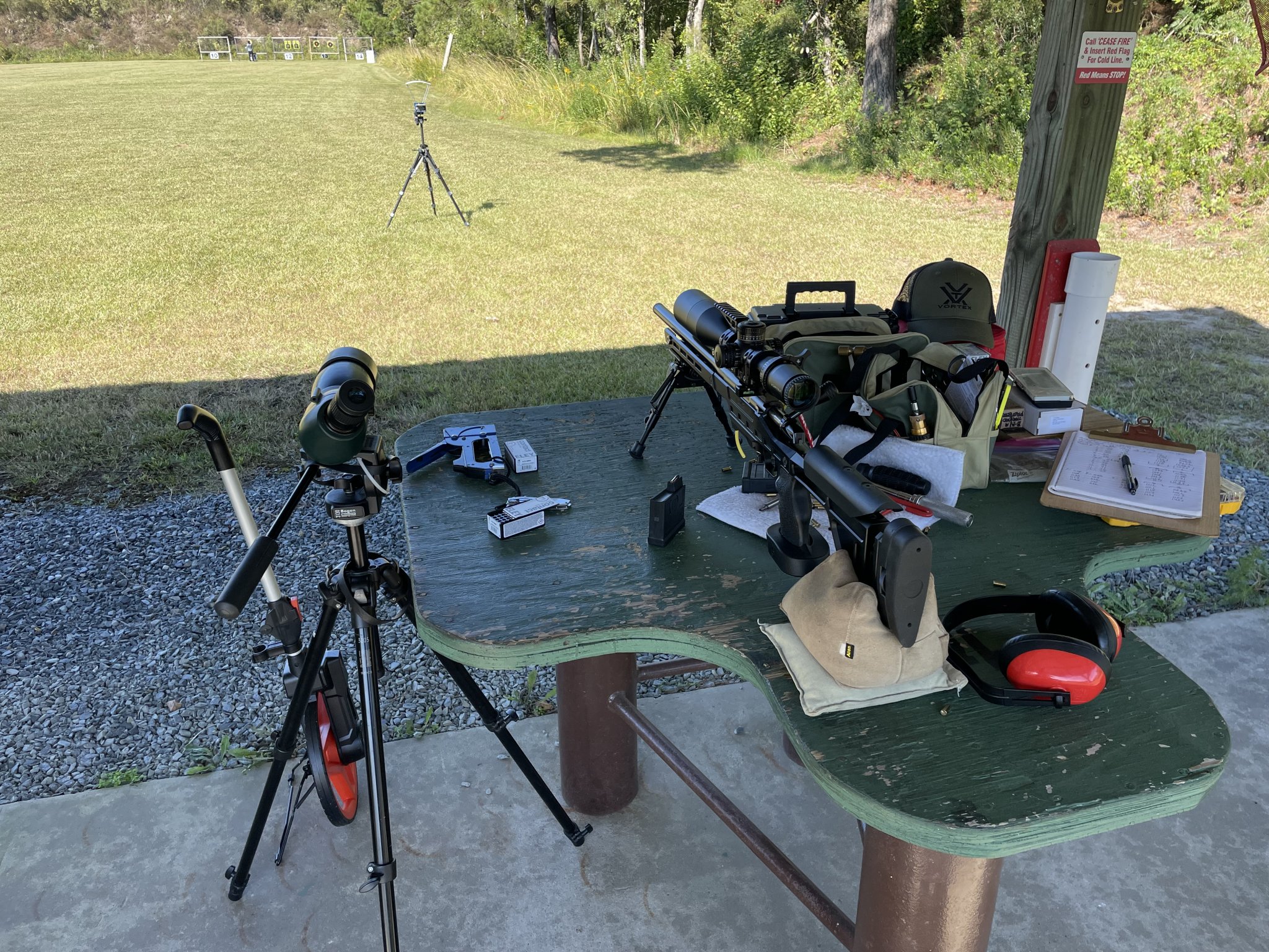

Spent a bit over 5 hours yesterday with the Berg. The goal was to tune the rifle for my new ammo (Eley Contact). The payoff is that with 3 different loads (CCI SV, Geco Bolt Rifle, the Eley) the rifle groups best with action screws at a specific torque setting. I initially used the “Hopewell Method of Barrel Tuning” at 50 meters, but this time I tried 100yds, firing 5 round groups instead of 2 or 3. Results were still the same. Rifle is an early B14-R in BMP chassis, factory trigger, and StrikeEagle on a 40MOA base.
With parts loaded properly during assembly, rifle has been repeatedly disabled for cleaning following dusty, dirty, or rainy matches, and returns to zero.
Afterwards I tested some muzzle devices again, and in every case the rifle groups worse rather than better.
I may make a tuner someday, but don’t expect much. Hopefully this helps someone explore possibilities with their rifle.
