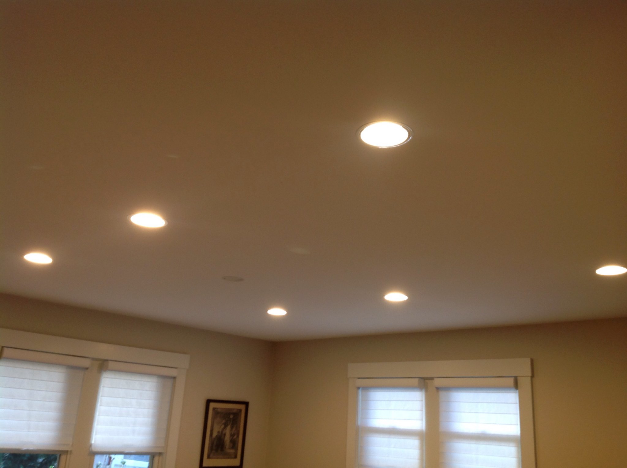

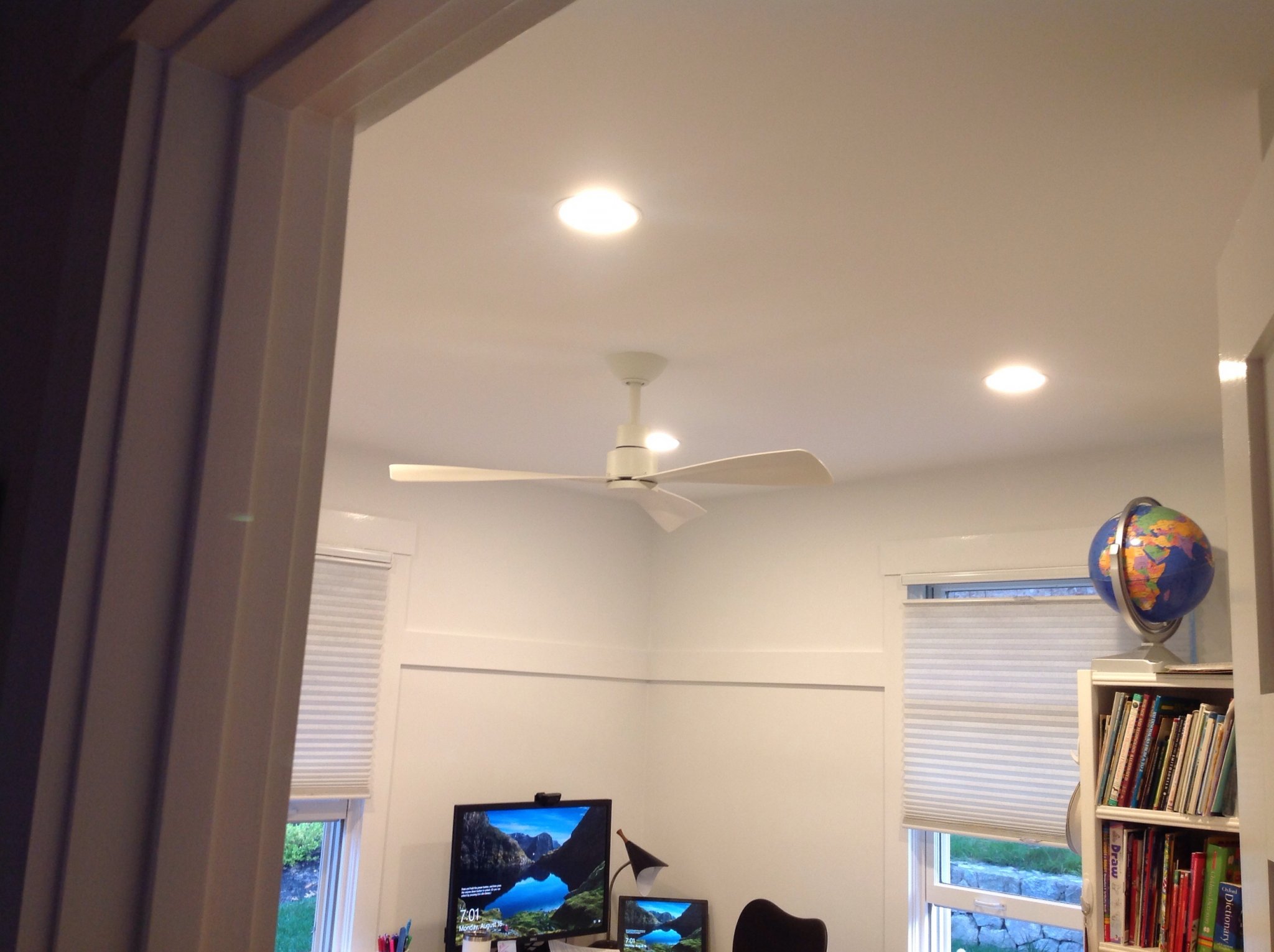

    So easy these days to cut in cans and go recessed.
    My background is only voc tech certificate.
    Good to know I have something to fall back on if asked to violate my oath.
    My wife located an electrician that is masterful at small access cuts to get recessed installed where previously there were none....case in point....
    Little worried what else he is installing in the can while I'm away this guy is that good.
    Reactions: KZP
