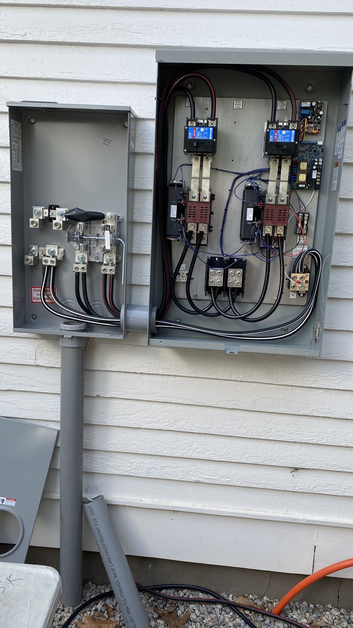

since you're changing the meter this is what I would suggest.
Put in a 400 amp can, then put in a 400 amp transfer switch for a generator, this give you two disconnects rated 200 amps each, then you have a legal disconnect, and a double feed that allows you to service things and looks like this
as far as the panel, code says you have to have a a ground rod system at your garage, and you will need to 4 wire the two panels, depending on the AHJ or your inspector, either way it's a good thing to do for safety. beyond that, type 1 surge protection, and the automatic transfer switch will act as a legal disconnection means and the added bonus is you can run anything off of a generator, just drop a 50 amp inlet out of the bottom and BOOM, bobs, your uncle.
then trench in your 2" pipe to your shed and bring it up into the back of a panel, I would do a 42 space QO panel with a 200 amp main, drive 3 ground rods, or if you haven't poured the concrete yet do a UFER ground system which is the best you can get, just do it properly with a 5/8'ths rebar if you can swing it, makes for a safe and reliable system especially if you do any HF welding.(TIG) then start wiring, I'd use MC and deep junction boxes with #12 stranded wire, except for the compressors, and welders etc, then run #4 THHN or xhhw etc. something 90C rated.
that will serve you for life, and the auto transfer is a symphony, work good last long time.
as for the rest, details, if you don't know, hire someone that does, the stuff I've fixed from do it yourself YouTube educated people is straight up scary, and ranges from no grounds on pools, with overheated wire nuts, to building that fry you every time you turn a light on because who needs ground.(that hurt)
good luck and you can call if you get deep into it. as far as the power company costs, 1200 isn't bad, but for what you get and that overall cost, this setup is peanuts as well

We have our 2 200a disconnects at the meter that are secured, then the rest of the panels and the generator panel and transfer switch are inside buildings. All the loads that need to be powered from the generator are in there own separate panel

I might have one put outside anyways before long as I want to have a generator hookup for the house and would like the extra crazy type of lockout where you have one input side from the generator, one from the utility and then your house load can connect to only one of those two with a nice big lever so nobody has to worry about anything.
Fire fighters are not going to pull a meter or wait for the linemen. They should be able to show up and kill power while they start putting your house out.
Safety is all about what if, not normal.
@Kinetic Moose is right, of course. If the panel is back to back from the meter base, then the main breaker is the first means of disconnect. This is also where you have the green bonding bolt in the panel to bond neutral to ground for a proper ground fault current path.
When we have changed a disconnect to a feed through, we turn off both disconnects, then remove the meter. Do our thing. Most times, it is not requiring a meter move or service ampacity change. We only have to tell Oncor if we accidentally damaged the little wire seal they use to have.
Edited to add: the only time I have seen needing to move the electrical main panel to outside is if the original was in a closet (legal at one time,) and now the new work can't be done because of inaccessibility.
