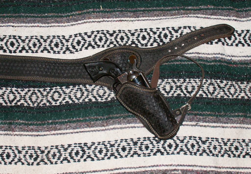

    I used to play fast draw games, and my Colt has a 6oz trigger.
